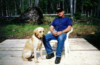

Guess you want to end up with something like this huh?
See attachment above.
