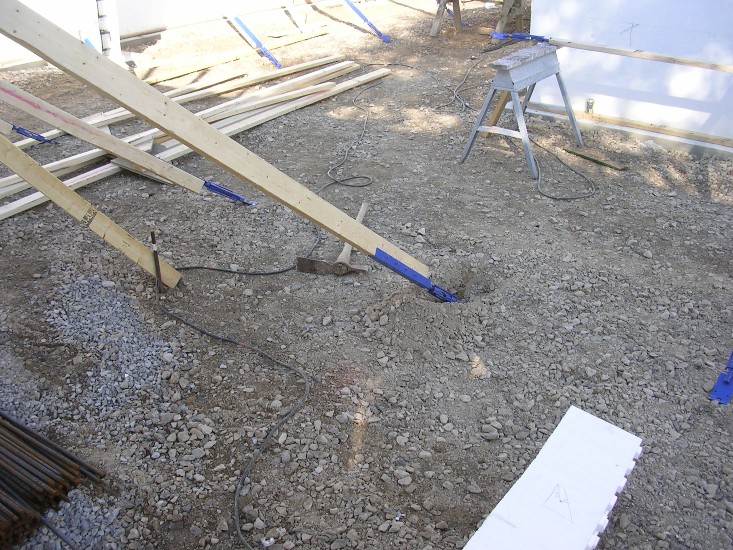

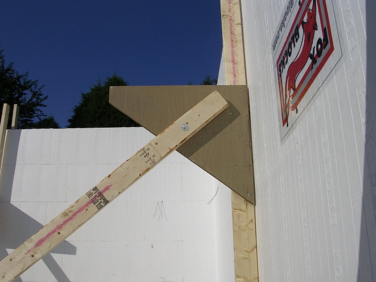

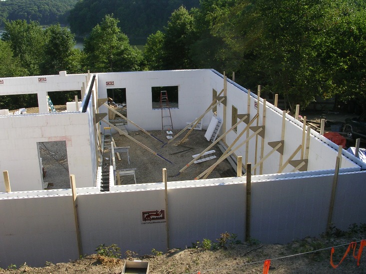

Here are the bracing going in. I found a website that sells adjustable feet that you add to your 2x4/plywood braces. We are bracing ever 6' pluss two ft from the corners. The plywood triangles are for setting the walk planks
Patrick T.
