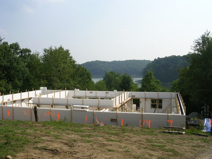

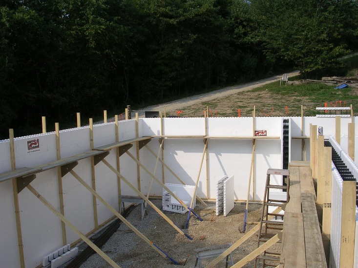

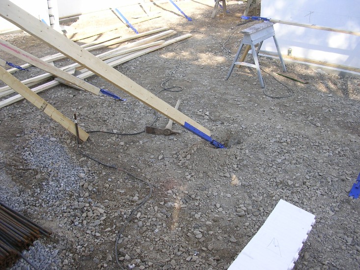

I'm back. It's been so hot here in S. Indiana we are not pushing the guys to work any long than they feel like it. So things might slow down a bit until it cools off. Not an issue though because before the big pour many details must be figured out. Since we are using a steel and concrete composite system, there will be several pockets for beams located at the top of the walls. The bracing is up but in the last few days the walkboards went up as well. The walkboards were used for the formed footers, 2x10s. This will allow for an easy walk around the parimeter as the walls are filled via the pumper. The last photo is a shot of the adjustable bracing foot. This allows for fine plumb adjustment via a turnbuckle.
Patrick T.

   / Concrete ICF home continues #38
Pat,
That looks like a pretty big footprint...bigger than I thought. How many square feet did you say your place is going to be?
#40
3RRL,
The basement is 54 x 69'. I did not need such a big basement but due to the slope, I would have had to have a partial basement and crawl. With all the weight of a 3 story concrete home, I wanted a monolithic box so to say for the foundation. The next level up will be set in for some patio space. The top floor will have a 30x30' opening. In the end the main level will be 3300 sq-ft and the second level will be 2400 sq-ft. So about 5800 sq-ft sitting on a 3700 sq-ft walk out. Half the walk out basement is for my work shop tractor parking.
It is on the big side. We have justified the size due to the lake setting. As our kids have all moved out and will find themselves all over the country with jobs, we hope to have a 'magnet' to get them to visit. So the intension is to have plenty of private room and fun Summer lake envoirment.
Patrick T.
