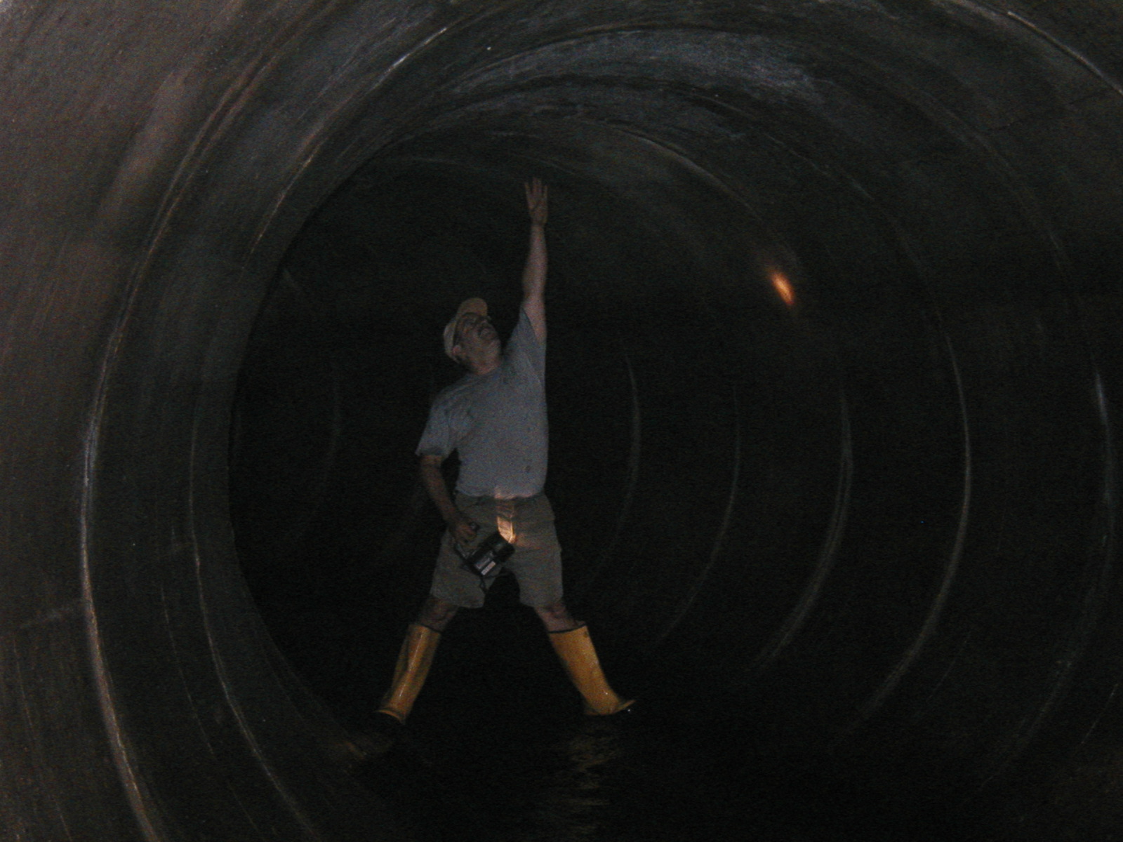

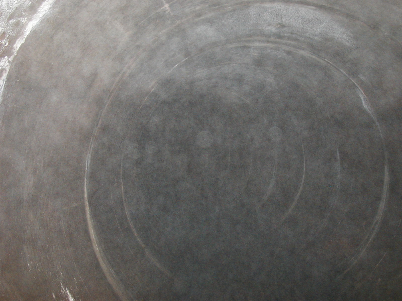

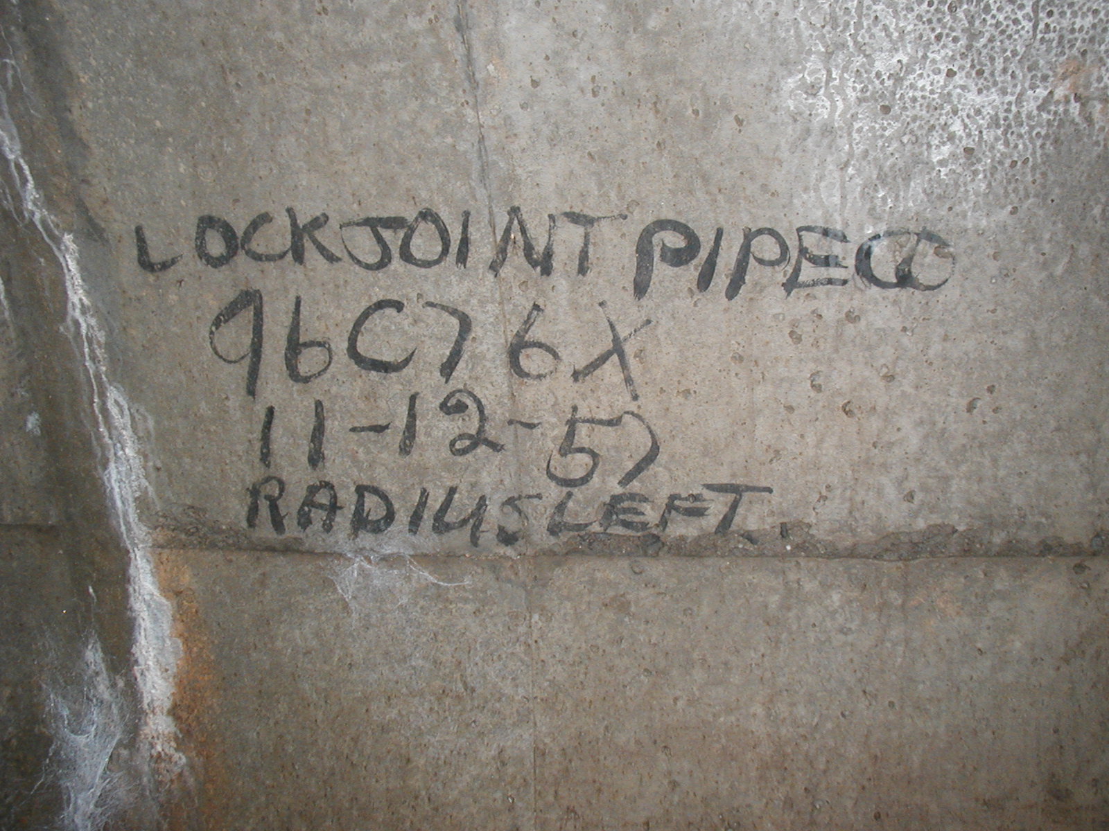

WTF! Not to you Eddie :) I just typed a long response to this and windows decided to run some update without even asking me, and shut down and lost my work.
So anyway wife is screaming to get ready for church, but the short story is I do know a little about the subject and no our main trunk sewer has no pump stations.
Some pics of inside a large storm sewer.
JB.
