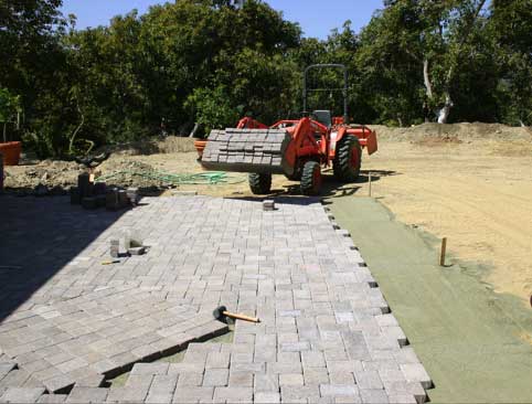

Project is complete. Man did the Boss work me hard. 3 hours Monday night, 5 hours wednesday, 2 friday, 14 saturday (compacter due back at 8am sunday) and 2 hours on sunday.
Pics are in my gallery

Hazmat,
Very nice job, indeed. The pavers look tight and secure with your soldier border, and all looks very level. You will enjoy the fruits of your efforts for a long time.
Congrats on your job well done.

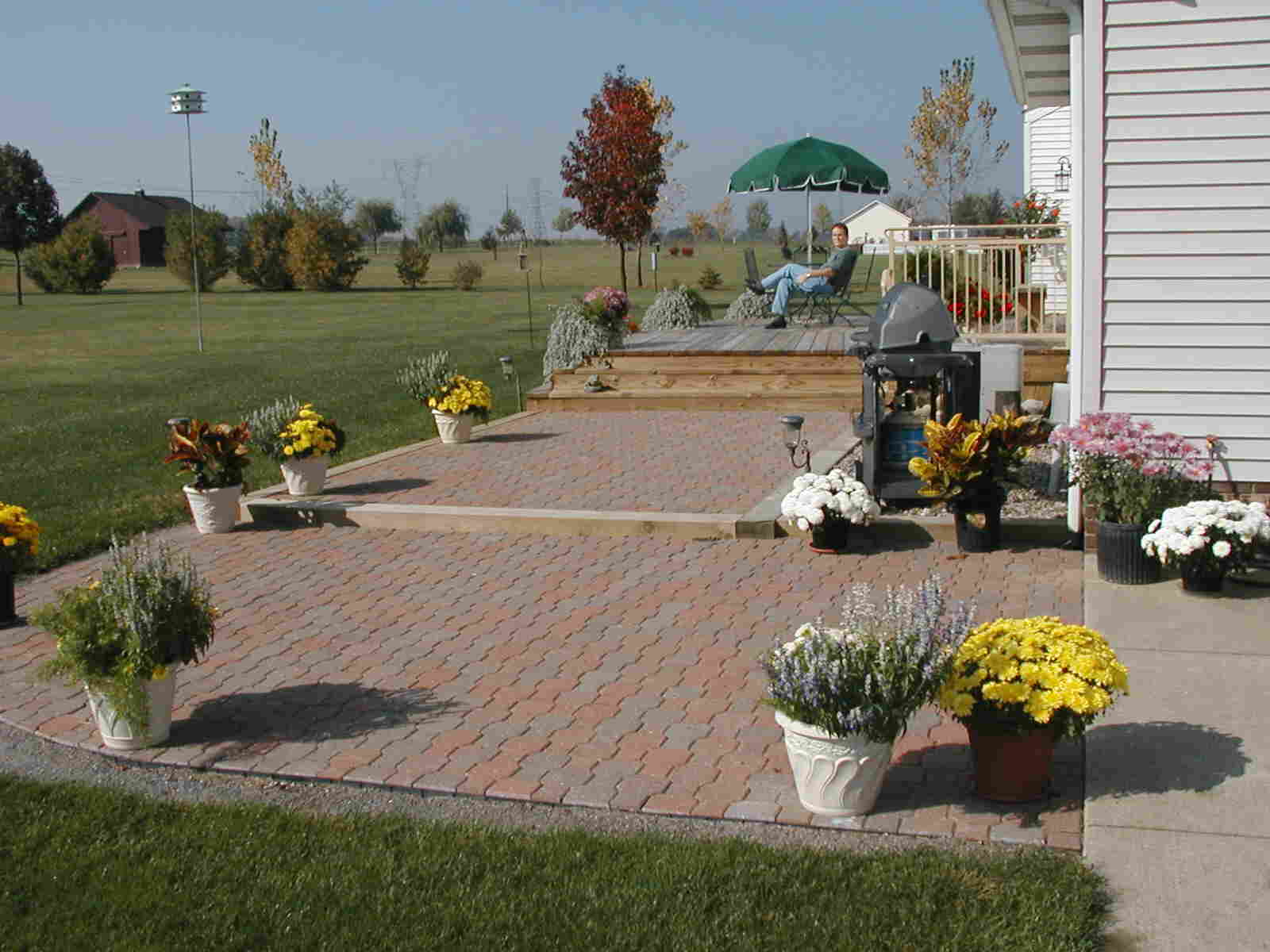

Most definitely hand tamp. I have done nearly 2500 ft. (19 pallets) and am planning another 800 ft. The attached photo is the first of 3 completed patios. I tamped with a 10" tamper from Lowe's.
Sure, at first it was hard at first, but after a couple days it seemed easier. After a week or so, people at the local town started mistaking me for the governor of California. My wimpy body was transformed into that of the terminator... and all because of a little patio project!
Unfortunately, just a couple weeks after I finished the last patio, my body has returned to that of a sofa sloth and I have to use my tractor to haul heavy loads again.
I did rent a vibratory compactor to set the pavers into the sand and plan on renting it again for the 800 ft. project coming up. I really did use the hand tamper, but I don't think I'd do it again. That 10 lbs. quickly feels like 100. If you total up the gloves and linament costs, renting comes up about equal.

Hey that pattern looks familiar /forums/images/graemlins/cool.gif. I rented the machine for the day, but I bet I used it for less than 1 hour total.
