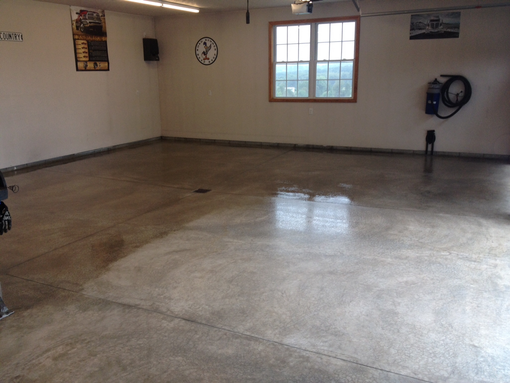

Nice project! As far as sealer goes I had my sidewalks, patio, garage floor all sealed after they were finished and just reapplied the sealer to my garage floor this summer. Think of polyurethane on wood and that is the same basic effect this sealer has on concrete. Water beads up on it instead of soaking in and oil or whatever is easily wiped up without a mark on the floor. Is it needed for your project, that's up to you. Here is a picture of my garage floor partially done this summer, the old sealer was wearing off from a few years of road dirt, salt, etc.

Sealer is applied to fresh concrete to slow the cure. The slower the cure, the stronger the concrete. After that, it protects it as stated above. You can get a small 1 gallon bucket of sealer and spray, brush, or roll it on.
