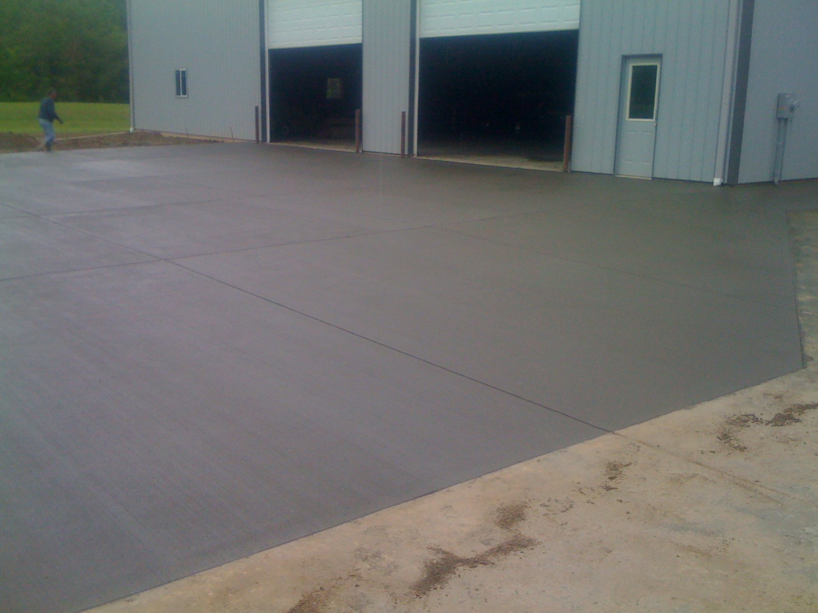

Well, it ended up only being about 95 yards, but it still sure put a dent in my checkbook! The slab is about 75'X65', but there was also a 60' narrow strip I finished between the barns. I really didn't want to have to mow a 3' strip between the barns anyway. :)
I really don't know about this part, so maybe someone can give their input. About 12 hours after the concrete was poured it began raining lightly; not nearly enough to cause any damage, and has been pretty well raining for the last 2 days since the pour. Most old time concrete guys tell me that I'm lucky as all get out because this will greatly help the proper curing process for the slab. It's 5000 psi anyway, but they say that it will cure out far better due to keeping it wet now. I really don't know. What's the theory on keeping a slab wet for days after it initially cures to where the water doesn't hurt the finish? Does it really help?

Nice looking slab. I would have preferred to have the control joints a bit closer together but only time will tell if your's are too far apart.

I'm no expert on the exact distance needed, but my 1/4 mile long driveway is 12' wide and each joint is at 12'. That seemed to give it a nice look with basically squares, except around the turns. The slab pictured also has 12' squares except where it drops down to meet the existing slab. We didn't think it would look right putting one in there and would end up with a couple of rather small sections with the angles. The only problem I had with my driveway is on the 'wings' where it flared out at the main road. I poured them 12" thick but I still got had. A church with a gravel drive to one side of me has a member who runs a trash truck service and constantly drops loads off and picks them up in an area behind the church. When my driveway was only about 2 weeks old he cut the corner off and crossed the 'wing' on one side of my driveway with loaded tri-axles. That caused that wing to crack immediately all the way back to where I have brick columns and walls at the entrance of my driveway. However, I've not had any further change since then. In other words, it hasn't moved any nor has the crack gotten any worse. I'm hoping the rebar in the wing and the heavy gauge wire mat will hold the slab together.
I guess only time will tell on that as well. Otherwise, it's just been a back breaking ordeal for me to crawl around on my hands and knees filling each joint with caulk to prevent any water from getting under the slabs. I ended up buying an electric caulk gun and have gone through case after case of the caulk and still am not finished! But, I'm told that it's really important in an outside area to keep water from seeping into cracks in the control joints. It makes sense, but it also gives me headaches standing on my head for hours at a time. :(

I understand your desire for an aesthetically proportioned result but concrete tends to shrink while it is curing and typically (but of course not totally predictably) tends to crack every so many feet depending on several factors including but not limited to thickness, PSI rating, reinforcing steel size and spacing, any admixtures, slump, and on and on. Control joints need to be located at a lesser spacing than the "natural" distance between cracks, WHATEVER THAT IS.
I assume you are using an elastomeric caulk intended for caulking exterior concrete with foam plastic backers forced into the space before caulking. It is a PITA to have to do a lot of that stand on your head work (and in your case, unfortunately, a pain in the brain as well.) Have you ever seen the knee pad scooter thingy? It has padded recesses for your knees and is on caster wheels. There are also mechanic's seats and gardener's seats on wheels that might make that work (and other jobs too) less of a pain.
You are doing the right thing. Sealing all potential water entry locations will certainly add to the life of your flat work. Freezing water can sure ruin a lot of $ invested in concrete.
