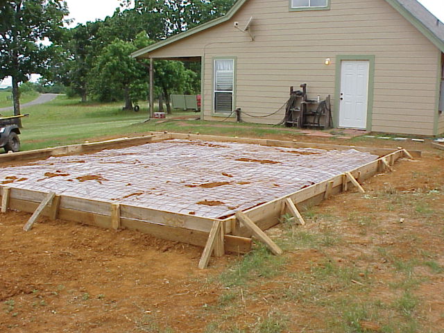

I am having a 30'X50' building built in Lampasas right now. Slab will be poured on Monday. It DOES have a vapor barrier and all three contracters who submitted bids said they always install one.
BTW, concrete is porous and water will leach through it like a sponge. It wont pour out but significant amounts of water vapor will come through (unless its against standing water in which case you cab sometime see water drip through). That is why Thompsons and others make concrete sealers for basement applications. Check out those old concrete cisterns you see around the hill country. You can see the water stain.
