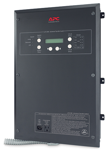

This is the APC automatic transfer switch we're using with our 5kw portable Honda generator. It has load management, etc., which wasn't too bad to program and as Ralph said, once it's done, it stays programmed. Works great for our needs during the intermittent power outages we have and hands down beats what I used to do, i.e., extension cords. :D
