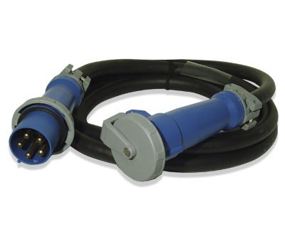

I don't have any attachments yet.
This is the type of cord they were planning on using
Now I need a box for it. 60amp
The problem is, that the cord from the breaker box is going to come out and run down the outside wall.
I'm looking to run it out form the back of the breaker box and directly into the back of a receptacle box.
Hope I have made it clear. I'm not great at explaining electrical stuff.
   / Confused on PTO generator size #76
They make receptacles for those connectors which go on a normal outdoor box and let you run power in whichever direction is convenient.
