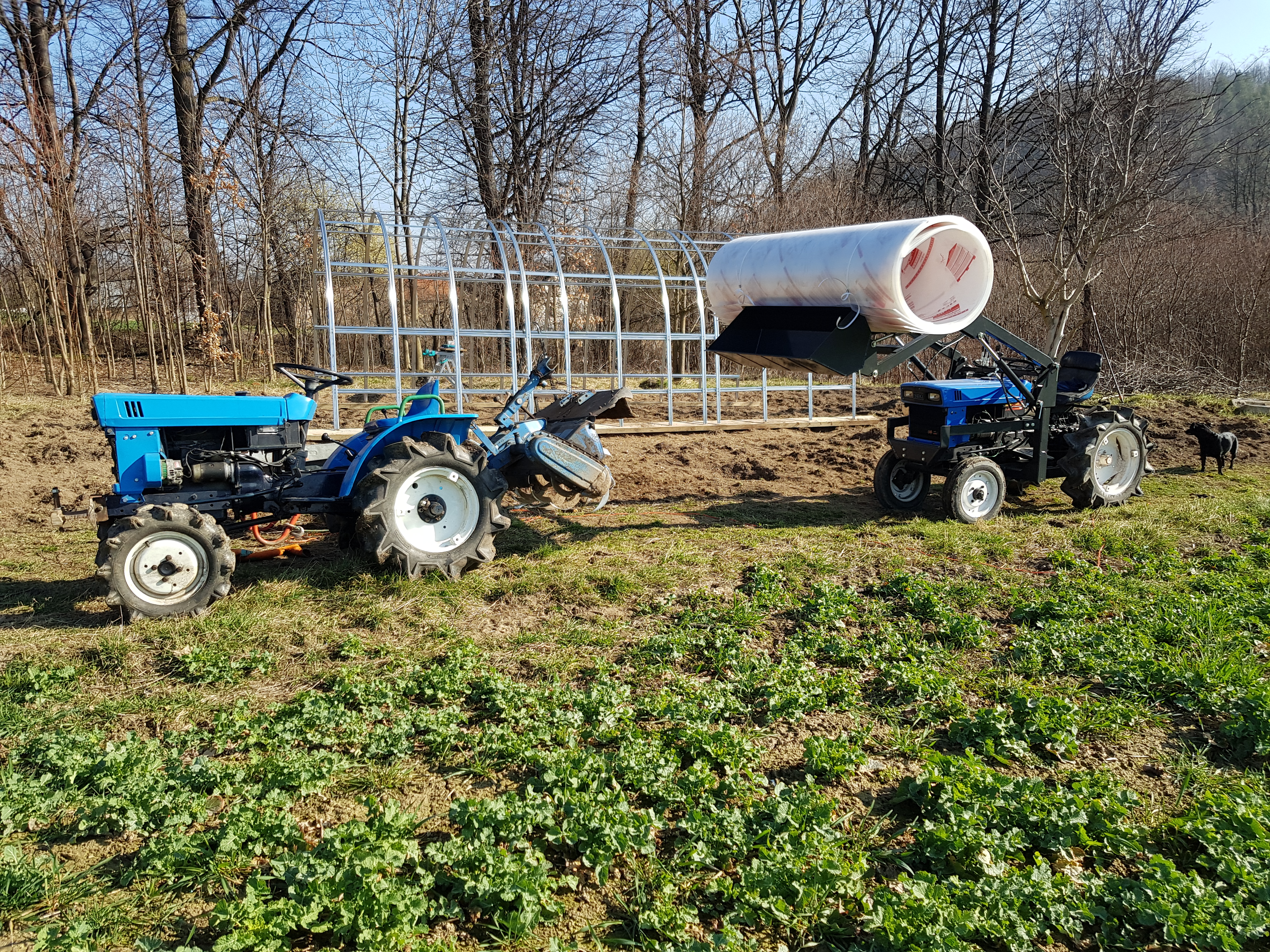

Meanwhile i am working really hard with the 4wd to prepare my land for the growing season, building a greenhouse, plowing (?) the land and preparing it with some implement (glebogryzarka, don't know english name). Really love this iseki. I really have no clue how i managed in the time before i had this little tractor :)

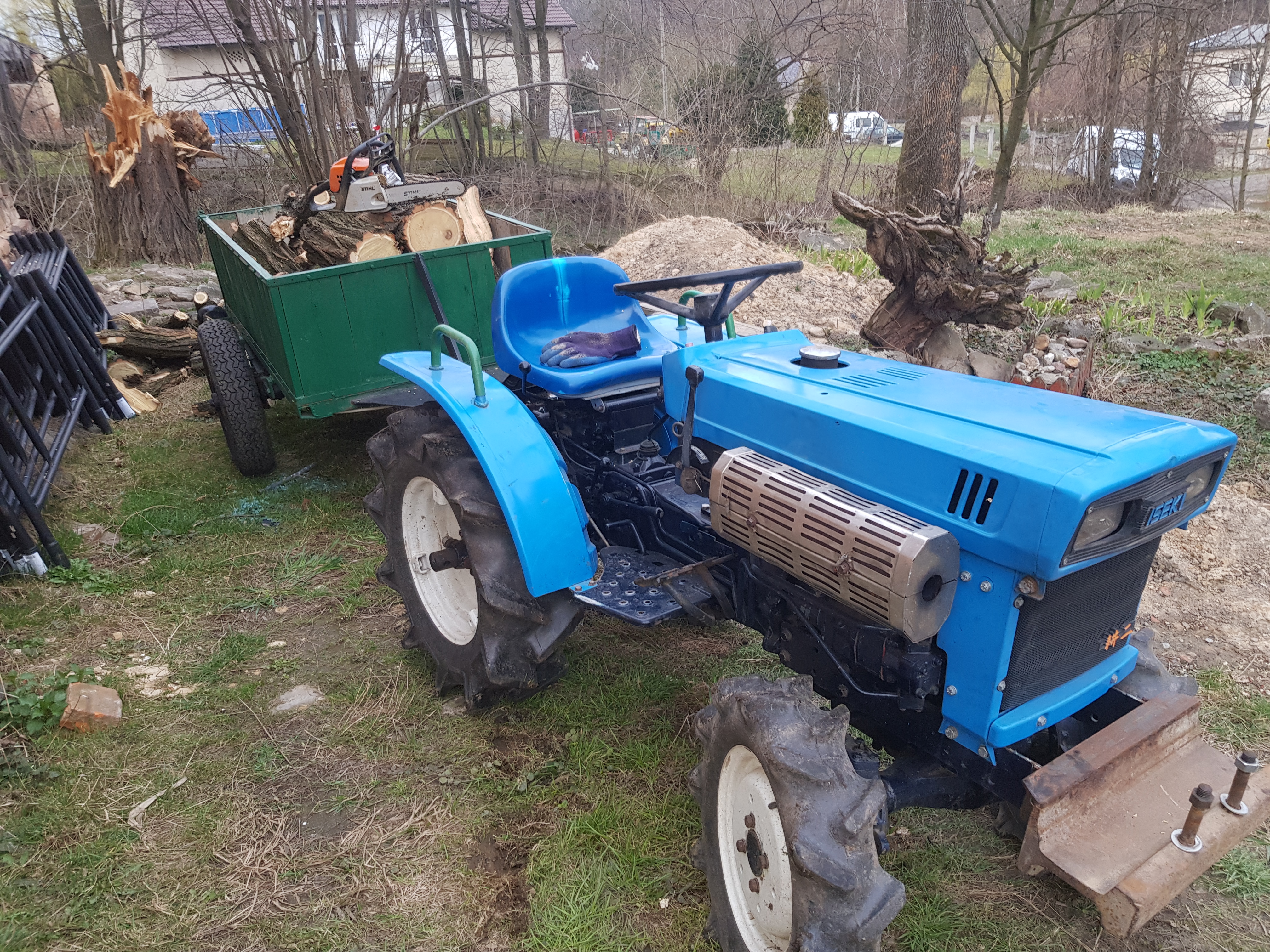

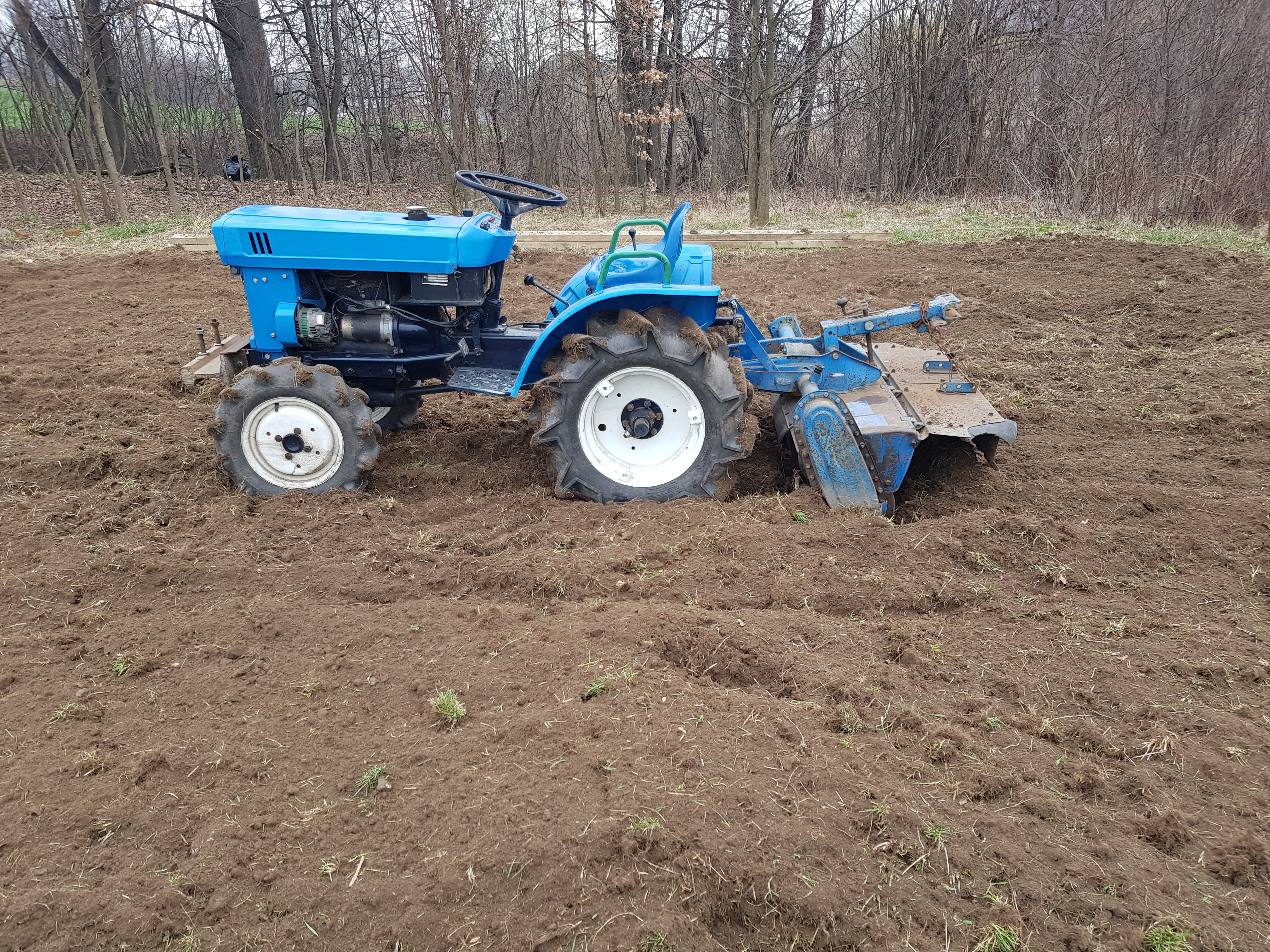

here are some photo's:
The cat enjoying the traktor while i'm building the greenhouse (polish style) in the back

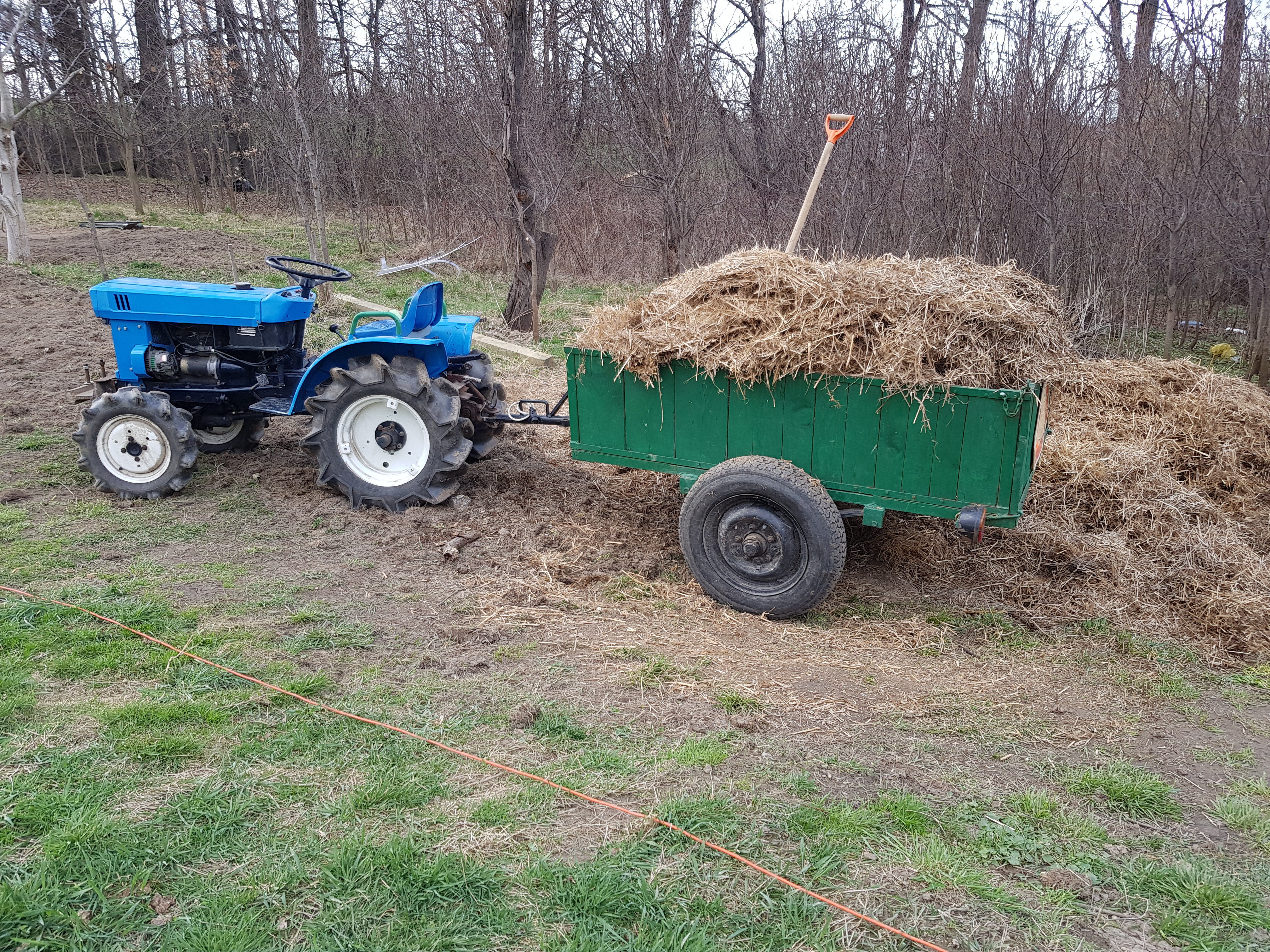

Moving some stuff on the land with the little trailer (?) i acquired. Saves a lot of time and physical work...
Using both my tractors when building the greenhouse.

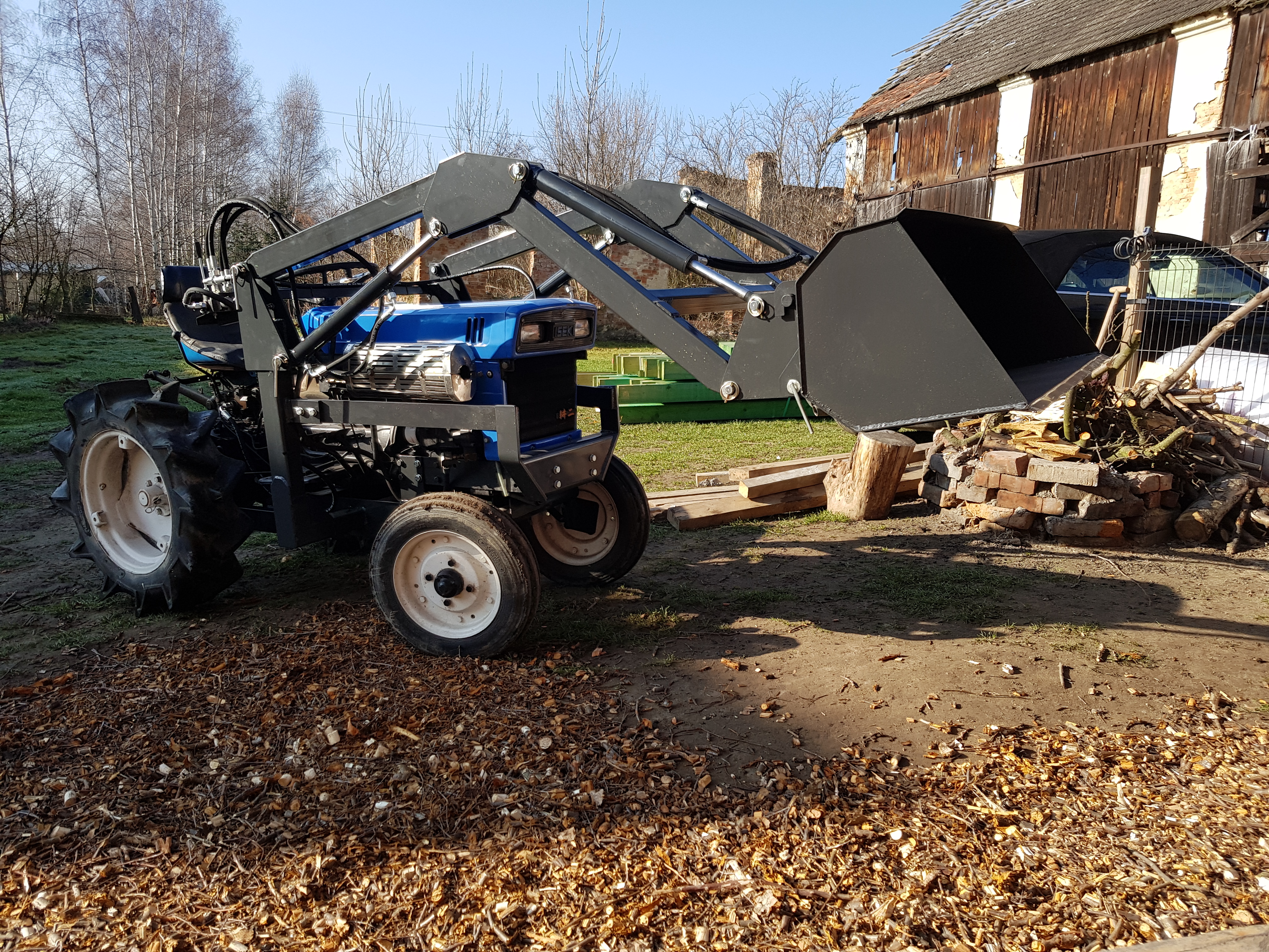

my tx1500 2wd with the FEL connected coming home....

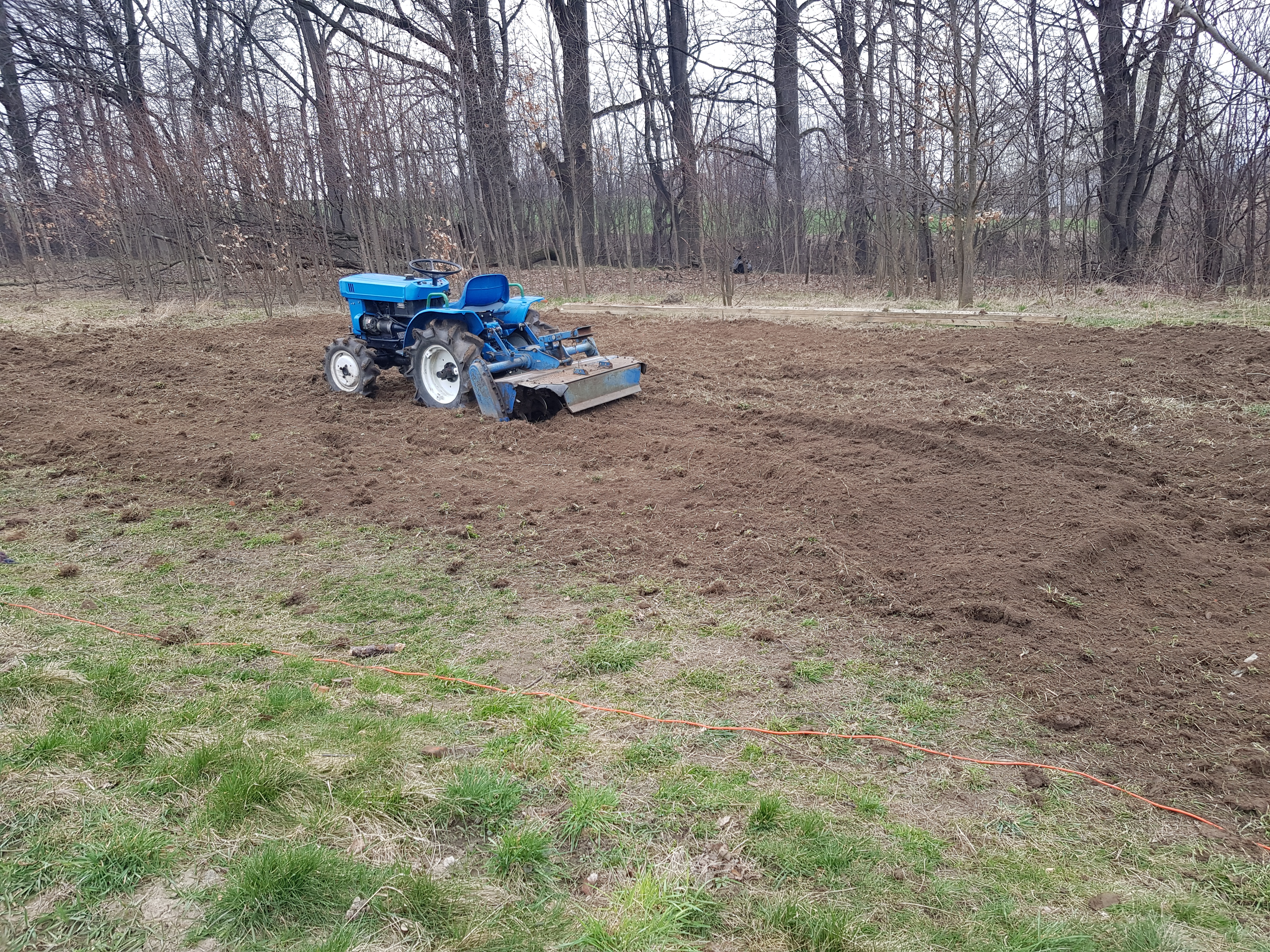

preparing ground around the new greenhouse with the tiller (??)
One of the older trees around my house died during last storm. Using little trailer to move parts after cutting for burning wood...
More tiller (?) on the 1300F.

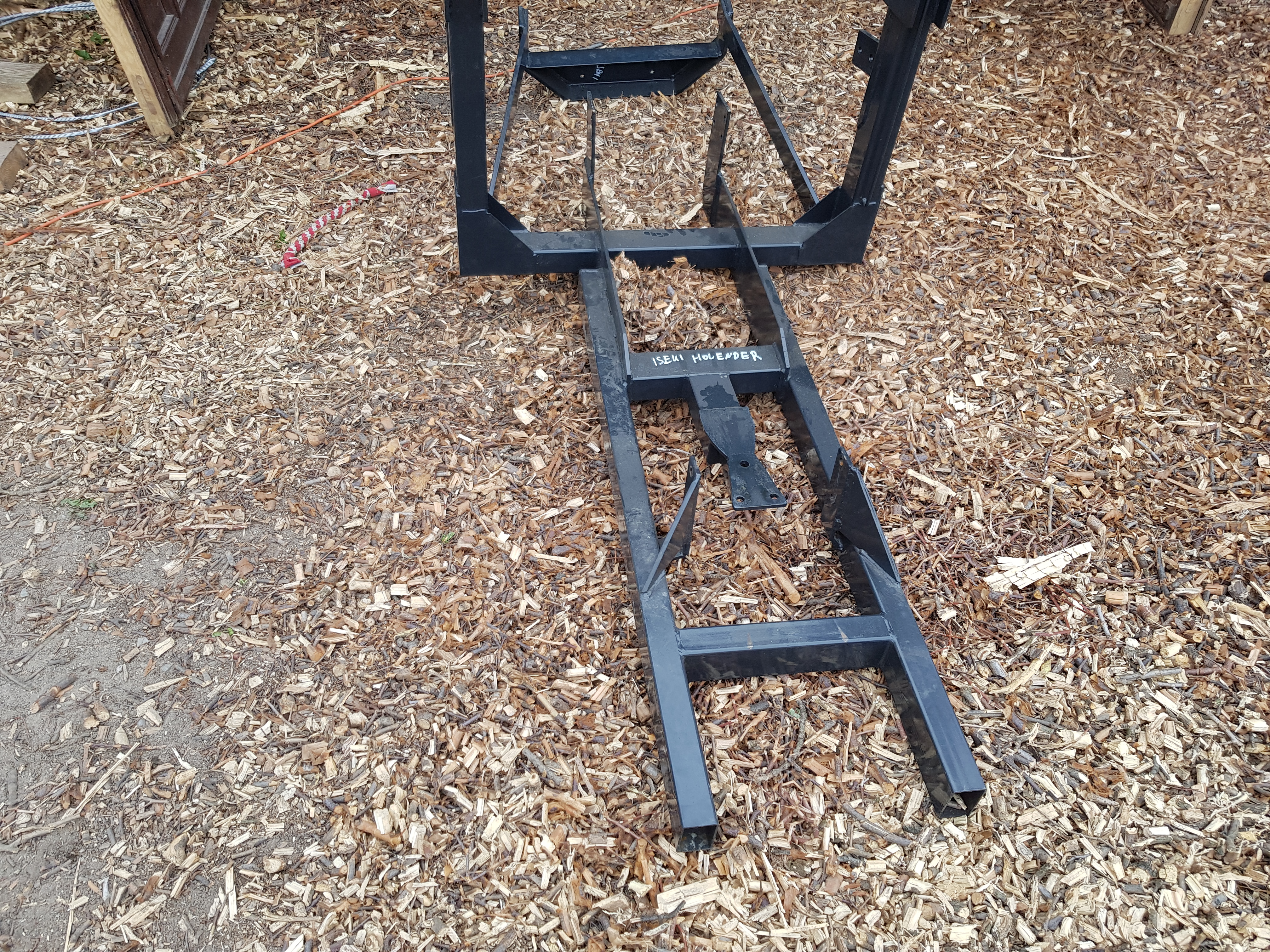

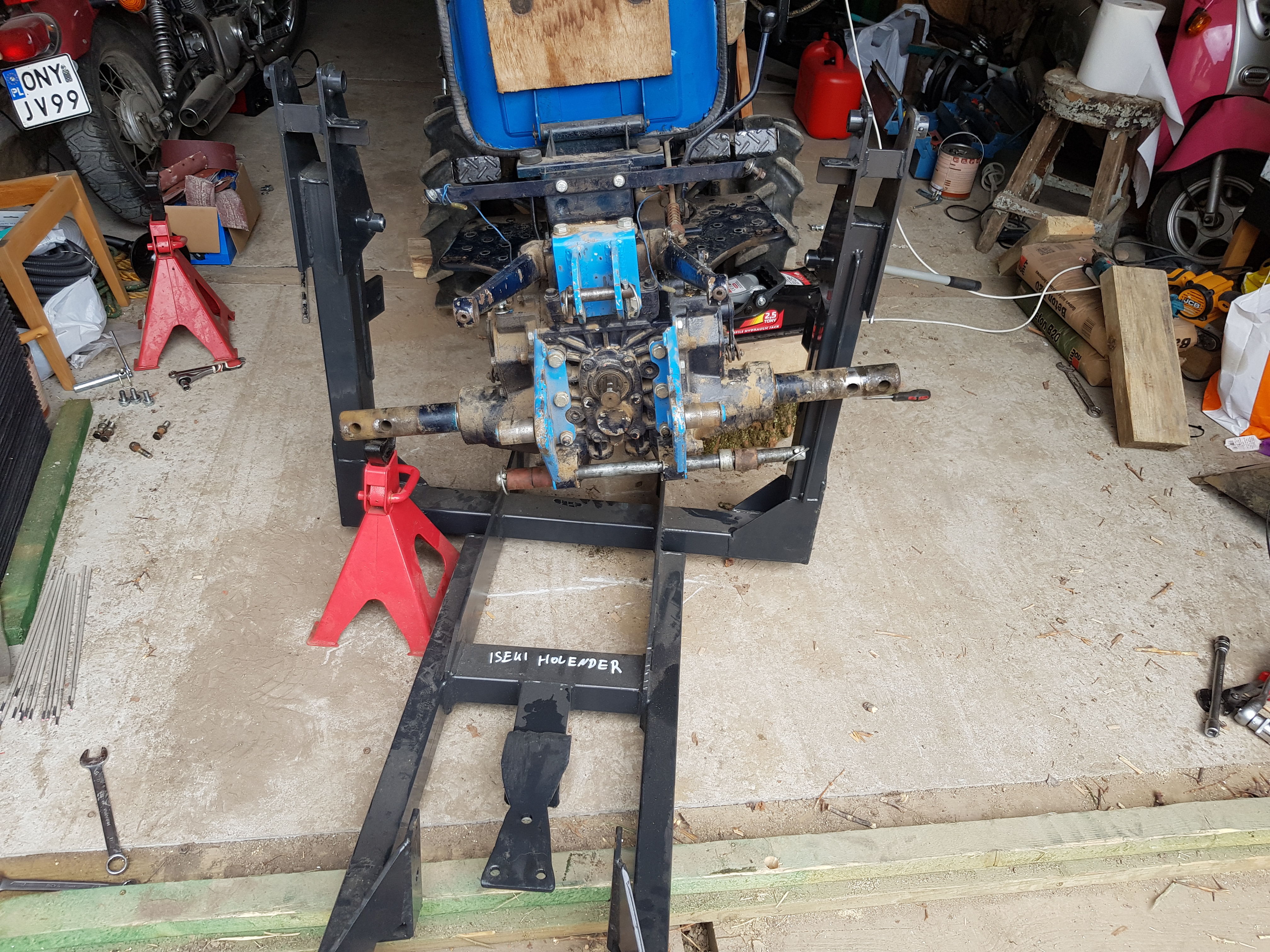

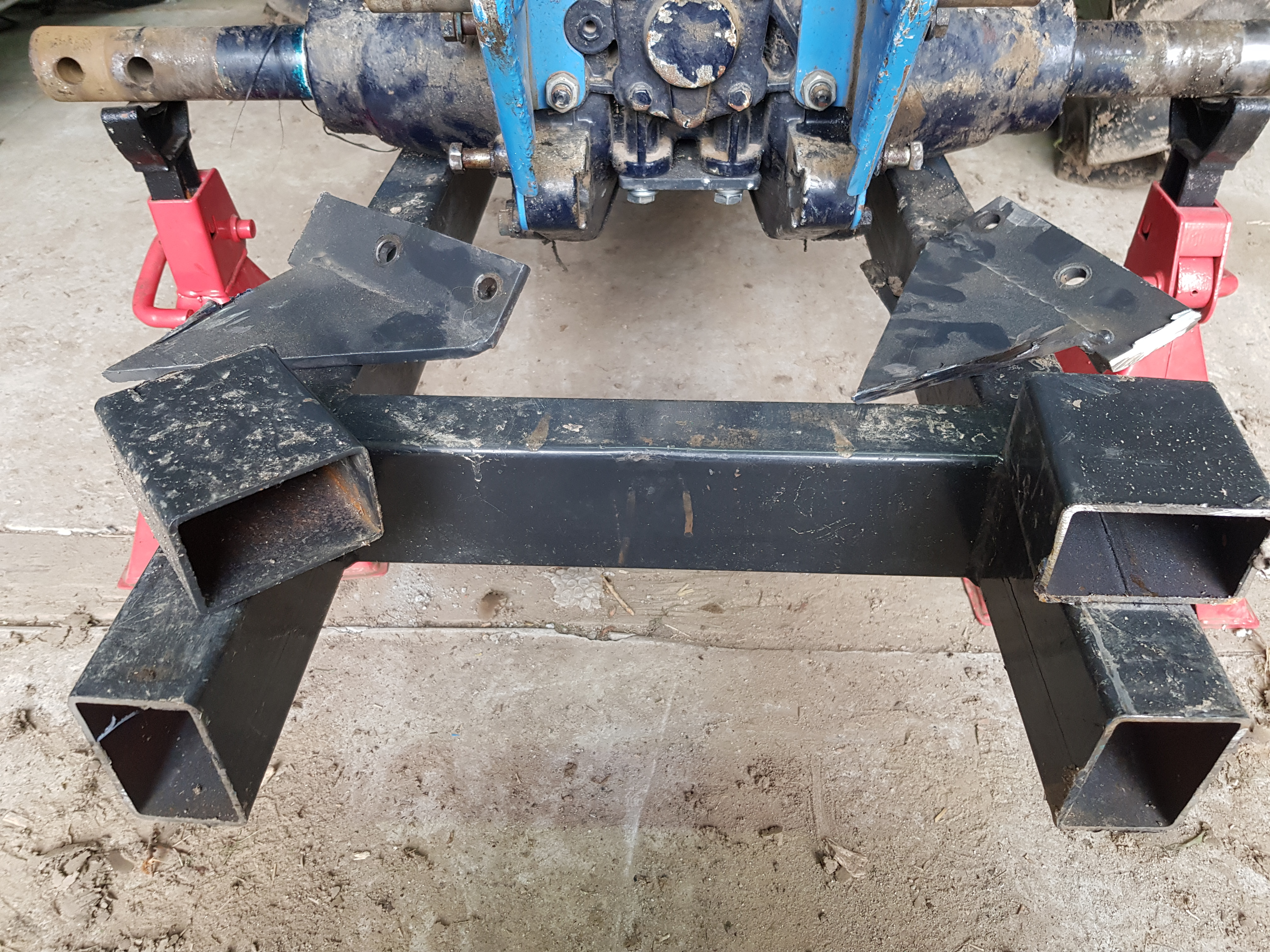

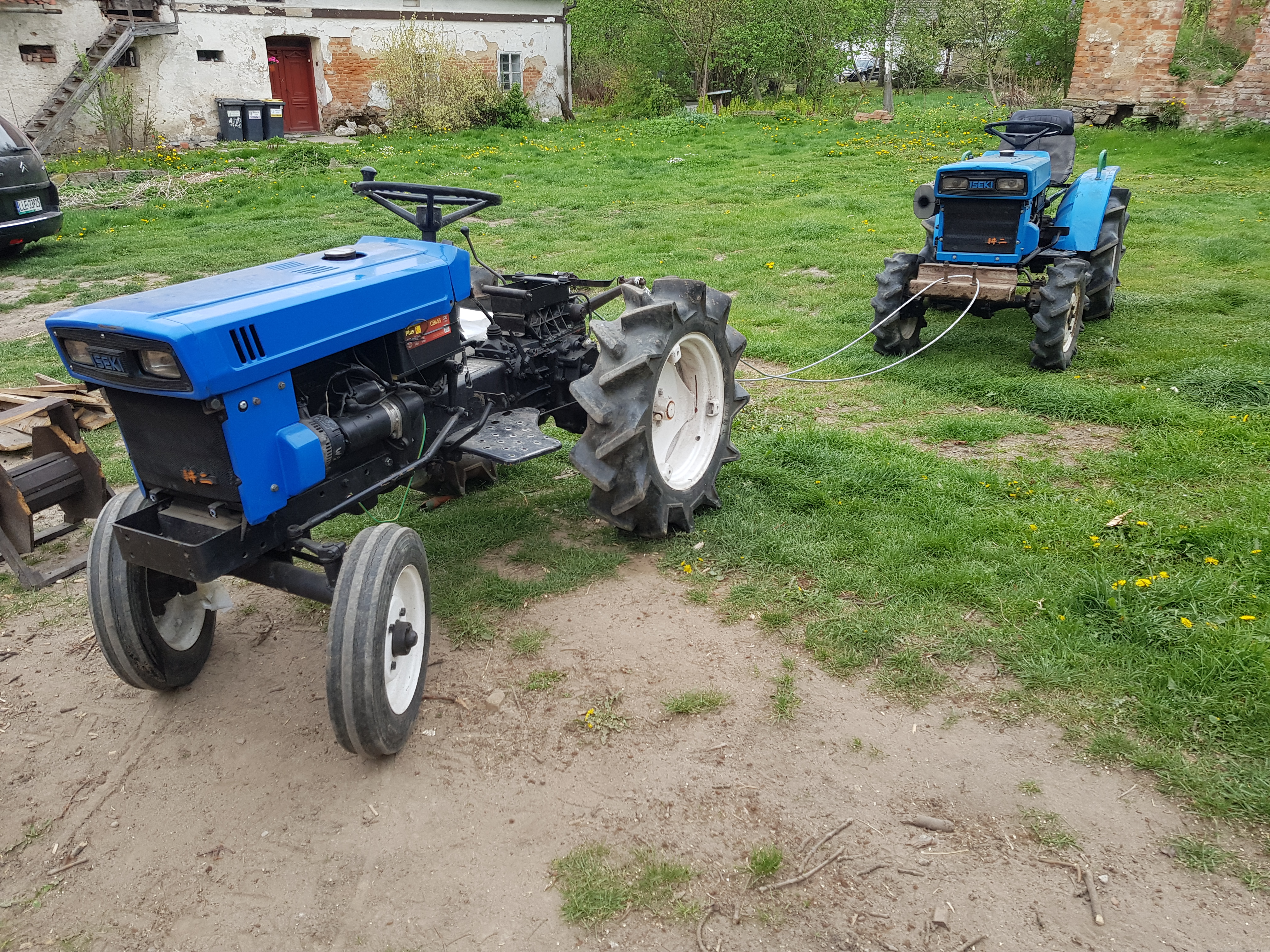

Ok this weekend i started taking the sub-frame (build to connect a FEL to my iseki TX1500) from the tractor, in order to connect it to my TX1300F. In the time that i have it, i already found that this FEL really needs a 4wd to operate it.
The total device looks like this:

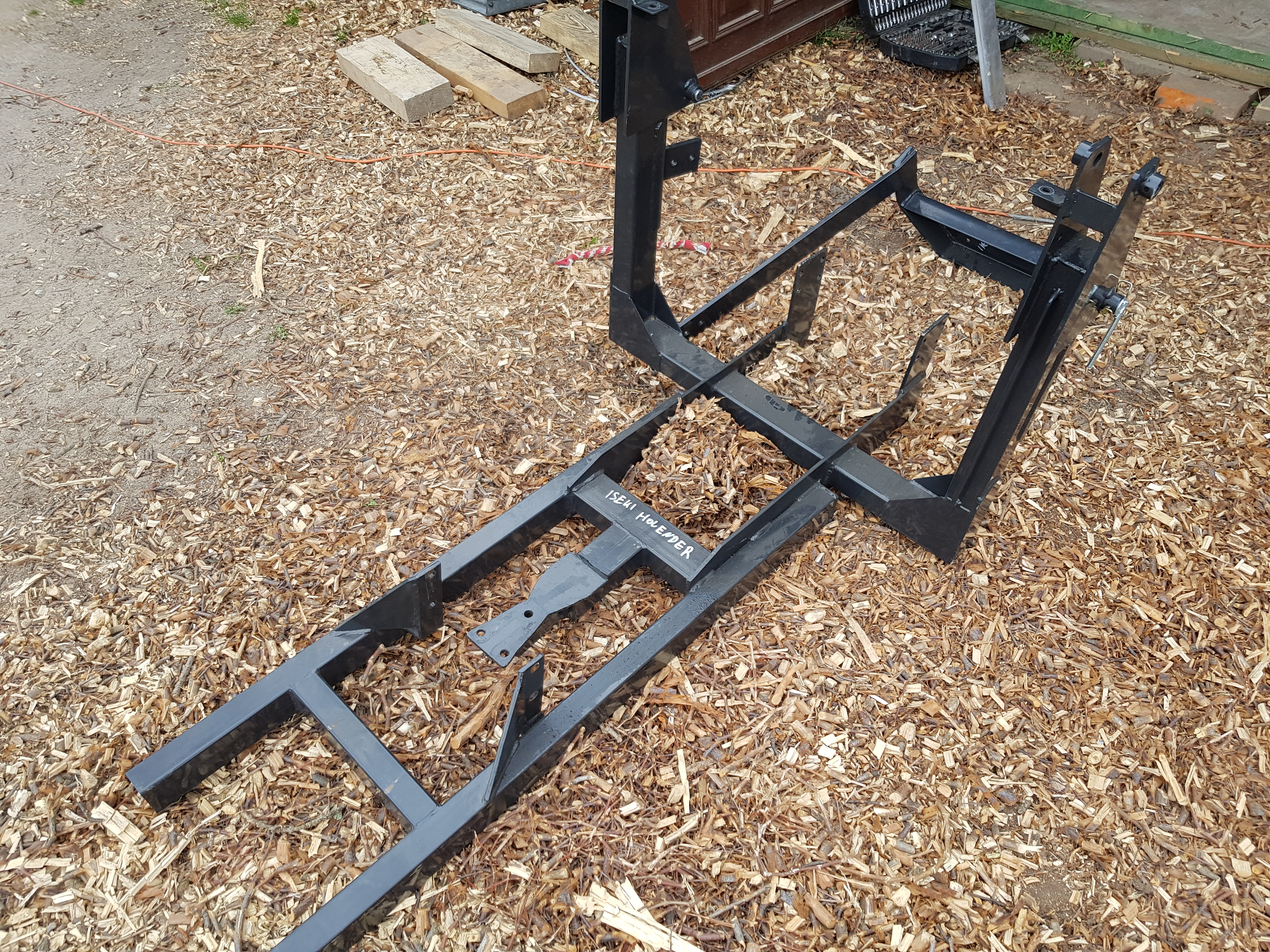

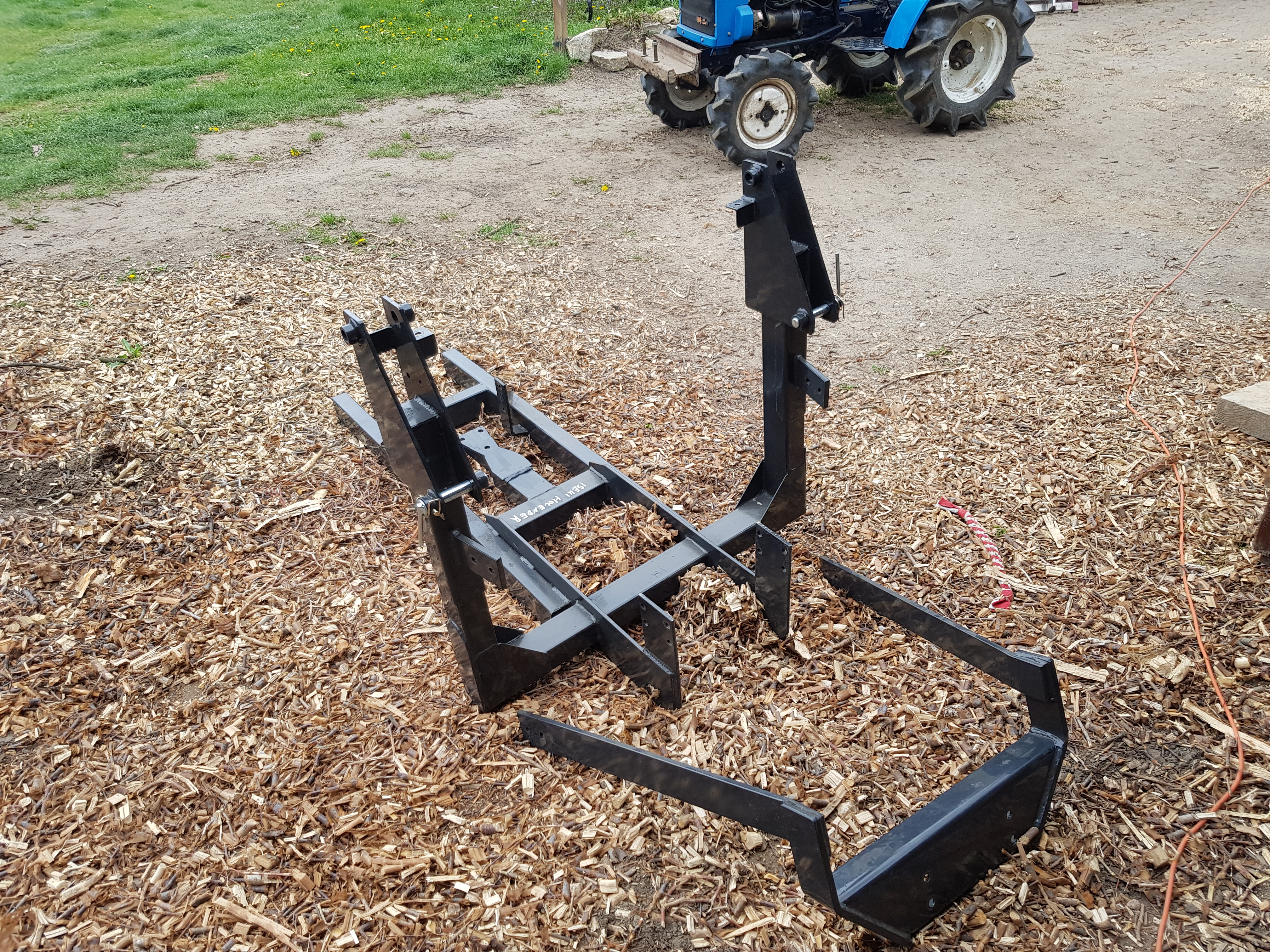

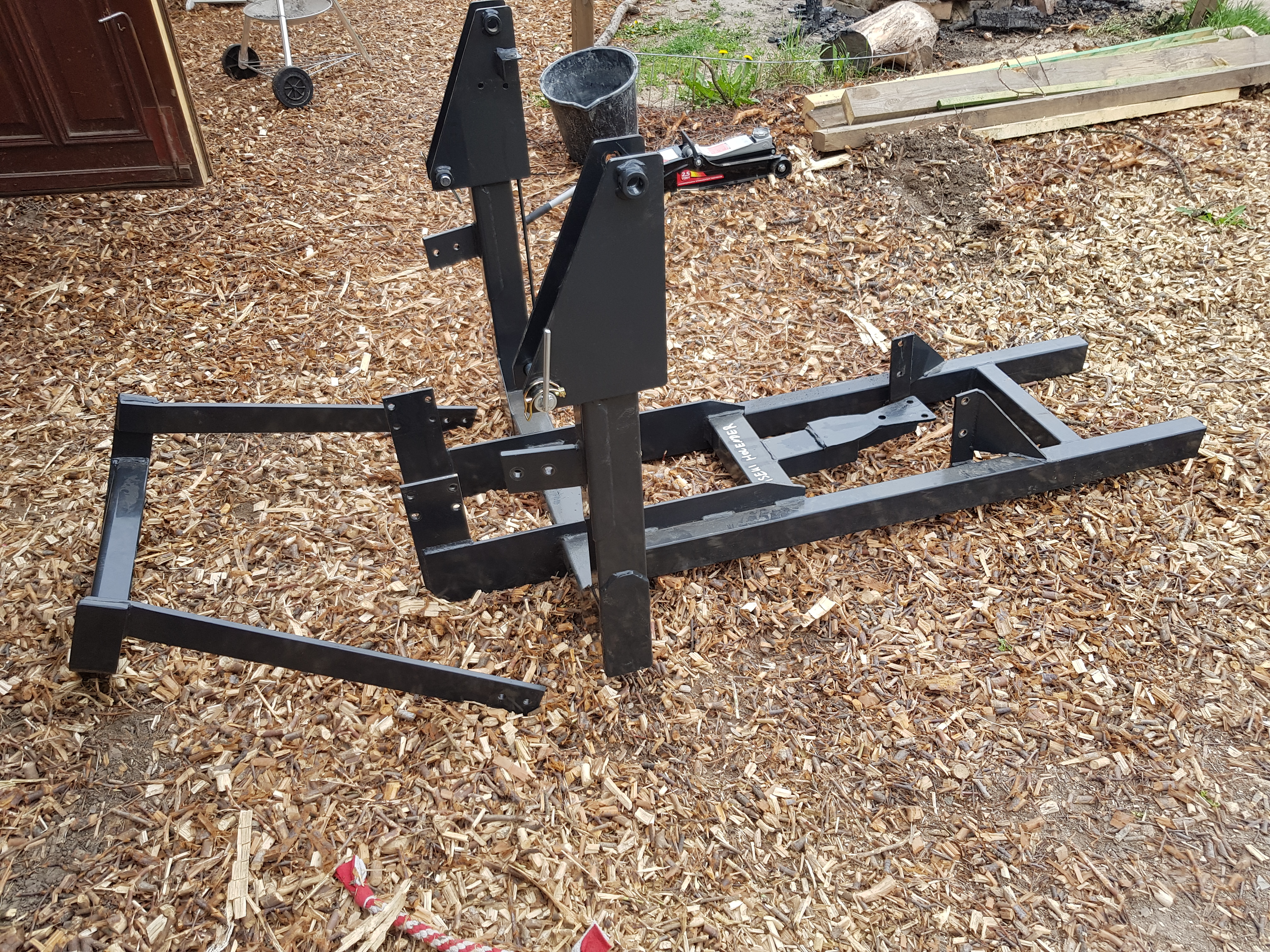

I removed the FEL bij disconnecting the hydraulics and taking the front part off, leaving only the subframe connected to the tractor. Then the subframe came off. This it what the construction looks like:
The guys that made this construction took their job pretty serious, it is a pretty solid construction, with in total 19 connections to the original tractor frame:
- 3 on the rear (middle), connected to the bottom of differential
- 4 on the rear (left and right) connected to the sides at the back of differential
- 4 on both sides of the original frame around the engine
- 4 on the front of tractor to support the vertical arms of the FEL's subframe.

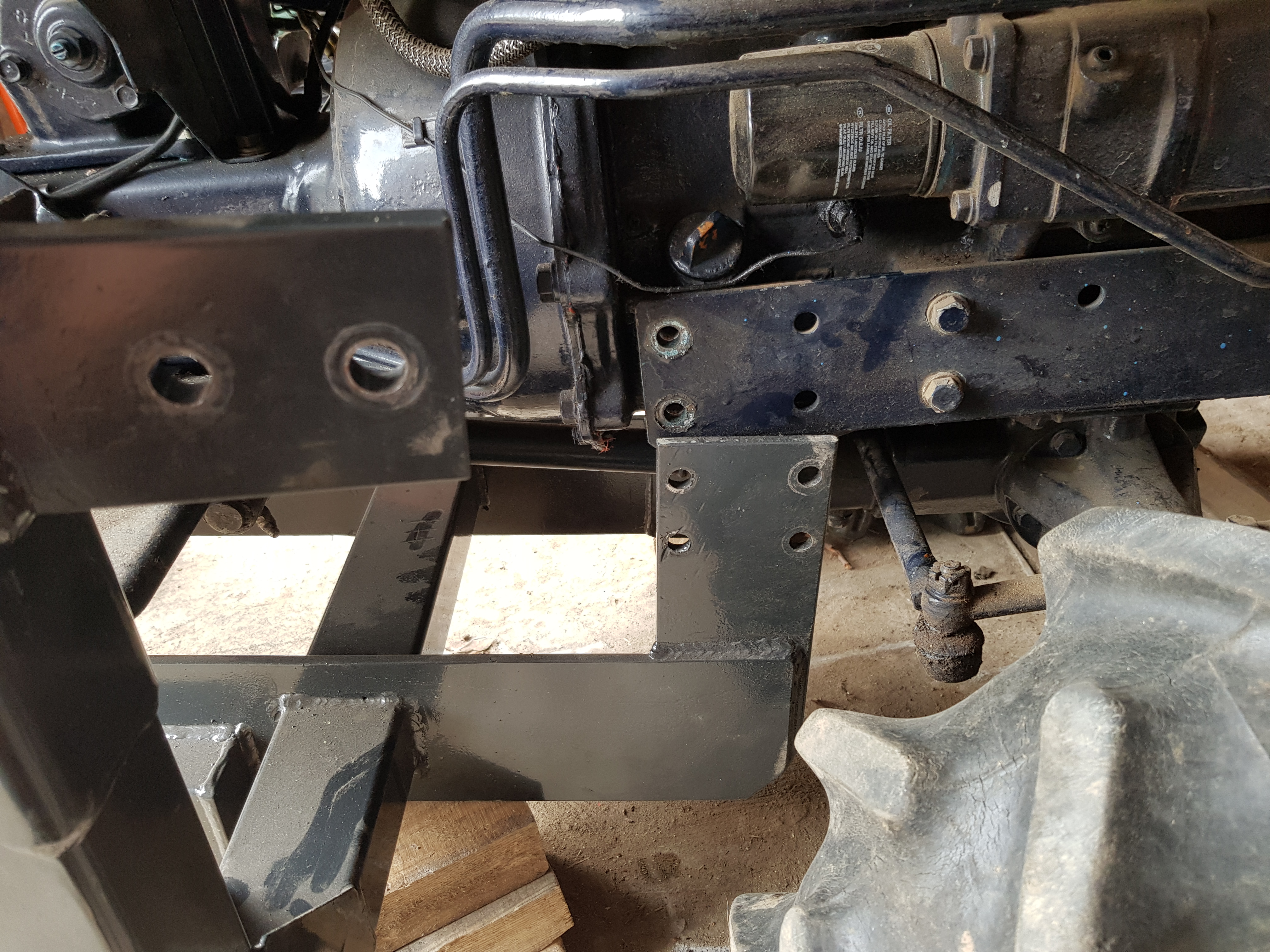

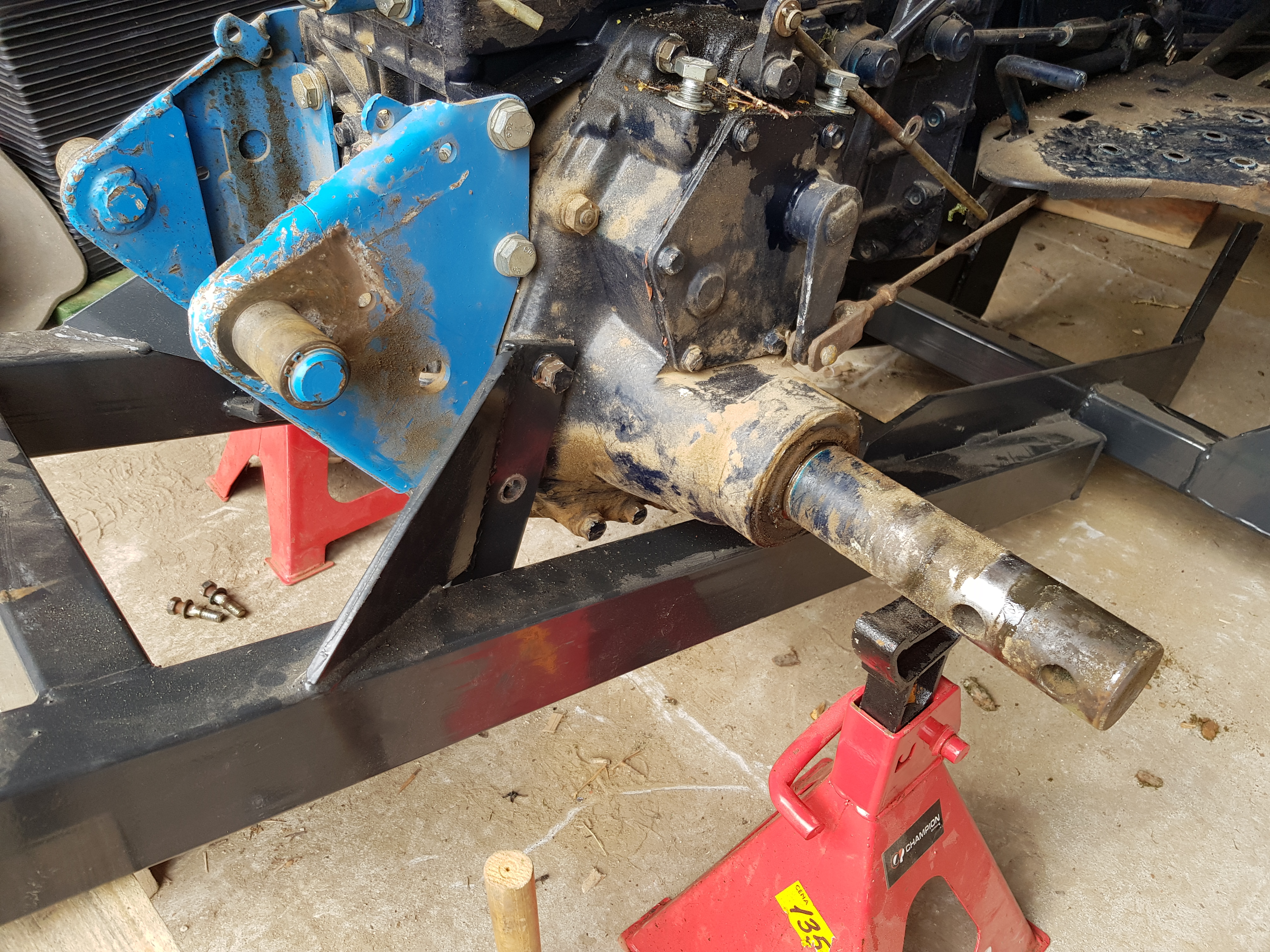

I was really hoping the measures/sizes of the TX1500 are exactly identical as the TX1300F, so i just started trying to connect it to the tx1300F. Because of the vertical arms i had to 'slide' this subframe kind of sideways onder the rear of the tractor to get it under it. So i took the 1500 out of garage using the 1300 (hydraulics of 1500 were disconnected).
I moved the subframe under the tx1300F:
Then i connected the first two bolts to the side of the rear-end of differential:
After this i prepared to connect the frame to the frame on both sides of the engine:
And there is where i ran into trouble. There is about 0,5 cm difference in size between the two tractors. I will have to make a few choices here, not sure what to do yet. To be continued.....

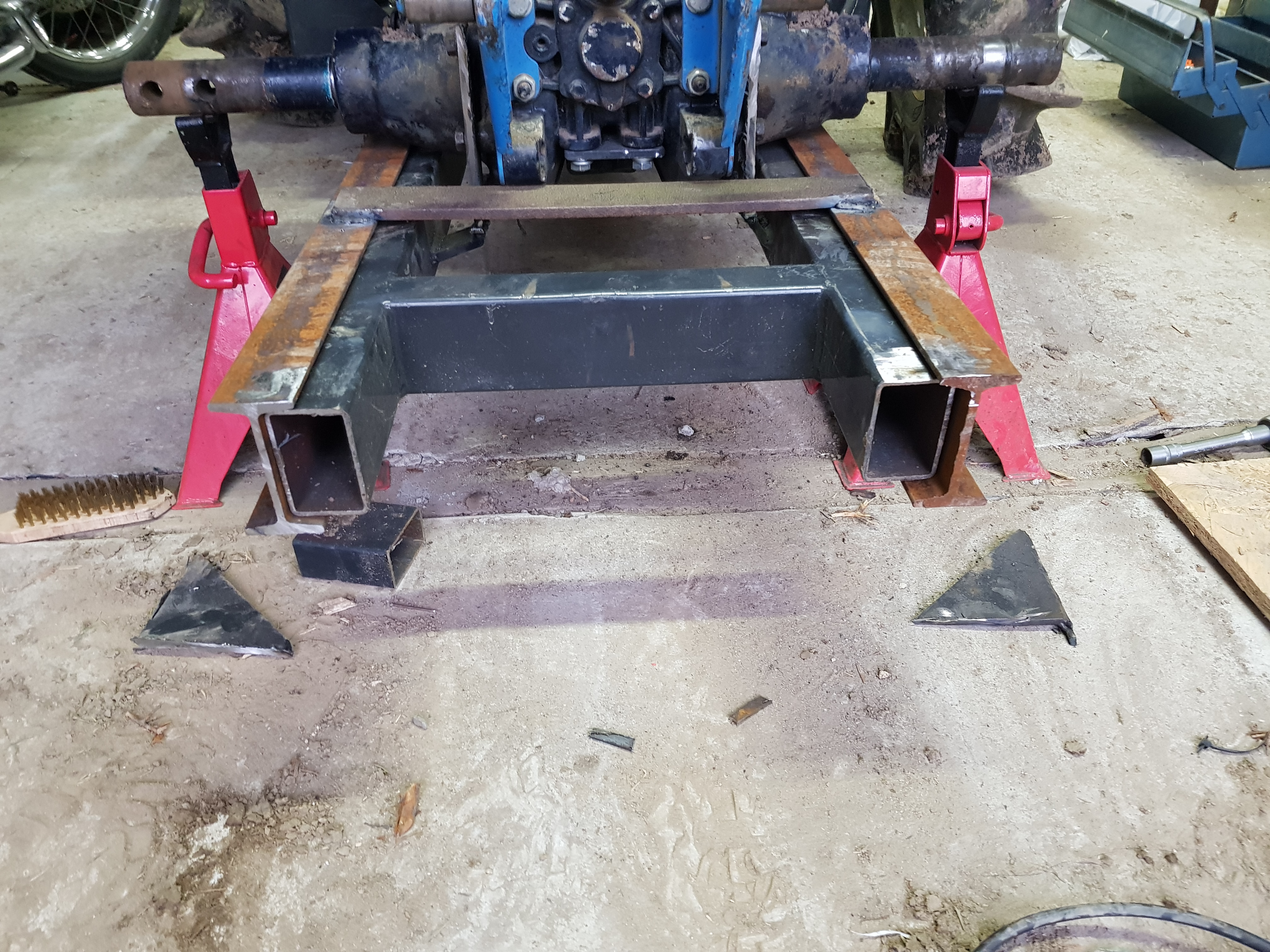

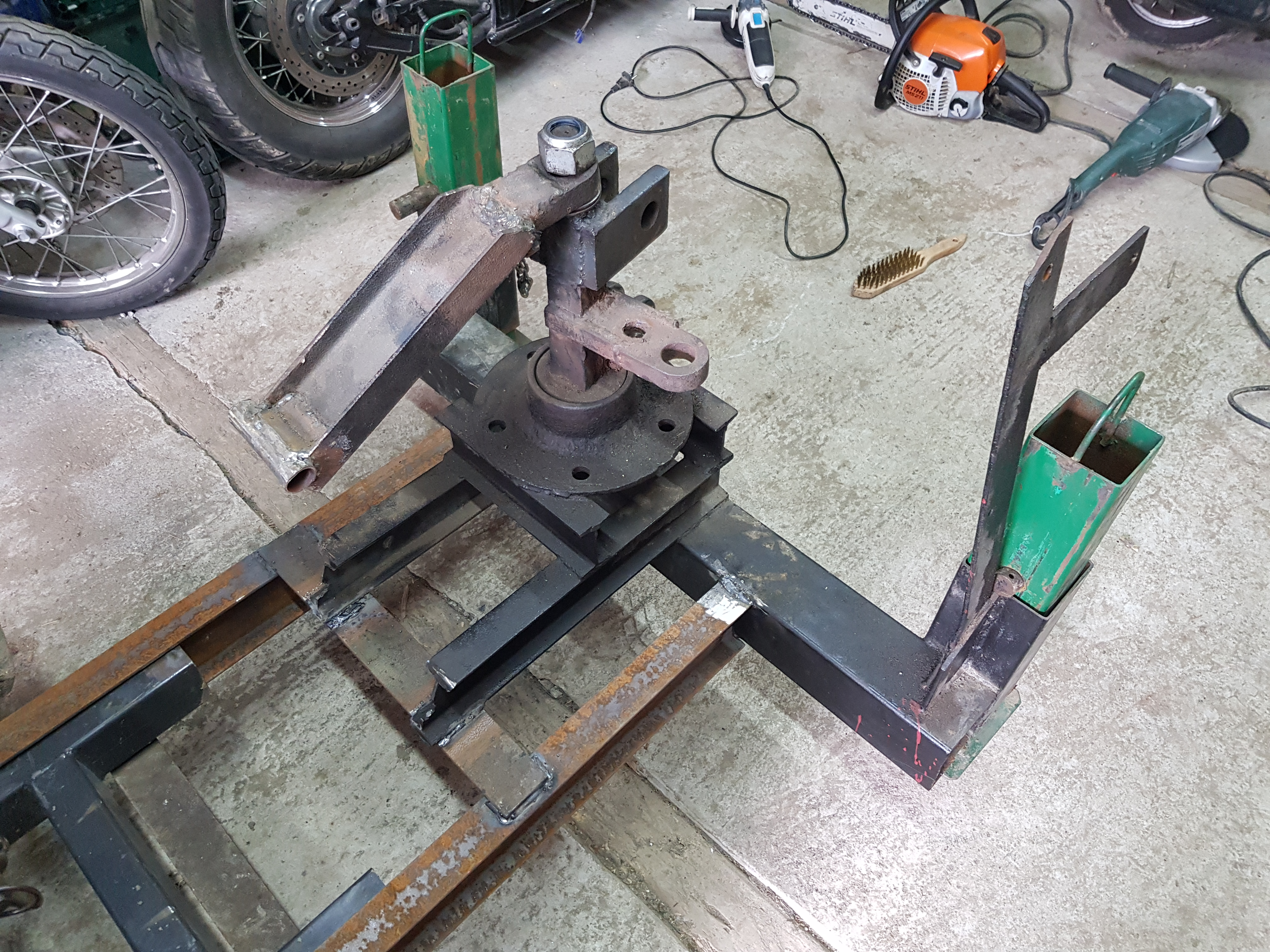

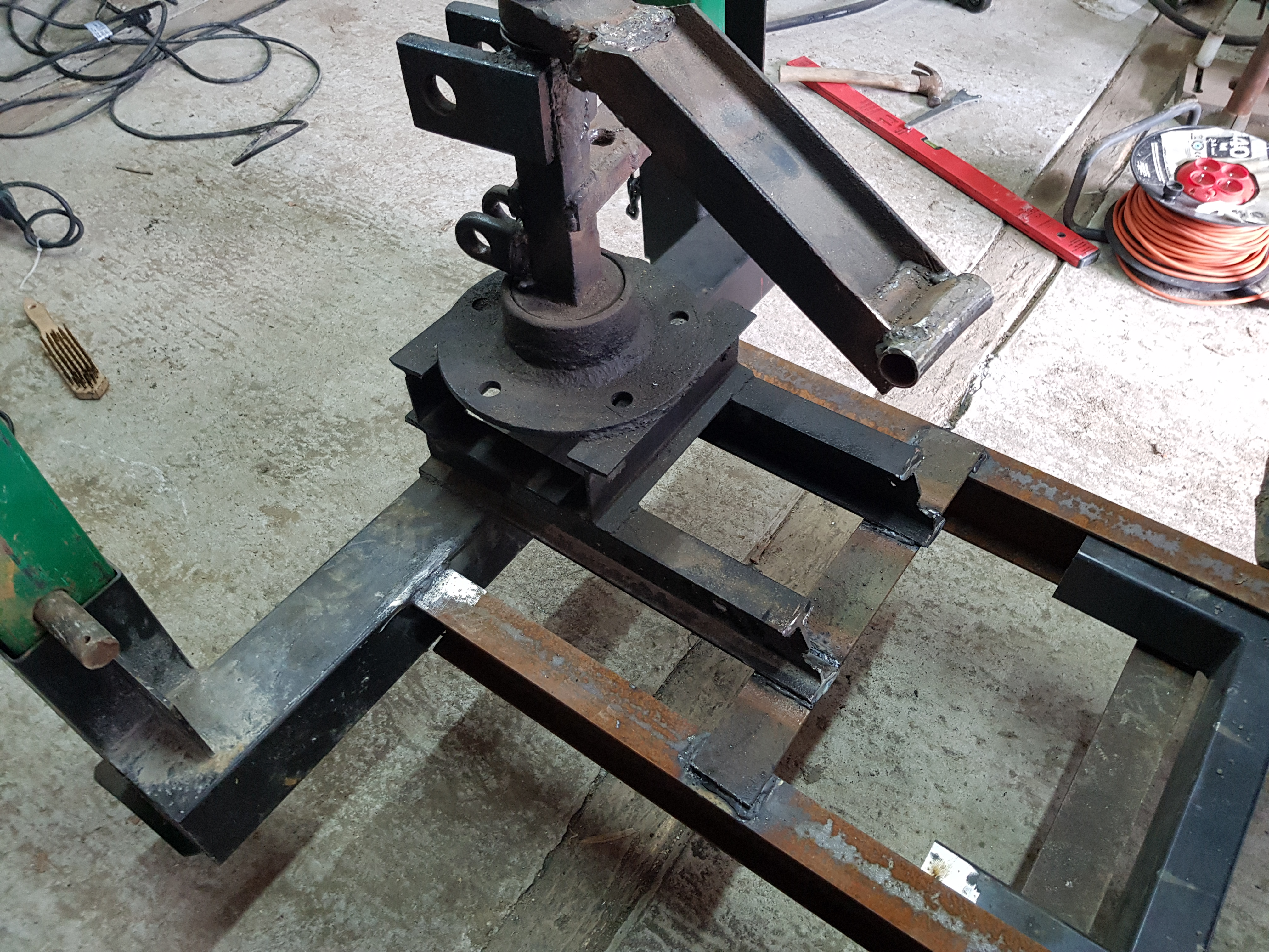

Ok, it took a while to move this subframe from the TX1500 onto the TX1300F. The reason is that there is a 0.5 cm difference in length between the two. And this steel subframe is not something that you can easily bend.
To make it fit with a minimal number of changes, i first connected the front 12 bolts, to the front, and to both sides of the engine.
I had to cut a few centimes from the end of the subframe (because my rotary tiller would not fit anymore), and also cut the parts that connect the subframe to the rear sides of the differential. These connections had some 'wings' welded onto the subframe, that would block the steel pipe going through the holes at the bottom of differential. And i still want to use the tractor for 'normal' 3-point operation, so it had to go.

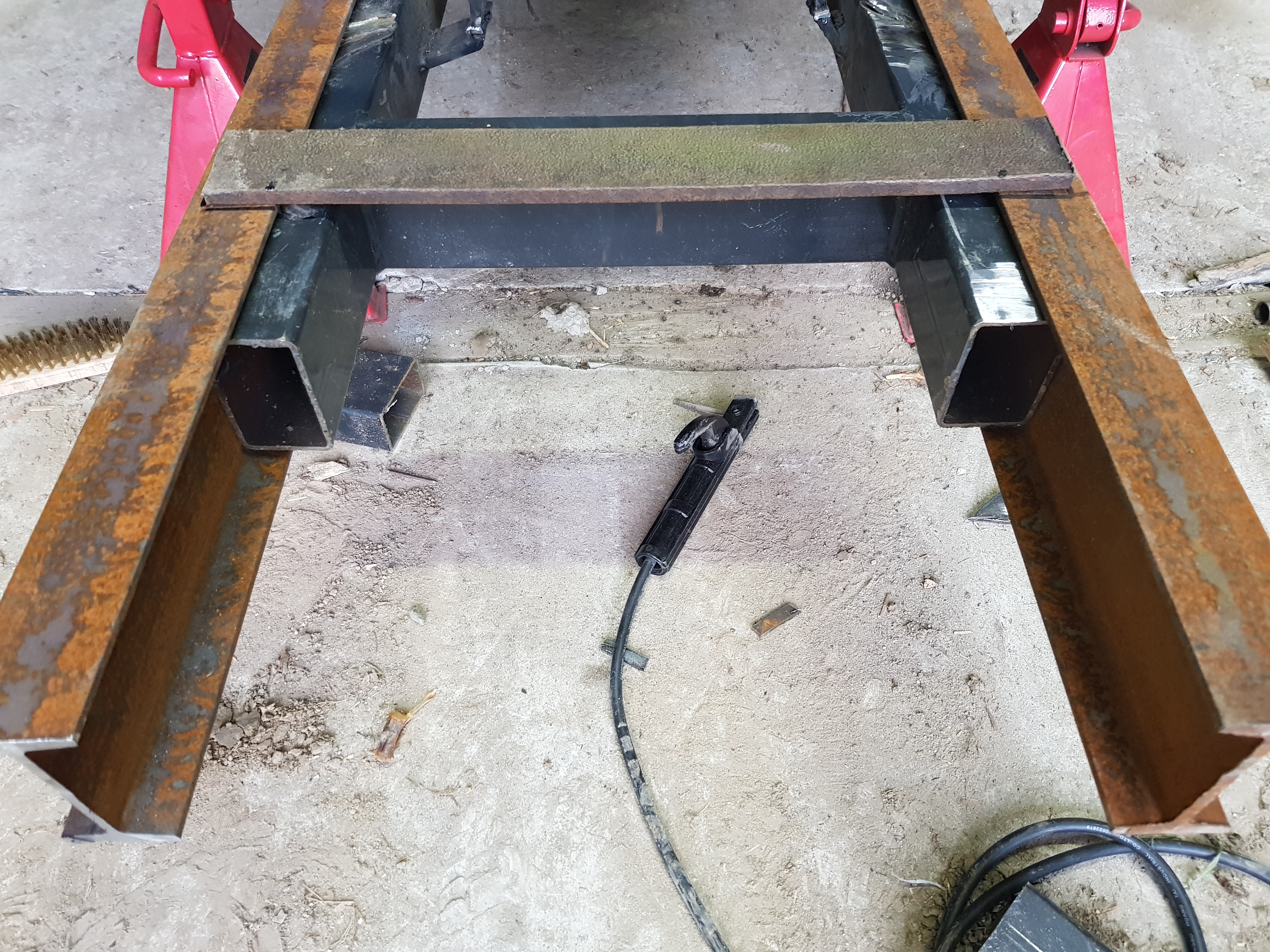

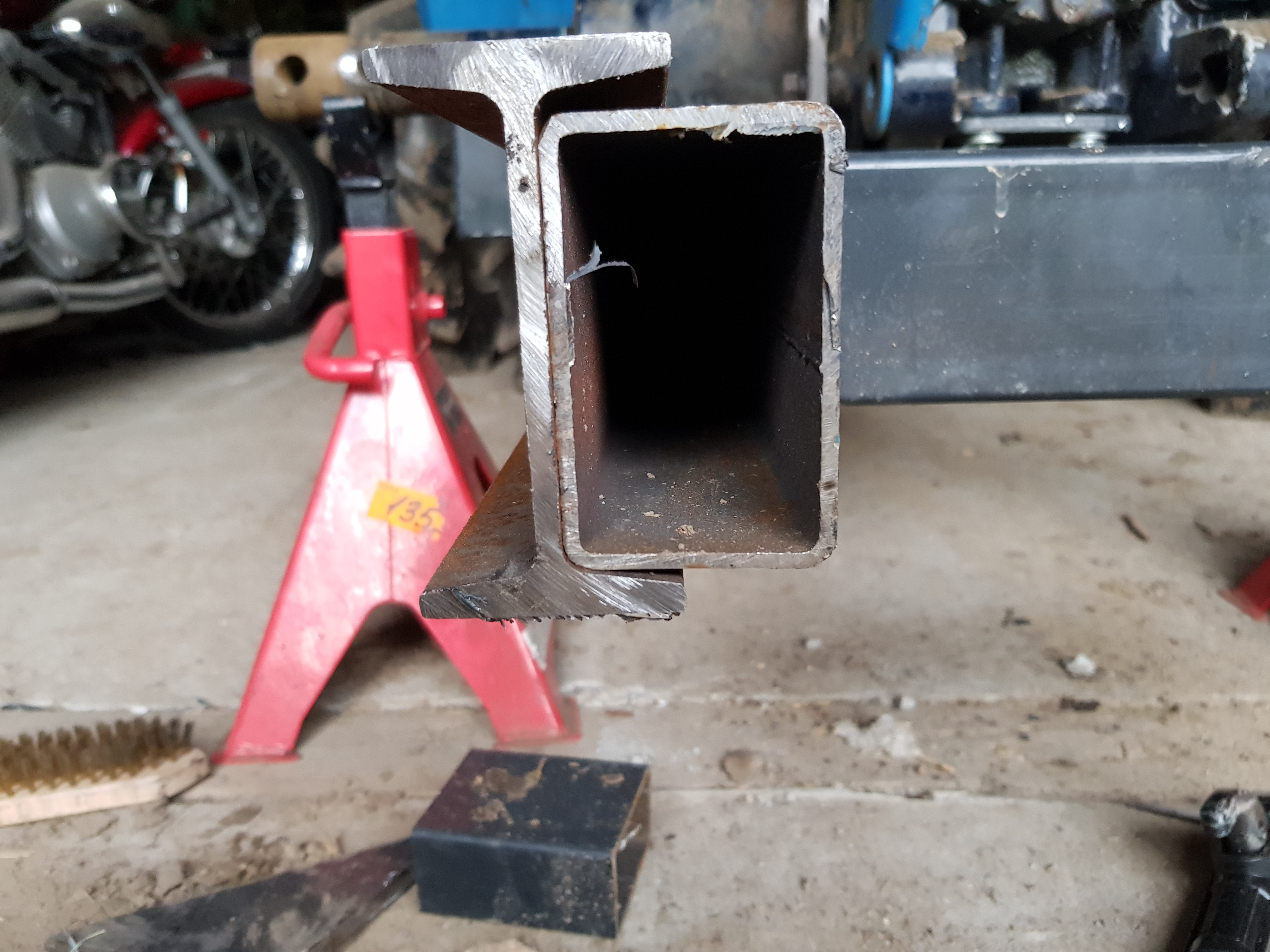

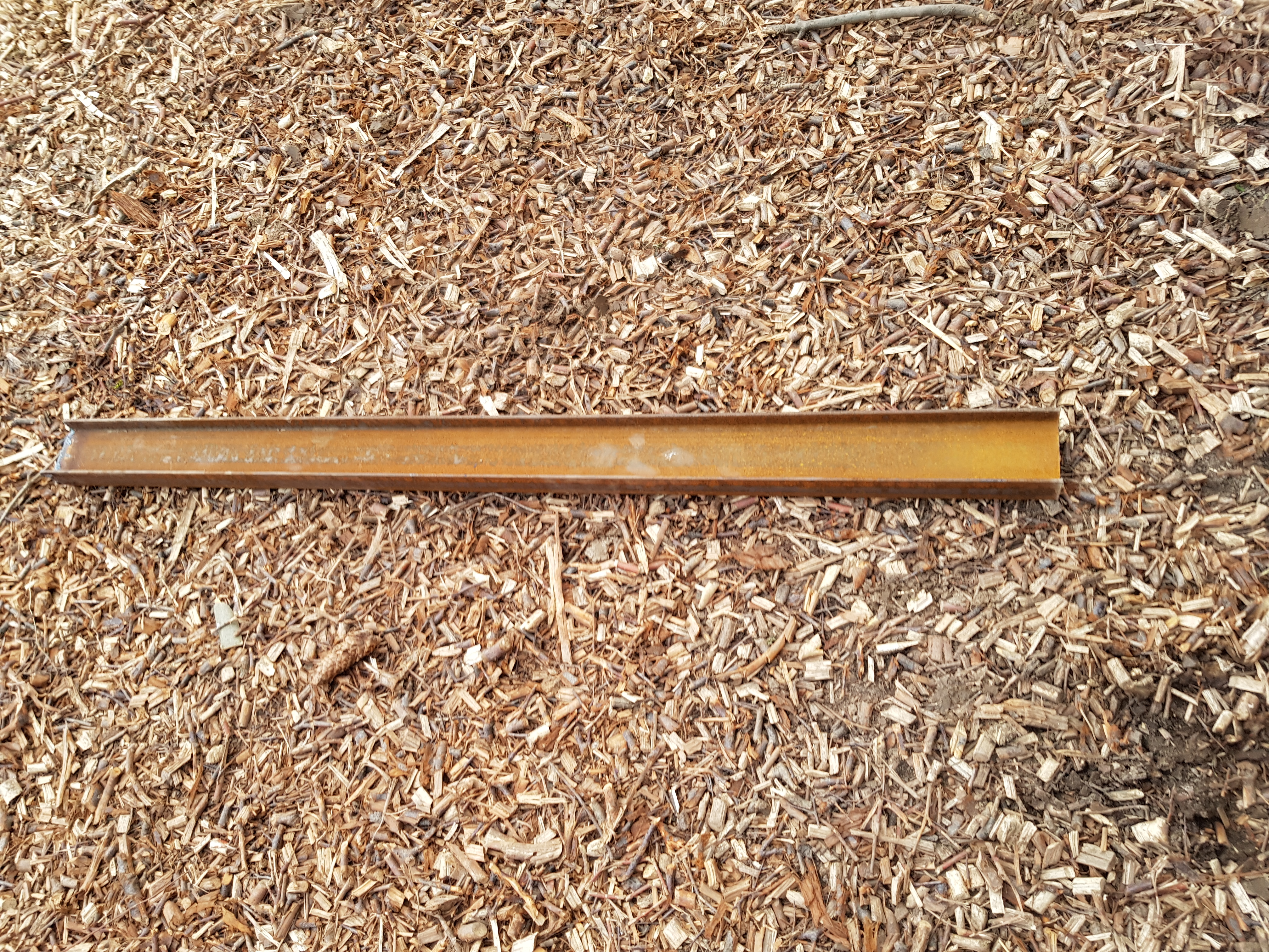

I bought some 1.5 meter of steel H-profile. The size should fit exactly around the square profile of the subframe connected to the tractor.

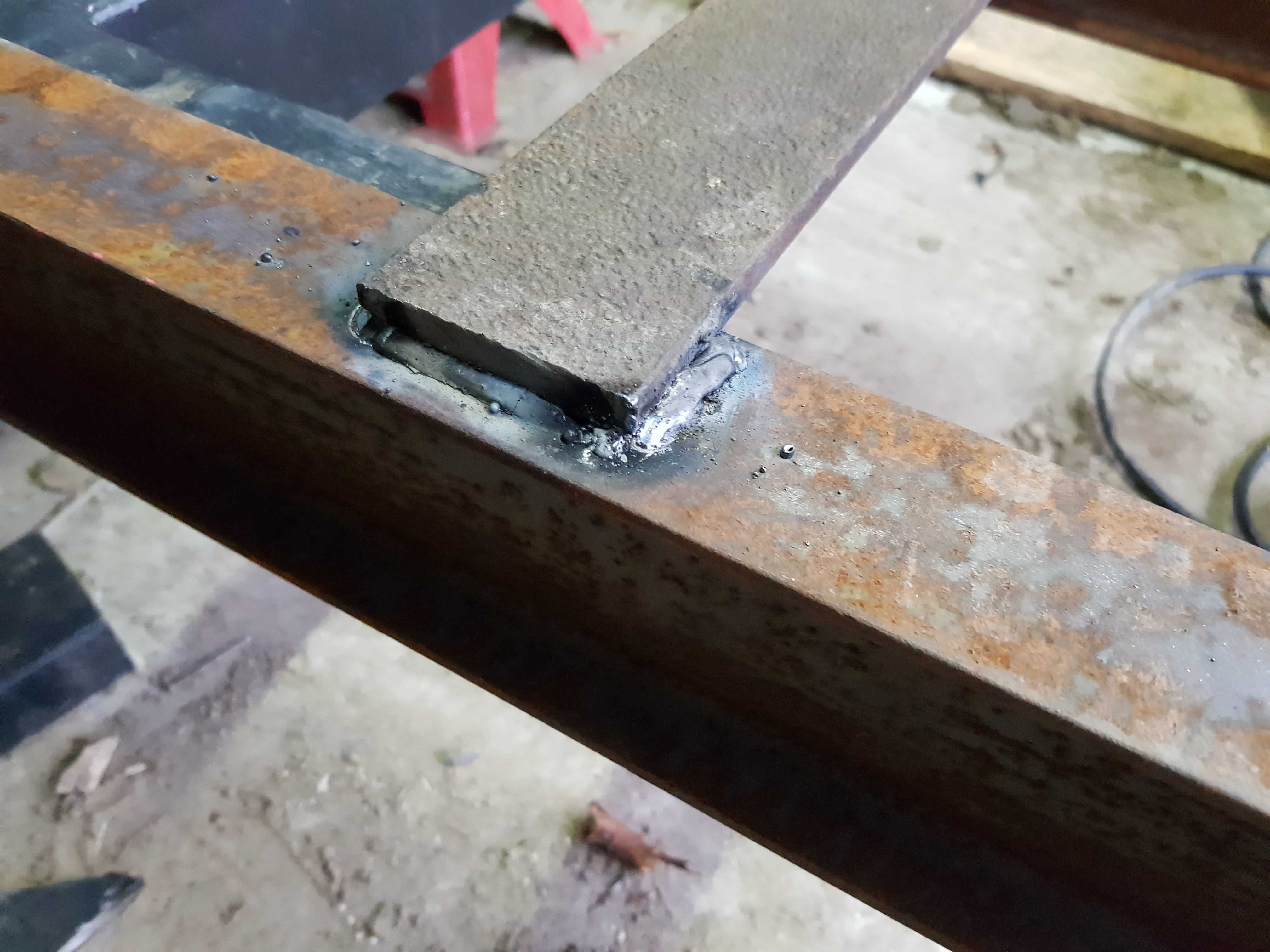

So i cut the H-profile into two 75cm pieces, and welded a connection/bridge between the two parts.
Please no comment on the welding, it was the first time i did this. Anyway time to test this how it fits the subframe: like a glove. I could slide the whole 75cm under the tractor.
Having this into place i welded the original central (bottom) part of the backhoe onto the sliders. You can clearly see the pivot, and the two side-points used to 'park' the backhoe. You can also see the 'hook' that was used to connect the old structure directly onto the differential. Which was what i am trying to avoid.
So far so good. Next issue is the hydraulics. I was looking for an external oil-pump, but this is proving to get too expensive. This is still a hobby project. Also the minimal reservoir i can get is 50 liter. I am trying to keep the weight of this construction as low as possible. So i decided to 'cut' the rubber hose (delivery) from the oil-pump going to the 3-point hydraulics, and insert this bajonet-type of connection. Then i can get the same type of bajonet connection onto the hydraulic hoses coming from the backhoe, making it relatively easy to connect and disconnect. And this way i will still be able to use all hydraulics (FEL and 3-point), even when backhoe is connected.
At least i have the slide-on/slide-off into place. Next is putting the backhoe back together again.To be continued...
