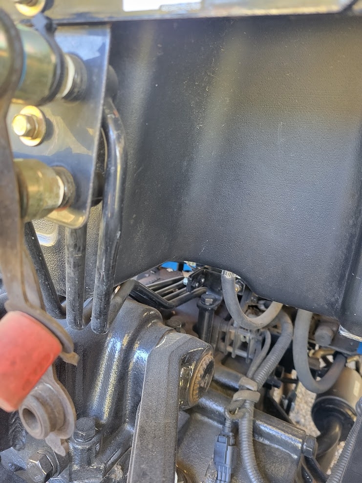

Does that flexible line run to the rear valve under the seat?
no, the flex hose runs to my 3rd function valve.
My rear remotes are all hard pipe (4), a little hard to see here, one shot of where they terminate under the seat, and another where you can kind of follow them start to finish.
   / Issue with installing dual rear remote on XG3135 #13
Following it out, kinda lol
That flex line runs to one side of my 3rd function valve, and the other side does run back to the rear valve under the seat, so taking the 3rd function out of circuit, I'd imagine the answer would be yes.
you can just make out the other end of the flex line fitting just below and left of the blue handle.
