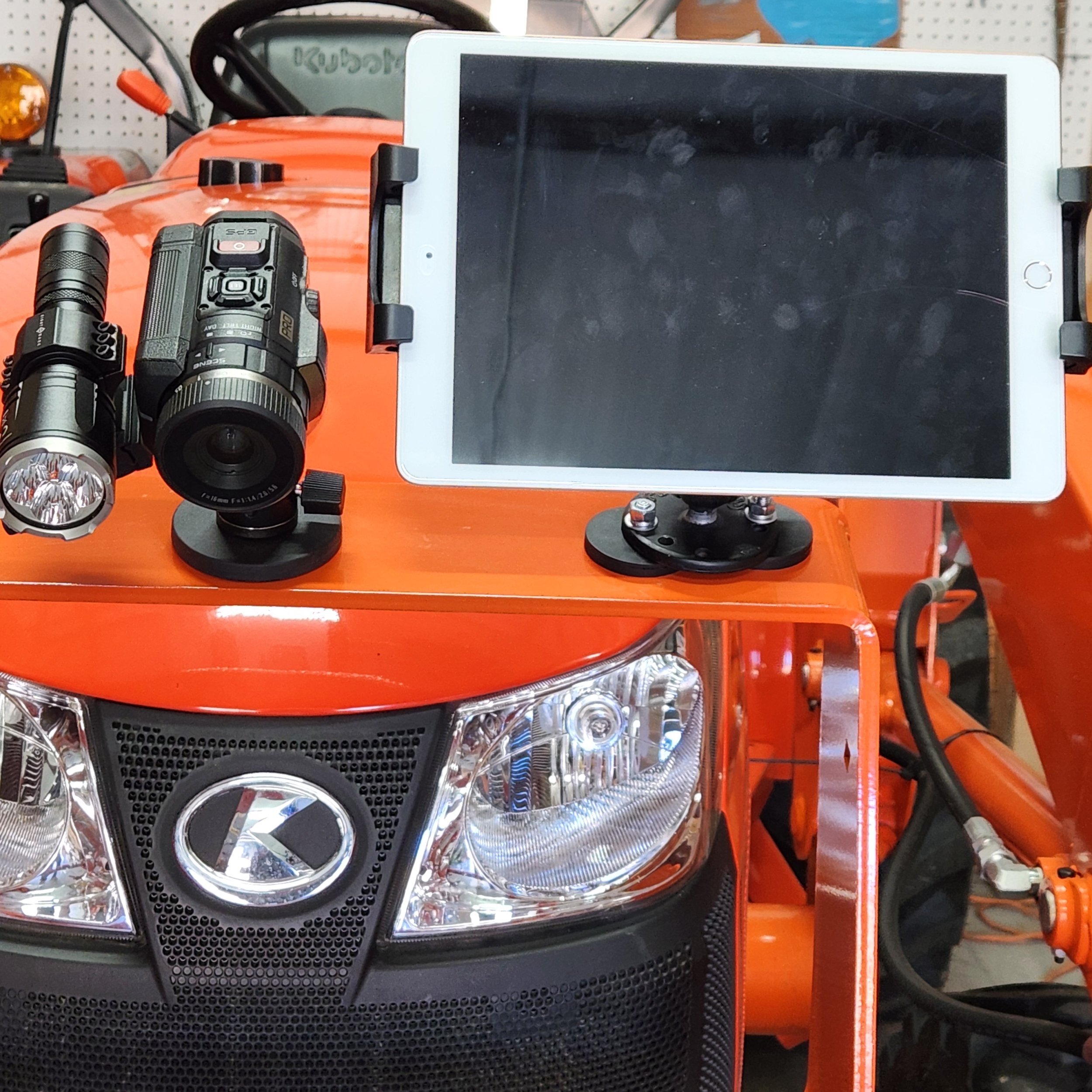

I am another user of backup camera on a magnetic mount. Easy to switch to what I need to do.

I just got pallet forks for my loader, and I’m finding it’s absolutely impossible to see the ends of the forks without either a camera or standing. I tried the mirror thing, but there’s just no arrangement of mirrors that will give the visibility I need.
I’m thinking that disabling the seat switch entirely is probably not the best idea, it’s there for those rare but legitimate situations where an operator is bounce or swept off the seat. I’m thinking a temporary bypass is easy and more appropriate, call it an “alternate operator presence button”, if you will.
I’m thinking a simple momentary contact button switch on the loader control lever, which bypasses the seat switch when pressed. When I need to stand to see the forks, bucket, or JDQA pins, I usually have one hand on the wheel and one hand on loader control lever, anyway.
Thoughts? Anyone here already doing this?
