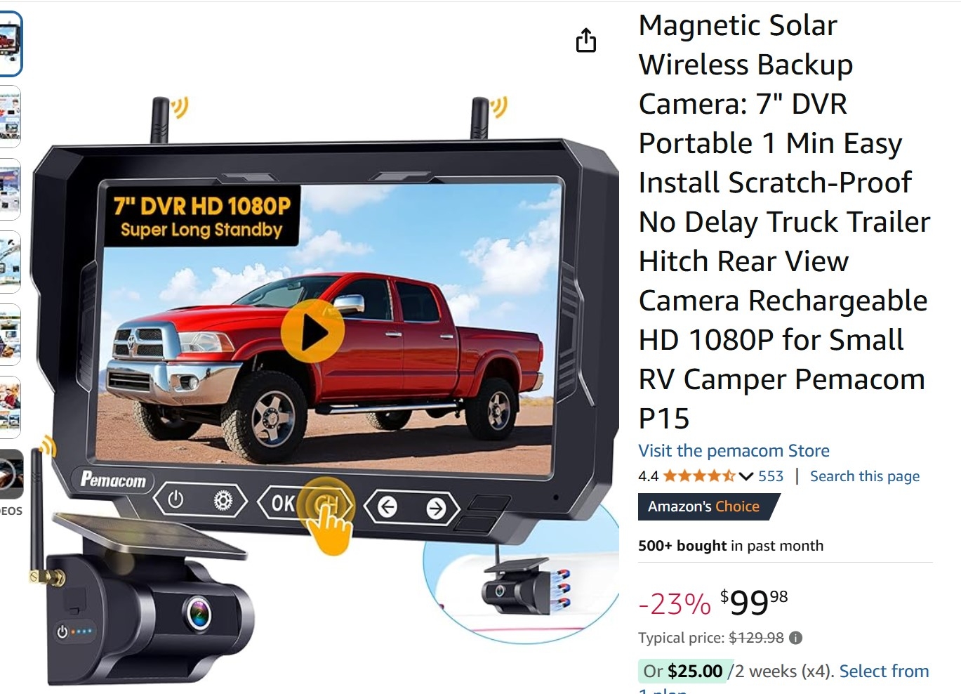

I added a front camera which helps with the SSQA but also forking pallets.
Can you post more info or photos on this? My 3033r has terrible forward visibility due to the shape of the hood and loader, easily the worst tractor I've ever owned, when comparing only on visibility for loader operations. I should probably consider some type of camera system myself, since I do spend a lot of time moving both pallets and logs with the forks.

I bought one of these. The camera portion has a powerful magnet that can be stuck anywhere on the front of your loader arms or forks assembly. It transmits an excellent picture wirelessly to the monitor that I stick on the instrument panel on my Kubota. No way I can see the forks to guide them into a pallet without this.
