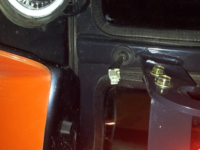

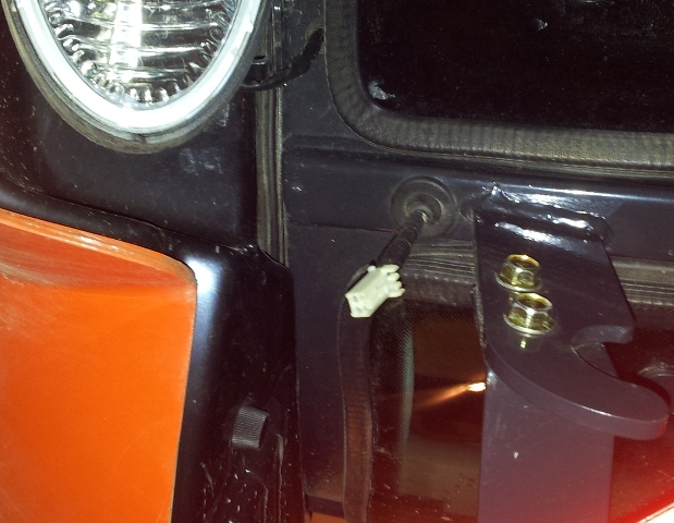

I'm planning to add an amber beacon LED warning light to my Kioti cab to augment the OEM flashers when plowing snow and grading. Probably this one: Amazon.com: HQRP 12V DC Emergency Amber LED Strobe Mini Light Beacon Flexible Pipe Mount / Low Profile, Tow / Plow Escort Safety for Truck Car Auto plus HQRP Coaster: Automotive My NX4510 has a dedicated molded connector for a beacon just above the bracket for the SMV sign, 12v power when the running lights are on. I've attached a couple of pics taken at different angles. Anyone happen to know what matching connector I'd need to make this a plug-and-play install?

I've seen that style of connectors in most brands of Japanese autos. Maybe take a trip to the junkyard? Have you checked with the dealer?
/ Connector for adding beacon warning light? #3
Just cut it off and put a weather pack on it.

Thanks, Everyone, for the replies. Good ideas. I did check with a dealer, but to their knowledge Kioti doesn't offer a kit for this, and they didn't have a cross-reference for a matching connector. Their customers who want a beacon usually just plug into the 12v accessory socket in the cab.
If I can track down the right connector, I'll post the info. Otherwise will snip off the OEM and go with Weather Pack or similar.

Yep, it turned out well. I fabbed a simple mounting plate for attaching the beacon to the bracket that originally held the SMV sign, and moved the sign to the opposite side of the tractor. For the electrical connection to the dedicated harness, I ended up just cutting off the Kioti factory connector and used crimp-on bullet connectors that I happened to have, followed by wire loom and electrical tape.
The beacon is on only when the running lights are on. So the headlights, work lights and factory warning flashers can be used without the beacon, if desired. I'll try to post a pic tomorrow, if you like. Very happy with the setup for only $40 all in.
