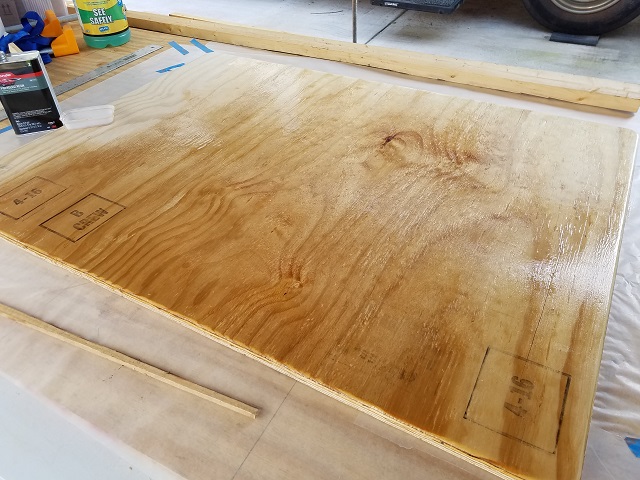

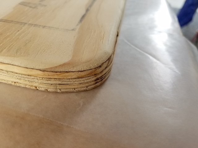

So I measured and cut a 3/4 piece of plywood to the desired size for my snow cab roof.
I used my router to round one edge which will be the top:
I put some wax paper down onto the work surface under the plywood:
I applied the resin on the plywood top and sides:
Next steps will be to do the underside and then I want to really get the edges with one more coat. Once I am done with the resin I will paint it probably with Rustolemm Enamel paint.
I am also scoping out the frame of the tractor to determine what/where my attach points will be for the cab.
More to come.....

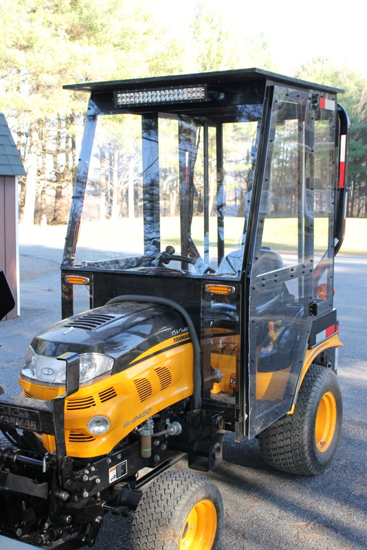

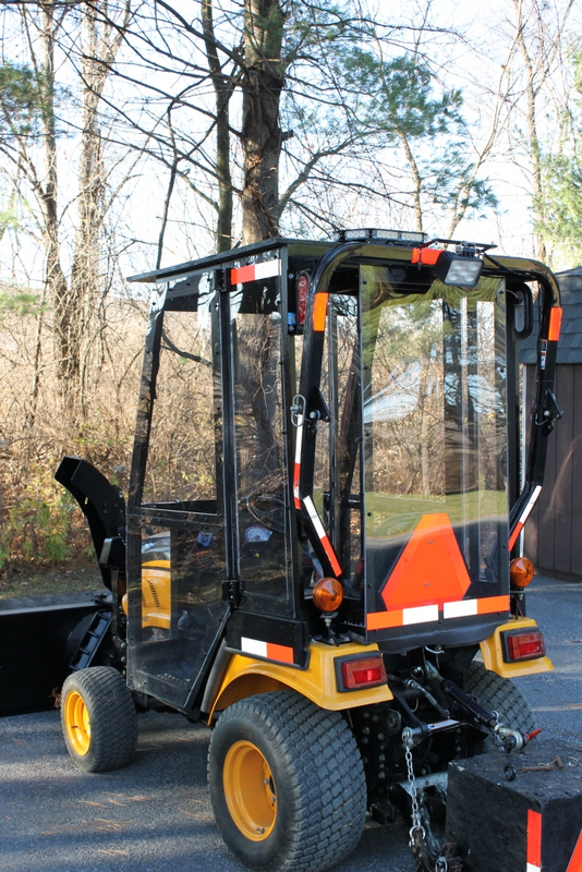

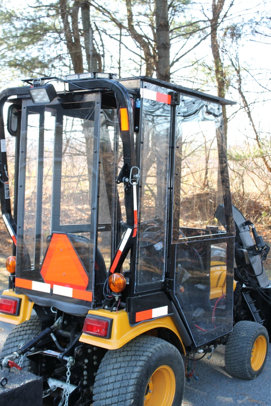

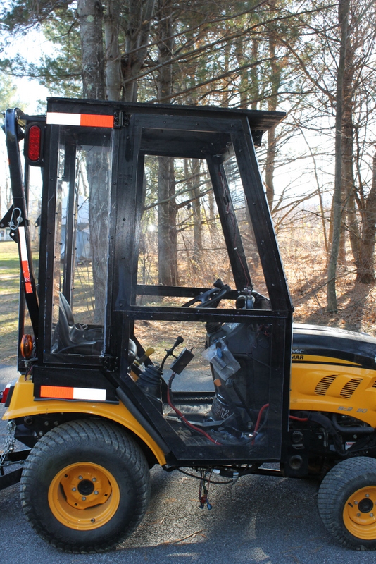

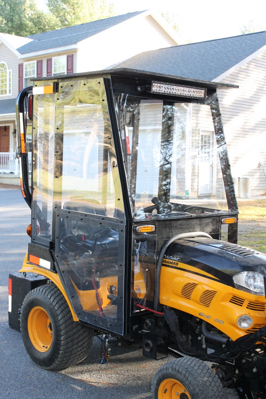

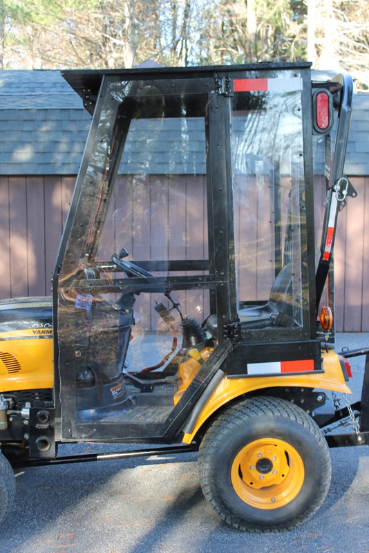

If you're going to make the roof wood, you're going to be top heavy, no matter how well you secure it.
Here's my plywood cab, around 6:05 I do a walk-around off it: IMG 16 - YouTube
It's top heavy. It sways. This is why I made my new cab out of sheet aluminum. Not to expensive, very light, and very sturdy.
Hmmmm, I will have to consider this. Thank you!

When ever I run over a lump of snow or curb when in that tractor, the whole thing sways. It's secure, but still, it definitely moves.
Almost forgot, if you go to remove it, it's going to be VERY HEAVY!
   / Gathering Materials for a Homemade Snow Cab for my John Deere X300 #19
I made mine out of wood and yes it is top heavy, Put a couple of bolts at the bottom of the cab to hold it down.
