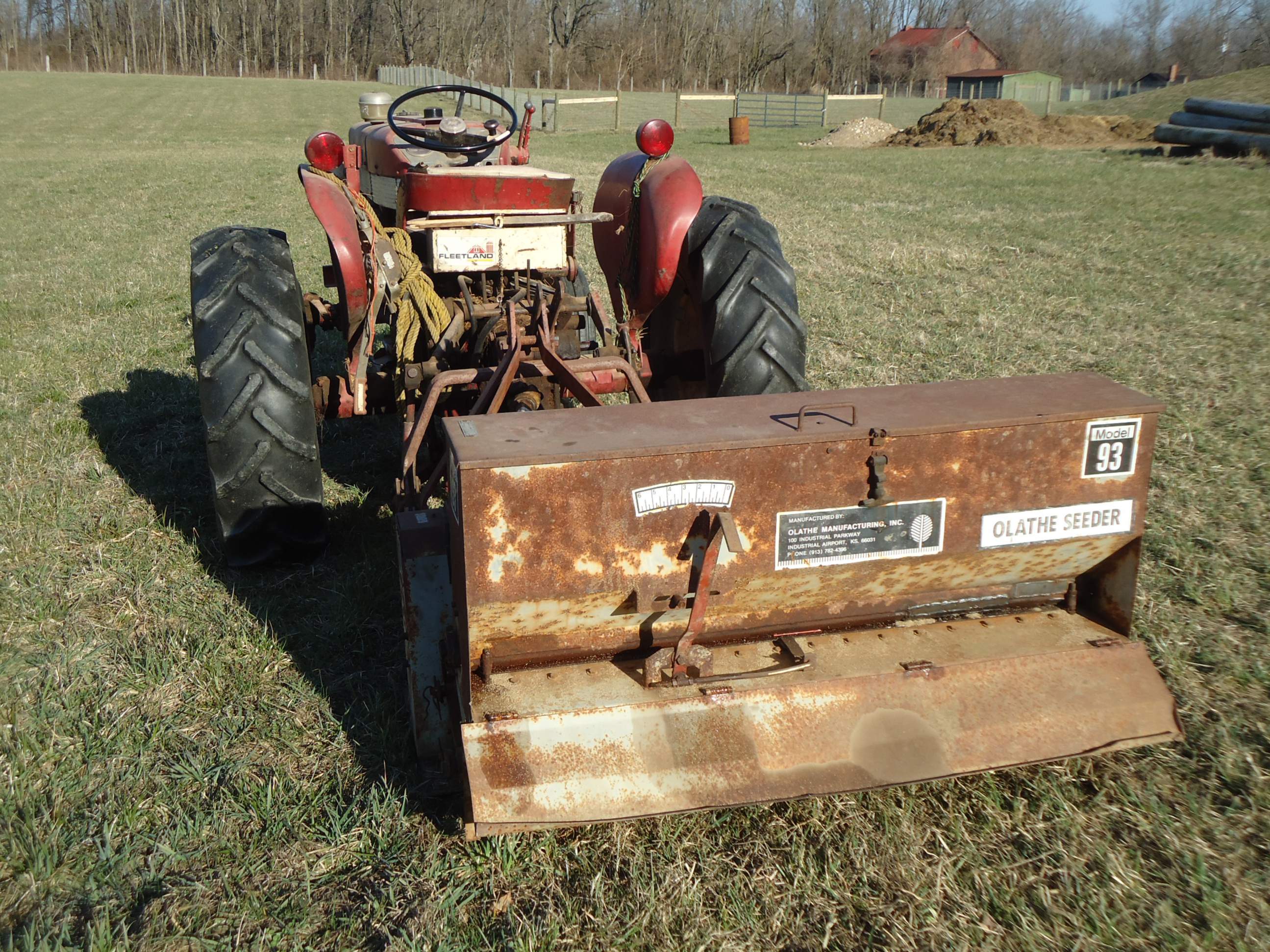

For small patches, you may want to consider the a slit seeder. Here is my Olathe, Craigslist $100.00 creampuff. Doesn't look to pretty on the outside, but clean as a pin inside, and underneath where it counts.
I planted my 4 acre hayfield with Tuukka Timothy with it, and it did a great job. Being seed was only planted 1/4"-3/8" deep, my little IH 240 powered it with ease. IIRC, the manual says you can plant at speeds up to 6-7 mph. I was limited by the single, 4 spd. trans. Planted in 3rd gear, @ 540 pto speed, and worked well.
Another plus is not having to wait for the wind to die down to broadcast seed.
I'd made several rounds, and took this picture to show how little it disturbed the existing grass. It's definitely a keeper here.
Not sure if you have any equipment dealers that rent such a thing there, but I have one near that rents another brand for $175.00 per day. Might be a good option to try one out, before spending some bucks on one.

Looked closely at those PTO driven over seeders. They're only 5' or so and would take quite a bit of time to rework some acreage. Be a good option for reworking dead spots, though.
Never seen an Olathe before or heard of 'em. What's on the business end (bottom) of the machine? Looks real straight, not all abused. Just a bit sunburned!

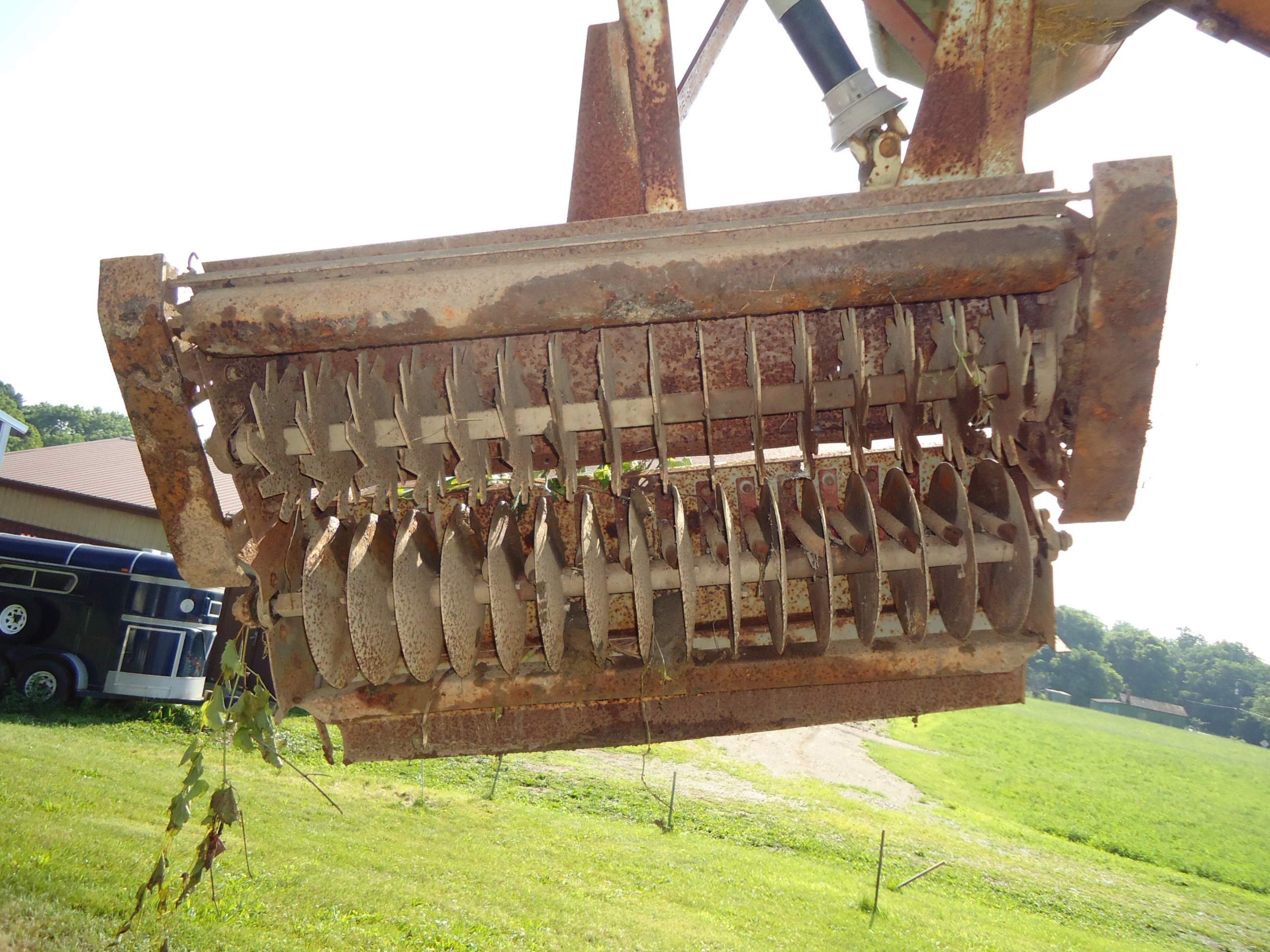

Here's what the underneath looks like. Rusty there too, but nothing broken. Polished up real nice after going over the 4 acres.
I did have to replace the pillow block bearings on the front roller, and replace the drive chains. Bearings looked like they'd never been greased, and the roller drive chains were so rusty from never being oiled, they would not pivot. As luck would have it, Surplus Center had them all, for about 1/3 of the price of anywhere else I checked.
It took me about 5 hours to cover that 4 acres, but a good half hour was playing around adjusting the seed drop, etc. Actual planting time was probably just a tad over 4 hours. Again, I was limited by speed. I'm thinking 3rd gear @ 540 is about 3.5 mph. So if you could move along at 6 mph, it would cut the time down quite a bit. Except for fertilizer, it's all done in one trip.
Olathe was a commercial type seeder. TORO has since bought them out. Still make the seeder, pretty much as is this one, so for now parts aren't a problem if needed.
This one was owned by a local high school to reseed the football field. They installed astro turf, about 8-10 years ago, so it sat outside until they sold it at a surplus auction. A school employee bought it, but never used it. Put it on Craigslist as a "make offer" type deal. It was setting in the weeds, as you can tell from some still hanging on it. Couldn't see it real well, so offered him $100, and he took it. Even loaded it for me on the truck. I was pretty pleased when I unloaded it, and saw the underneath.
