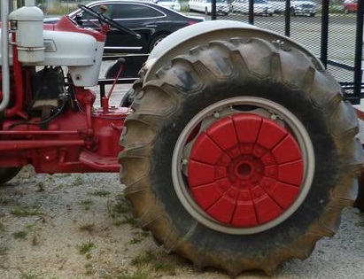

My 790 has 6 - 60 lbs iron weights, 180 lbs each side, 360 lbs total. The weights are compact enough to fit inside the wheels. Weights added around $900 dollars to the cost of the new tractor. Never felt like I needed more weight on this size tractor and never have to mess with calcium leaking or rusting the wheels out.
View attachment 439998 View attachment 439999
   / Consider cast weights instead of liquid in tires #18
My tractor has pie wheel weights (over 500 pounds per wheel) and fluid filled too. It was just that way when I bought it and I've never changed it. I must say, that all that extra weight will leave nice deep tracks in the yard, even when the ground is dry; but the old girl pulls strong before I get any tire spin.
