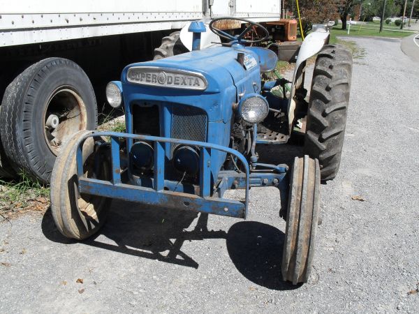

post a pic to show us if it really is a dexta.. or fords joke at badging 2000 as dexta ...
Here is a picture of the front of the tractor. Is this a real Super Dexta?

deffinately a limey

Super dexta is a1964. a local ford tractor took a 1958-1963 regular dexta in on trade and is asking $1900.00 with a freeman loader. Your super looks a little better and has good tires.If it checks ok $ 2500.00 to $2800.00 should be good.
