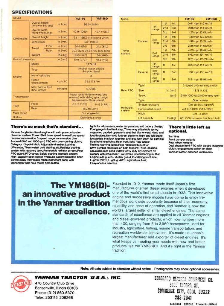

284.....comment are right on. Don't know if it was just a typo....but the 186d is 18hp.:thumbsup:
