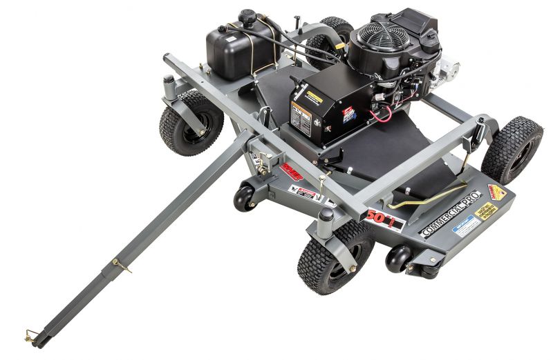

You could also get a tow-behind self-powered wing mower and cut your mowing time in half. Say you get a 60" belly mower for your tractor. Get a 60" wing mower and tow it offset, overlapping maybe a foot. So, you'd get 120" less the 12" overlap for 108" cut with a much smaller tractor. Basically cut your mowing time in half.
Something like this, for example.
6" Fast Finish 14.5 HP 12V Finish Cut Trail Mower FC1456CPKA
