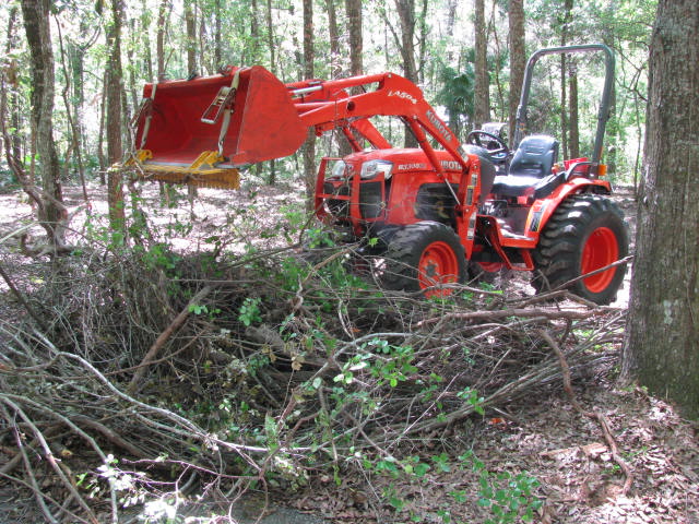

As you have TIME, why not get a 3,500 pound, bare weight tractor, such as a used MX, a Disc Harrow with 20" diameter pans and a Land Plane Grading Scraper (LPGS or Land Plane) and chop and shave that pasture until is is smootaroni?
VIDEO: TRACTOR LAND PLANE - YouTube

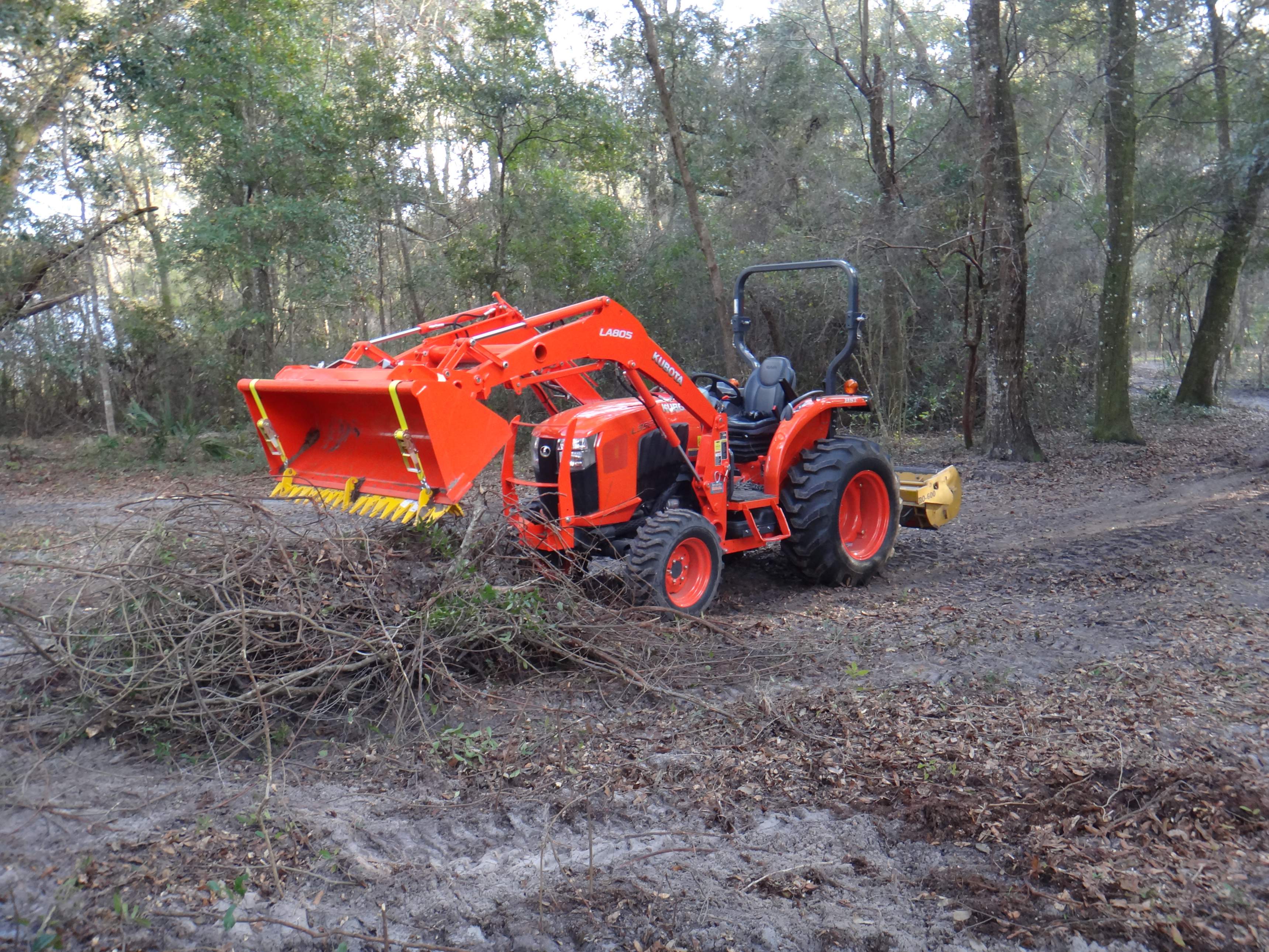

Also, for brush removal, nothing beats a Ratchet Rake attachment on a tractor FEL bucket.
VIDEO: ratchet rake brush clearing - YouTube
