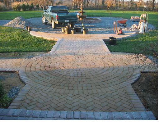

I just put in a paver walkway myself. It was only 42" wide by 35' but it is very easy to do yourself. I'll tackle a 10' x 20' patio next year when the wife gives me my new allowance. I scraped out the existing soil using my boxblade and it worked well. I highly recommend renting a plate compactor. I also rented a pavestone "breaker" instead of a wet saw. All of my cuts were square. The breaker is like a guillotine and only cost $20 for a weekend.
I don't know if you've already decided on the type of pavers your using, but take a look at the "Pavestone Tumbled Plaza". I intermixed square and rectangular in a "Muster K" pattern. They'll show the pattern on their literature. It looks real nice and has a little softer look then the standard pavers with the crisp edges.

I installed about 600 square feet of pavers two years ago. I used a crushed limestone base. I used a rear tine tiller to excavate/cut the soil and my FEL to remove it. I did about a 4 to 6 inch base and 2 years later they ae holding up well. I was amazed how well a tile saw could cut brick, I cut a couple of 1/8 inch slices just playing with it, it was an enjoyable project.
