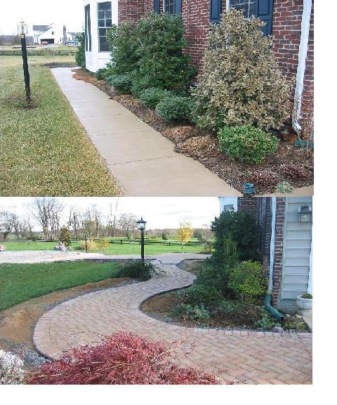

   / Considering Installing My Own Pavers... #30
Mike,
Here is a before and after photo of a sidewalk my wife and I did ourselves. It was a lot of work but you can definitely DIY.
It looks like you live in my neck of the woods. I'm near Hillsboro. I have photos of the complete process if you're interested.
