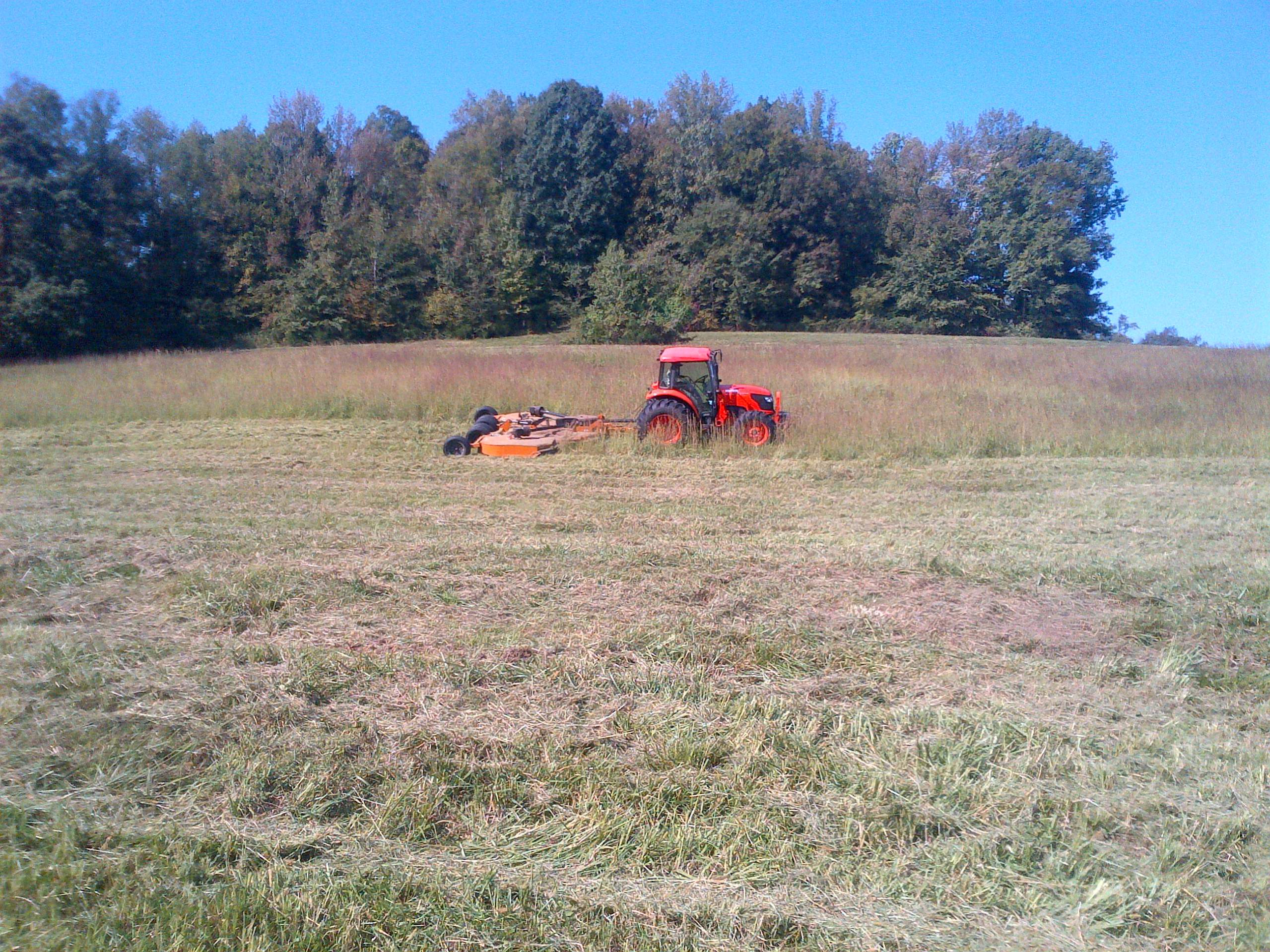

I could probably be fine with a smaller hp and the batwing, but I wanted to have plenty of power. Xring100 is right on. For most of the cutting I do, the 9540 hardly knows it is behind it. However, I've have cut some buckgrass as tall as my windsheild wiper on the cab and the engine slowly started coming down to point I had to clutch and stop or it would have killed it and that was in 2 low on an 8x8. The 9540 can be choked down, just depends on what you are cutting. Weight is also a factor for hills I have. I didn't want to be pushed around and I've been pleased with that aspect, rears loaded and weights on the front.
One dealer I spoke to recommended that if you ever hay and pull a larger round baler, you don't want much less than a 85 hp at the PTO. Again, that probably depends on factors such as speed and thickness and size of the baler. Salem-20120922-00037.jpg
One dealer I spoke to recommended that if you ever hay and pull a larger round baler, you don't want much less than a 85 hp at the PTO. Again, that probably depends on factors such as speed and thickness and size of the baler. View attachment 378571
