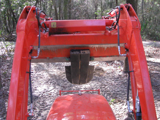

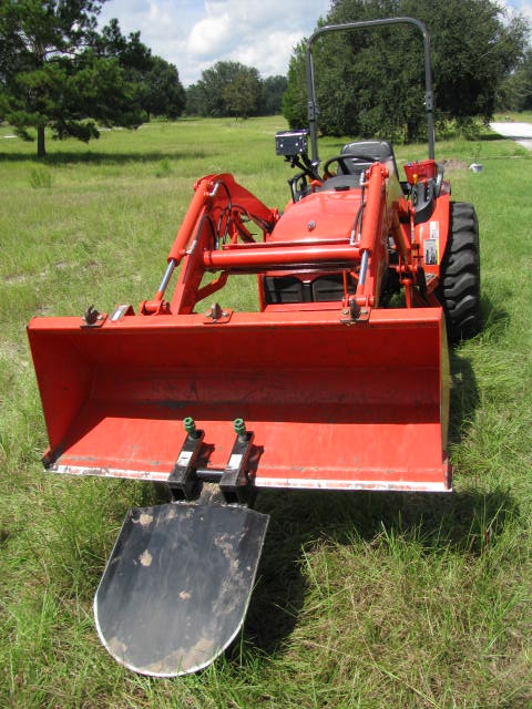

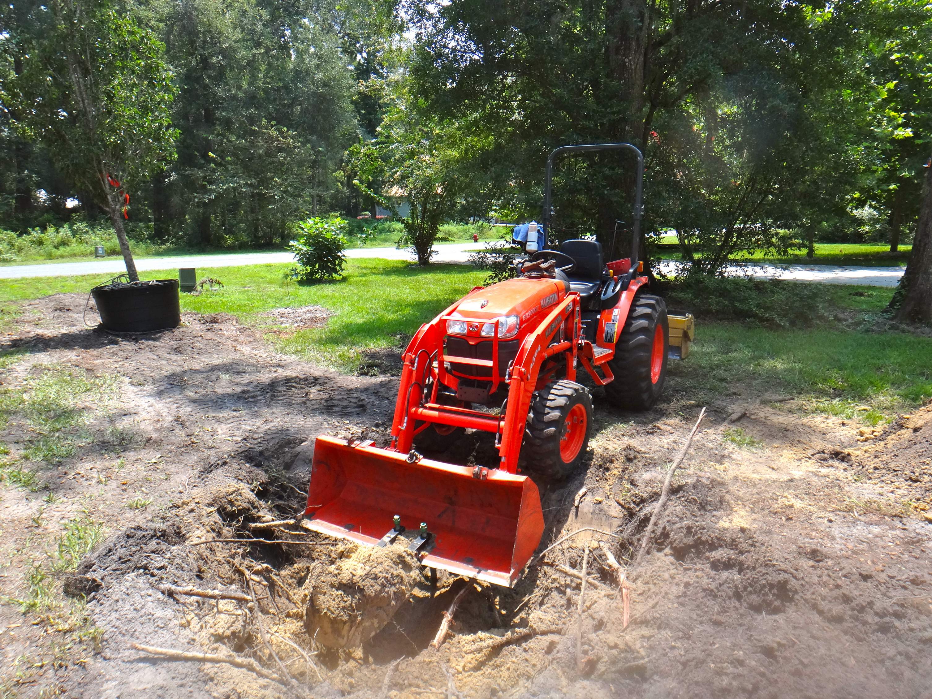

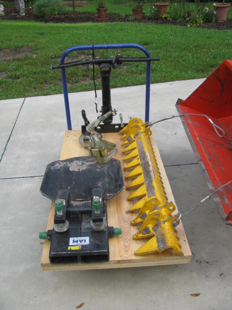

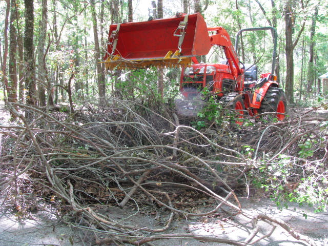

Other attachments I recommend are both supplements to the FEL: Ratchet Rake and either "Rip & Dig" by Ratchet Rake or a clamp-on Bucket Spade. Neither are as powerful as a Backhoe but both are very useful and less than $400 each. ( Also get a platform dolly for the pair. Save your back. )
