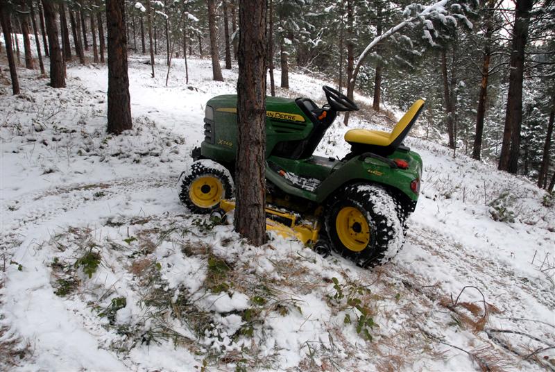

AKfish said:
Those are sho' nuff R3 "turrfies"!
Looks like the MMM could have worn off the little rubber thingeys' when the tires were brand new --- not a great deal of clearance...
Good lookin' machine. And -- just guessin' -- the pic wasn't taken last weekend...
AKfish
Nope. There is plenty of clearance. More than there was on my last Kubota by far.
KB

Interesting thread since I am kind of in the same boat. I agree that the weight, and size of a garden tractor is really best for mowing, when considering turf damage. Even my BX22 with loaded bar tires, but without loader, and BH was noticably more damaging to tender areas in the spring when used side by side with my Simplicity Legacy (which is the same size as the X7xx series.)
The jury is still out for me on the 4 wheel steer though. One TBN member recently bought a JD X749, and posted some pretty impressive pictures of that thing on slopes. You might want to do a search, and follow that thread (in lawn, and garden I think)
I sold my BX private sale quickly, and the OP might want to consider that option too. You get a better price, and being without a tractor at all sure forces you to reevaluate your needs. ( Yea, I know, becoming a tractor dealer was the last thing I wanted to do too, but local dealers weren't too interested in trading)
Thanks for the input on the 2520 mowing! I've been thinking about the 2320 some, and needed that input. I also need a loader, and am beginning to think that there is no one tractor solution. (My Simplicity mows OK, but I've just never come to love that thing...... at 500 hrs now)
Here is a link to the thread on the X749
http://www.tractorbynet.com/forums/lawn-garden/110065-deere-new-models.html?highlight=x749
And a Pic:
