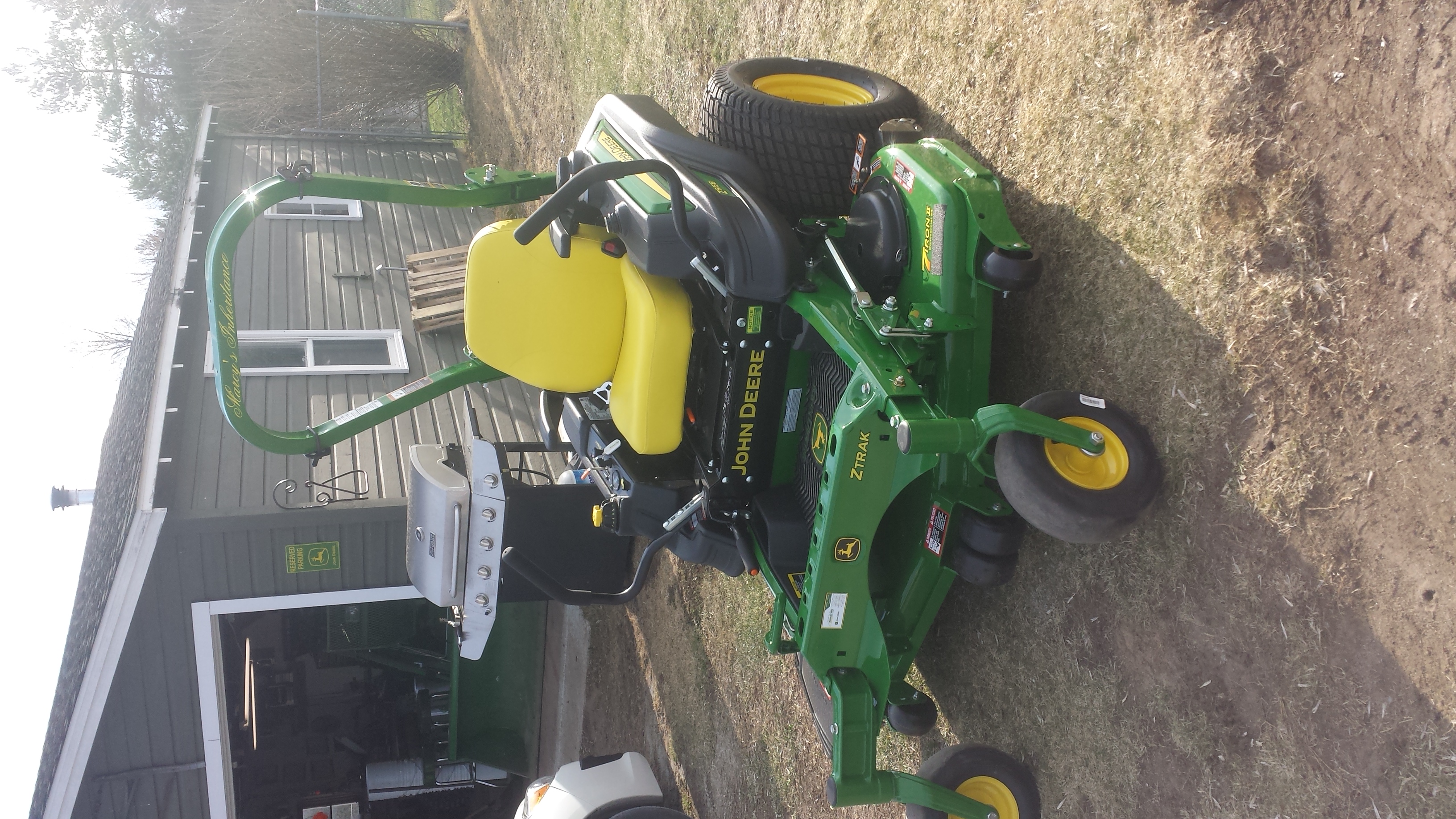

I ended up buying the 915. So far, the machine is great! I cut my mowing time from around 4 hours to a consistent 1.4 so far. I bought it with the isolation seat, but I may upgrade to a suspension setup soon. Kills my back on the large bumps. Quality of cut is excellent. Took me a bit to get used to a zero turn setup, but now that I have it down, it's very intuitive. Overall, very impressed.

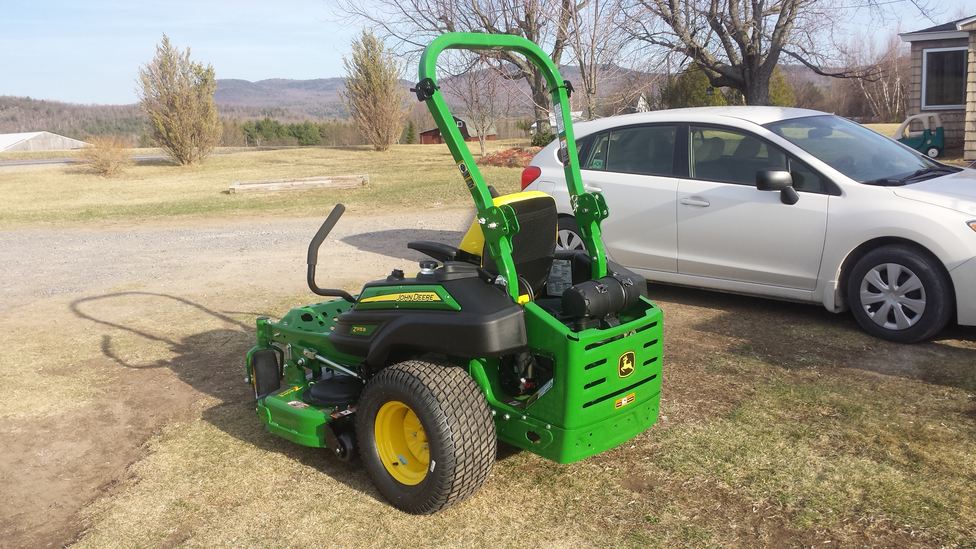

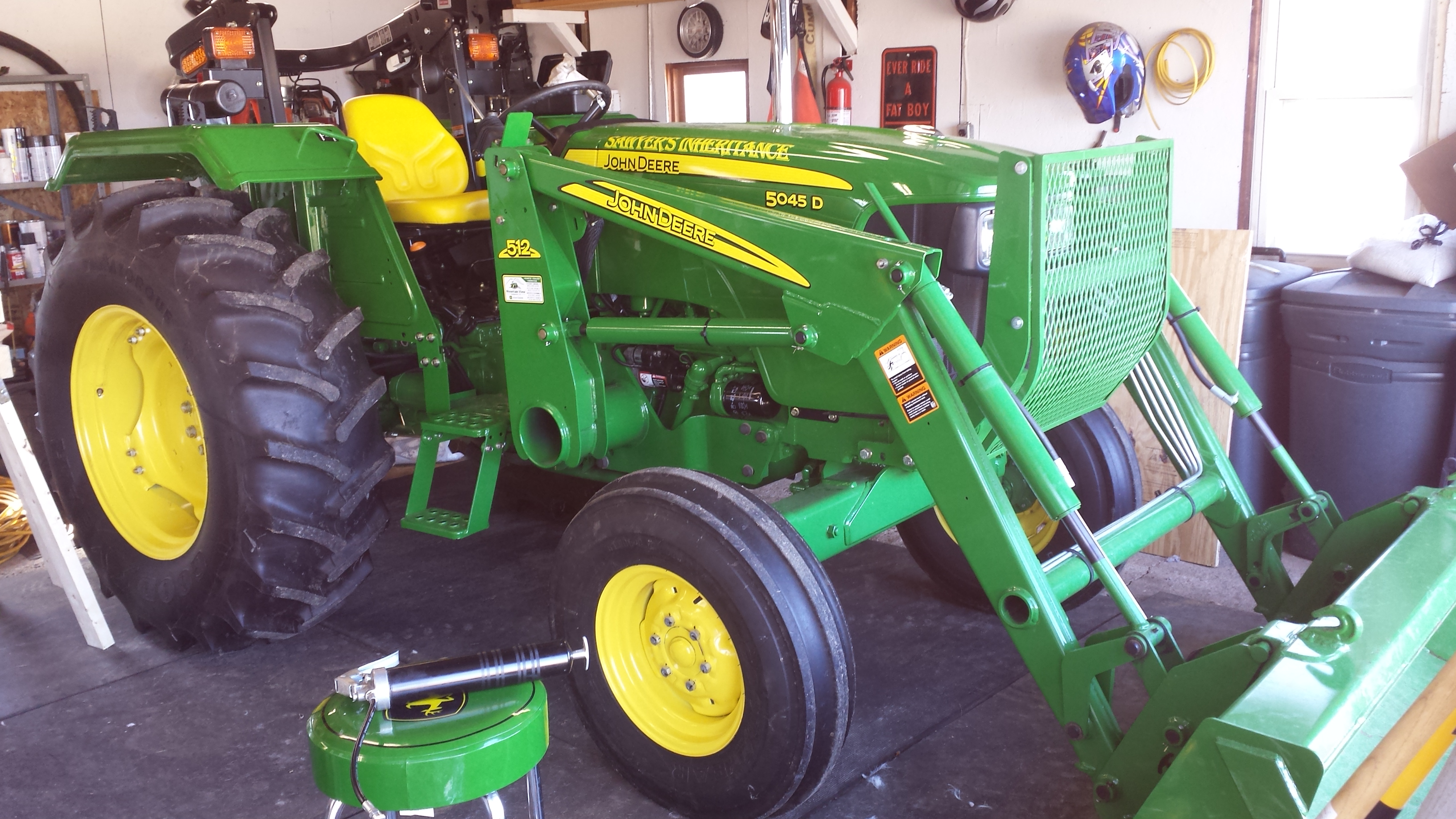

It's got the 54" deck. I'm glad I didn't go with the 60" as I had planned. The edge of the deck is right where it needs to be to see easily when trimming around fences/buildings /etc. Another thing that I didn't really pay attention to when shopping, but turns out to be a great feature; the left front corner of the deck is angled at 45°, so when you approach a corner of any sort, you can drive to within an inch of the object, then pull the right lever back, and the rig can trim very close(within 3" or so) to objects my conventional mower left over a foot of apron on. Equals a ton less trimming. Deere doesn't offer a specific suspension system for the 915b, but since it's the same chassis as the other 900's, I will stop at a dealer and measure a unit equipped with one and compare before ordering. If it'll bolt right in, I'll pay more for the Deere. If not I'll buy from one of the many sources I've seen on here for them. The freehand lettering is a touch I added to it thanks to DIYlettering.com. The decals have become kind of a running joke in the family, as all my money goes into the equipment. Hence 'Marcy's Inheritance.' My 5045D has 'Sawyer's Inheritance' on the hood... 1463832829347.jpg

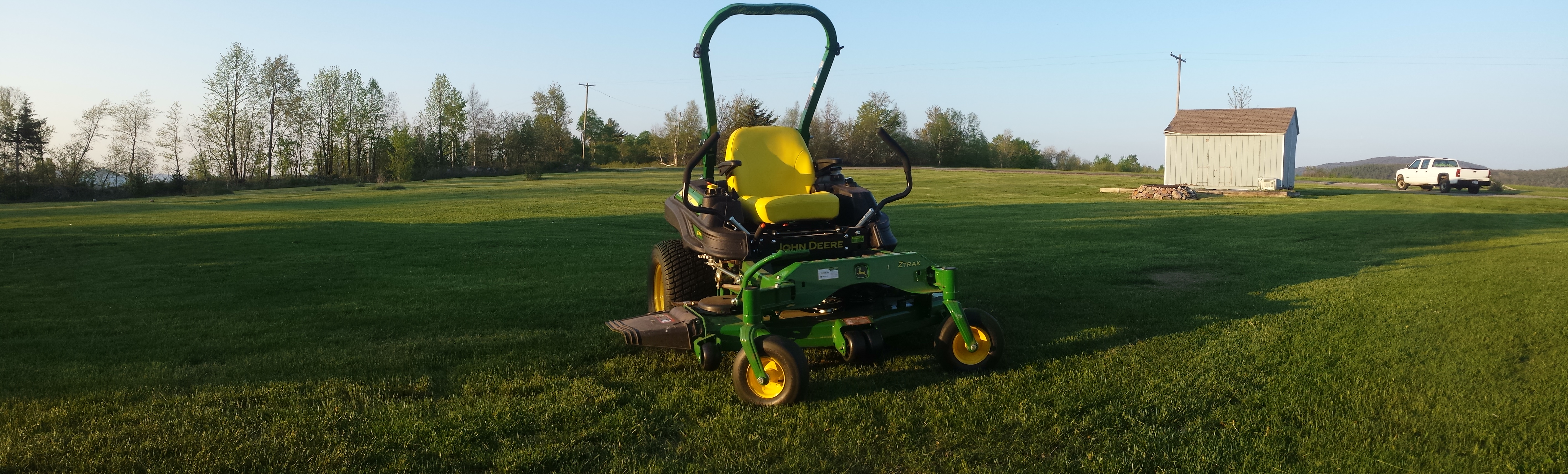

PS. Good sunset pic
