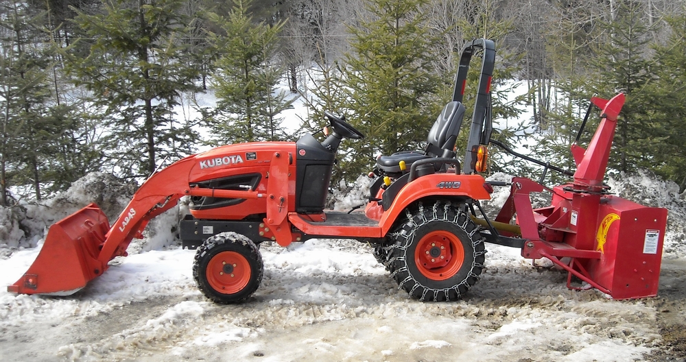

I have a BX2660 not the BX24.
Everyones situation is different. Here is mine.
Maybe on flat level ground a front mount blower is good although I recommend the rear mount blower. I use the FEL and blower on EVERY storm.
The only Flat area I have is the front and sides of my 3-bay garage. I myself would not be able to use a front mount because of the terain I have. Often I also need to use the FEL to get "unstuck" by pushing the tractor with the bucket tilt.
I live on a gravel road and the town sands the road with real course sand (almost a gravel) The pile of snow they leave is so full of this couse sand that I can guarrantee I will shear a bolt if I don't FEL the first foot or so. I clear about 100 feet of the edge of road.
