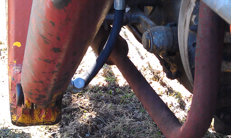

As for the Hyd system, on this Sunday I blew the main line at the front mounted loader Hyd pump, the high pressure hose connected to the pump popped and spurted. I had just started the tractor up, and was getting ready to lift up and move forward. The burst was directly forward, with a direct hit to the back of the bucket. A quick shutdown cut the oil loss to less than a gallon.
So this opens the budget to get some new hoses. This will include the aforementioned hose near the exhaust manifold. I am now searching for a vendor for hoses near me. I have the one burst one, and I think 8 of the other hoses show signs of aging. Of those 8, 2 are immediate candidates, the worst has rusting metal wrap visible through rubber cracking. That's near the dump cylinder.

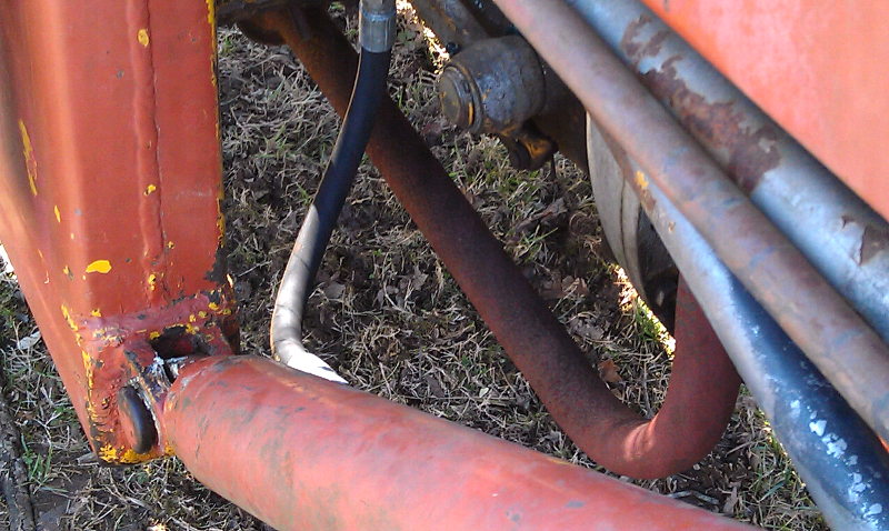

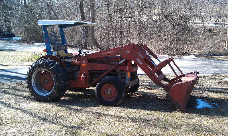

I did get 3 hoses made by Baum Hydraulics in Nebraska. With shipping, just over $20 each.
I just had to figure out the precise end types. I messed up on one, but got a couple fittings at Tractor Supply to make the connection.
So, now the loader lift cylinder has a new hose, with about 5" separated from the exhaust.

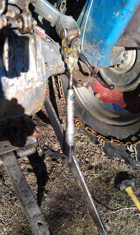

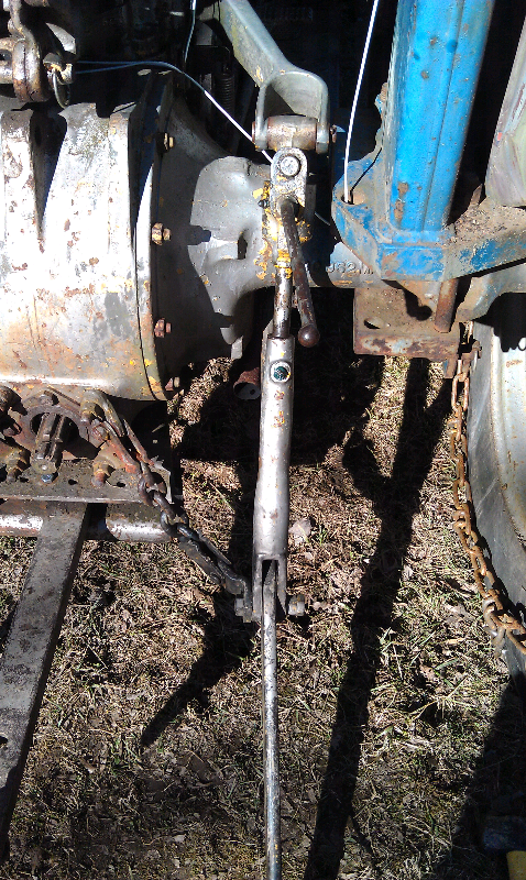

I also fixed the 3 point adjustment lever/gear. Needed some elbow grease and new grease. I suspect the old grease had dried out, and made it too stiff.

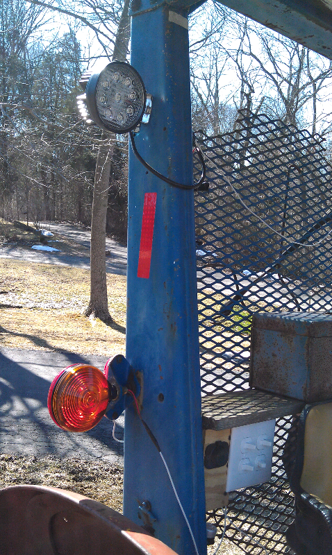

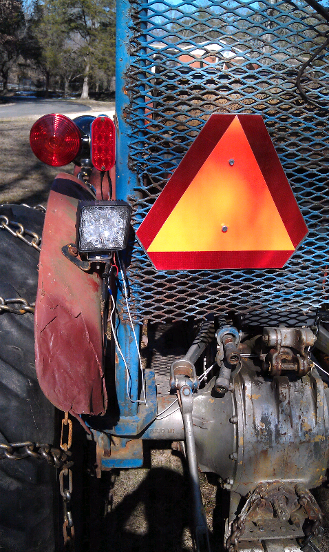

Then, I added LED lights and new blinkers.
I added some regular switches to control the lights.
And I added a marine grade USB port for charging cell phone.

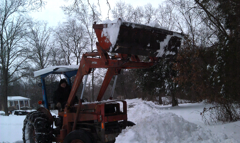

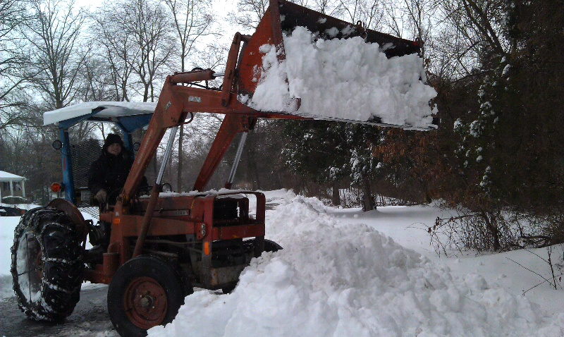

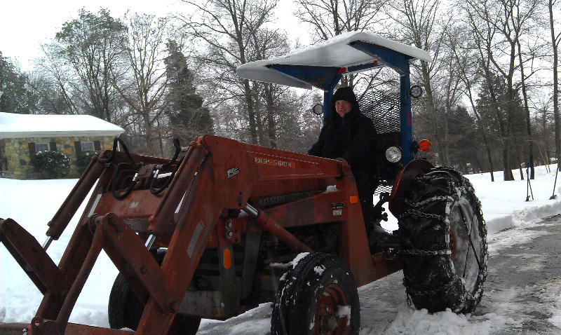

Finally, I moved snow in the big storm of February.
It took awhile to clear the driveway, the slush under the 14" made traction difficult, even with the chains on the Ag tires.

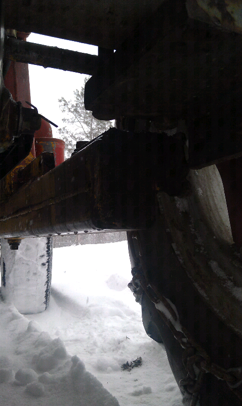

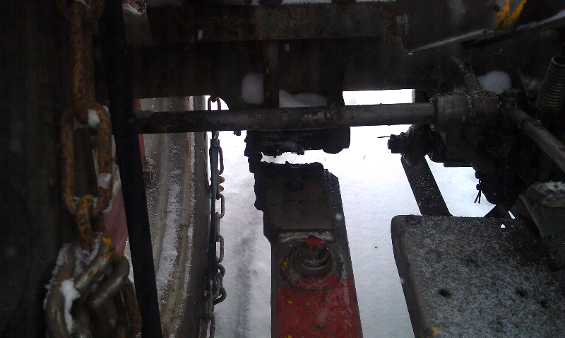

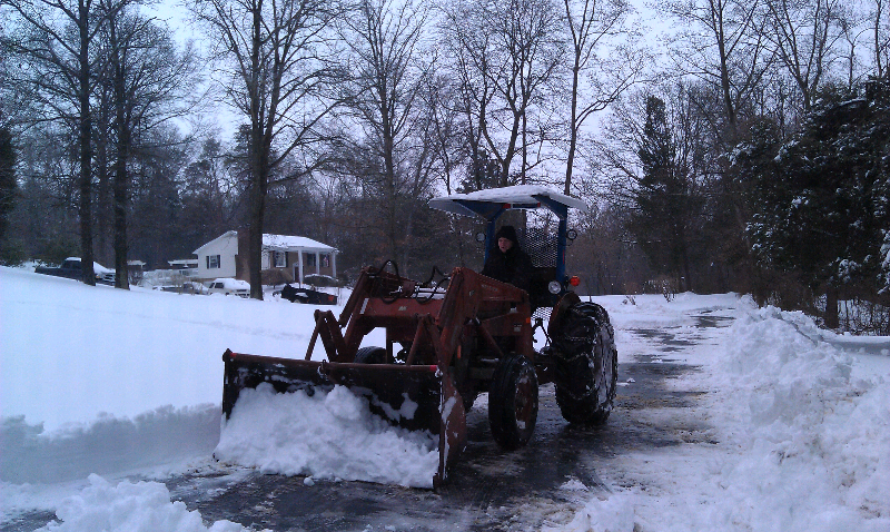

Today, cleared more snow from the driveway, we got 8" near DC.
During this, the loader started feeling spongey. I looked around, and saw the right hand loader frame arm had broke loose in its connection to the rear axle.
It's the weld (from previous user), and the wear and tear sheared the weld. So I presume it did not have enough penetration, plus add some rust. I could still use the loader, but just kept it easy on the stress and movement. The right side is now only held by the 2 front bolts on the grille frame.
I also see the need to add some small plates to reinforce the joints, to prevent bending moment stress at the joint.
That way the multiple welds will reinforce each other.
Maybe I should change the rear connection to bolted, to make it possible to remove without pulling the ROPS.
It currently welded to the ROPS connection plates.
