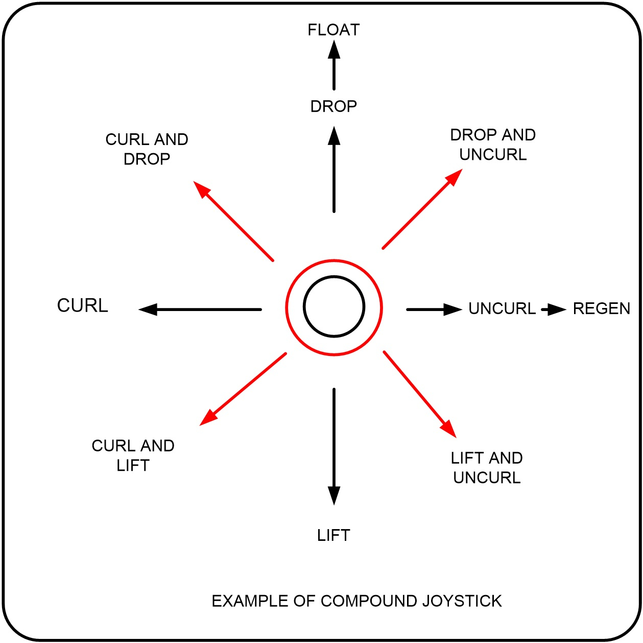

My control valve only 2 axis. Up down dump retract.
To simplify: Regen is short for regenerate. It would be a position beyond a detent in your "dump" position. You would have to exert a little extra force to overcome it (you may have it and not know it). What it does basically is to open the circuit between the ram piston sides, thus creating a loop so the oil passes freely form one side of the piston to the other. The bucket will literally fall open because there is no return to the reservoir through the valve.
I used this valve when I re-plumbed my tractor loader. It has float, regen, and power beyond features.

I think $400 is a little steep for re-sealing one cylinder. They aren't that big, and hopefully you'll get the urethane cup seals.
An internal leak will not cause an external leak unless there is extreme over-pressure - likely you'll blow a hose first.
If you have a compound joystick with debris in it, it could be the cause of your problems (you may have some or none of these functions). Some regular joystick valves will work with the red arrows also.
