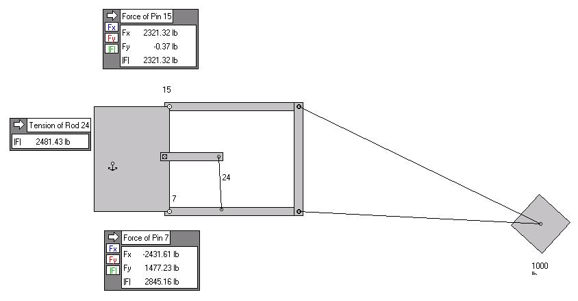

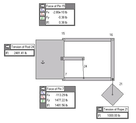

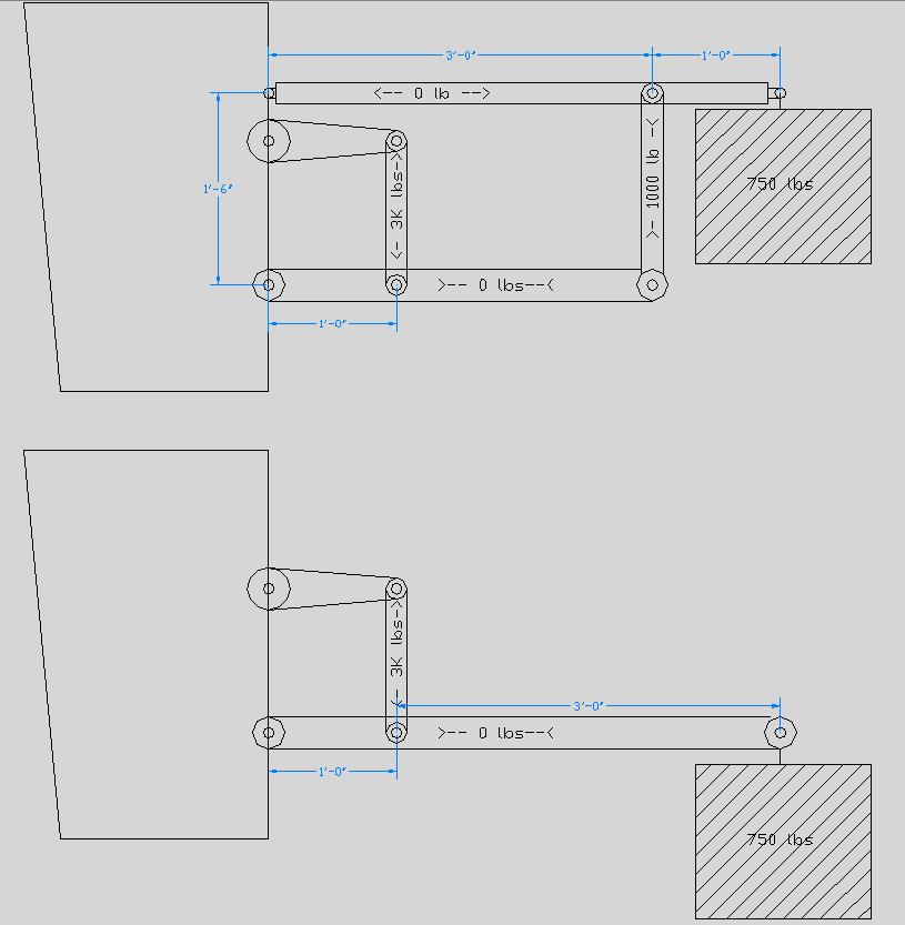

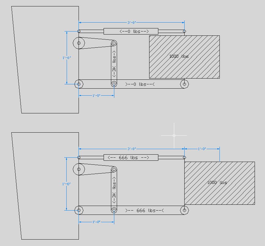

Anyway, while I was run off I did some sketches of the problem - and I stand corrected - a perfect //gram does not change the lift force as the load is extended past the ball ends. BUT this is not a practical answer. I have attached four sketches; note I have not included all of the forces (i.e. in the tractor frame) and I did not calculate a Mohrç—´ circle for each component
#1 is a "at ball ends" load
#2 is what SPYDER and LD1 are trying to explain (note that there is no change in the lift force but the top link and drag link are put in tension, compression).
#3 and #4 are what I think is a more practical application.
I don't know what manufactures use to calculate extended loads (this is what the OP was asking for) and your theory does not come close to answering the question. Maybe the extended load is limited by the tension in the top link? This would not help someone trying to calculate a lift capacity of a boom pole though.
My intention was to give the OP an answer that made sense and that could be used in a practical application.
Do you have any constructive comments on this?
