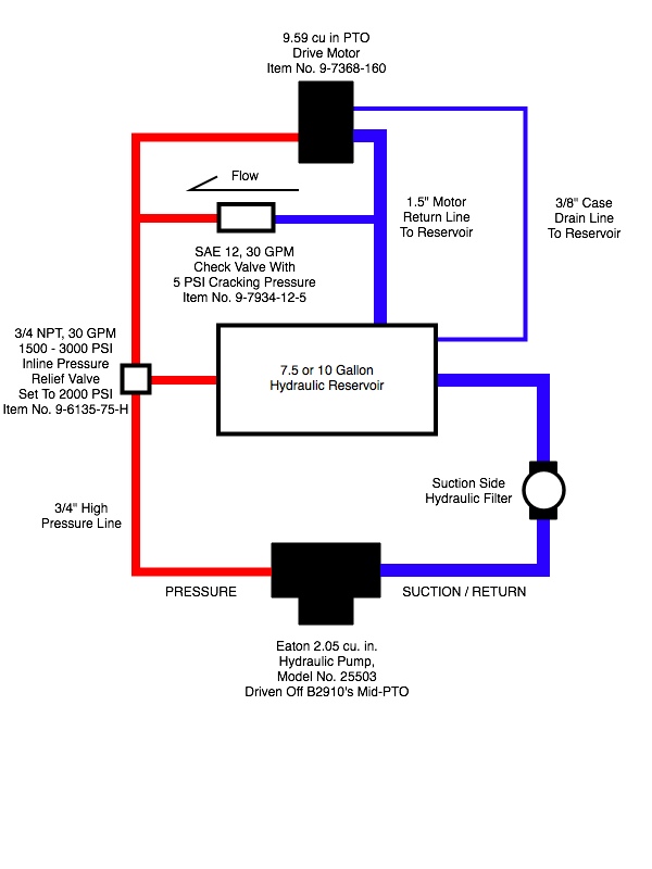

Attached is a rough diagram of the contemplated hydraulics, showing the components. The ones with "Item No." are Surplus Center items, which is where I intend to source them.
I already have the pump, reservoir, and the spin-on filter mount/element. I will use the PTO shaft from my MMM to drive the pump ... but that will require some work to fabricate a coupler to attach it to the pump, since the shafts/splines are different.

See the earlier discussion in this thread about the Eaton 25503 pump from the Kubota 4690B backhoe I'm contemplating using.
Short answer is: yes, based on the specs of the pump, and considering driving it off the mid-PTO (at a maximum of 2500 rpm) I should have enough volume (around maybe 16 to 20 gpm) and pressure (1500 to 2000 psi)
The HP developed by the hyd motor you select should be equivalent to the HP supplied to the snow blower using the PTO.
I don't understand exactly what that means ... or maybe the significance / ramifications of it aren't entirely clear to me. Using the calculators @ Surplus Center I get the following:
To get 22 gpm out of the pump @ 2500 rpm requires a pump displacement of 2.0 cu in. ... the displacement of the pump I have is 2.05 cu. in.
To get 16 gpm @ 2000 psi requires 22 hp ... the calculator does say that this is for an electric motor and to DOUBLE it for gas motors. I have a diesel so ... :rolleyes:
Since I can control the pressure developed (by using an adjustable pressure relief valve) I could do this:
22 gpm @ 1500 psi ... which would require 21 hp.
Flowing 22 gpm with a 9.59 cu. in motor would yield an 530 rpm at that flow rate ...
Going with the next size smaller PTO drive motor - 7.63 cu. in. - 22 gpm would yield 666 rpm ...
Flow will likely be somewhat less than 22 gpm ...
As far as torque is concerned:
1500 psi with 9.59 cu. in. motor would yield 2,291 in. lbs. of torque ...
1500 psi with a 7.63 cu. in. motor would yield 1,822 in. lbs. of torque
Jack the relief pressure up to 2000 psi and we get 3,054 and 2,430 in. lbs. respectively ... probably at less flow rate, since I won't have the hp to drive the pump at that high a flow rate and pressure.
Make sense ?
Thoughts ?
