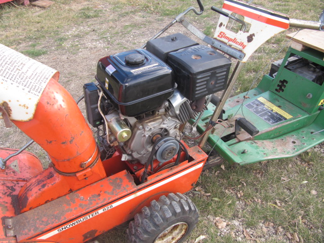

I am almost ready to take some photos of what I have done so far. The snowthrower has a 13hp elcheapo engine transplanted - as in "shoehorned" in. I acquired an R95 JD riding mower in not-running condition. It needed serious carburetor cleanup. Someone had the brainfart idea to use black silicon as a substitute gasket in a number of spots. What a mess!:eek: I got it all together last night just before dark and drove it around the yard for a few minutes to make sure I have an operable pusher for the snowthrower. I have the mower deck off - have plans for that, and the front wheels and steering stuff are coming off as well. The plan is to hitch the R95 behind the snowthrower so I can sit on it and use the handles of the ST for steering. Photos coming in the next post. I hope the snowmobile crowd isn't praying for an early snowfall cus I'm not ready for it yet!:D

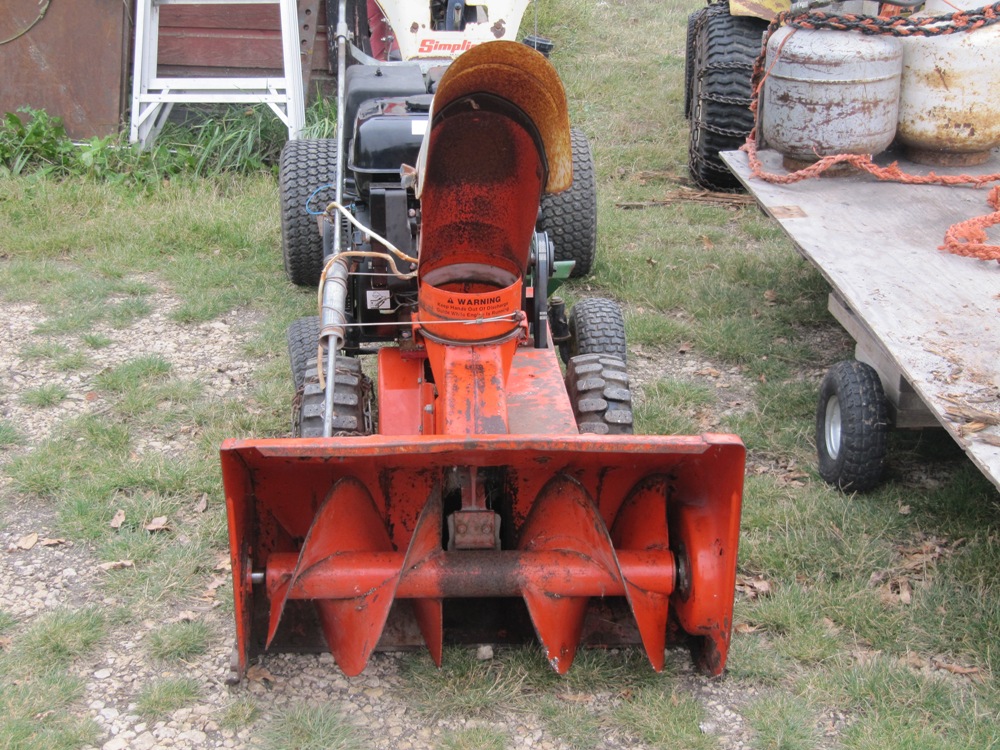

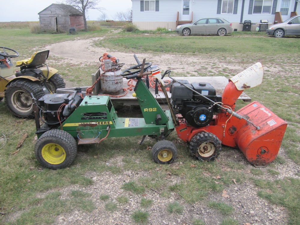

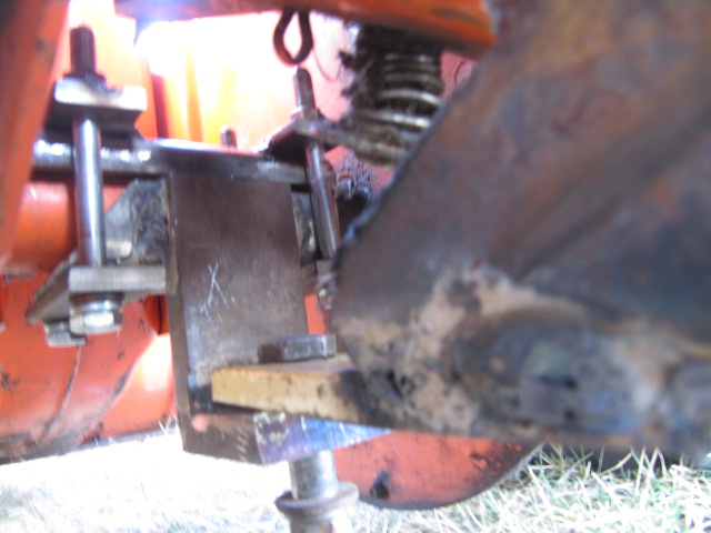

Some photos to show you where this is going.:) They rearranged themselves when I downloaded them and I can't figure out why.
#3 shows the two machines before I start hooking them up. It looks like it will be 8' long over all. The R92 (not 95 as I mistakenly posted earlier) will lose its front wheels and steering post and wheel. Yes, I will put a seat on it. The one it had found a new home on the backhoe which I am still in the process of building. #2 is the 13hp engine replacing the 8hp it used to have. #1 is the drive pulleys for the blower and drives. Both are larger than the original. I'm hoping to be able to blow snow far enough to reduce the depth of drifts we get when the next storms blow them back. #4 shows the auger. I was surprised how heavy that is. It fells like the flighting is welded to solid bar rather than a hollow pipe. That's what makes the machine as front heavy as it is. To overhaul the blower I had to replace the worn out bushings at the auger ends with bearings. That proved easier to do than I had hoped and I expect everything else will wear out long before those bearings.:laughing:

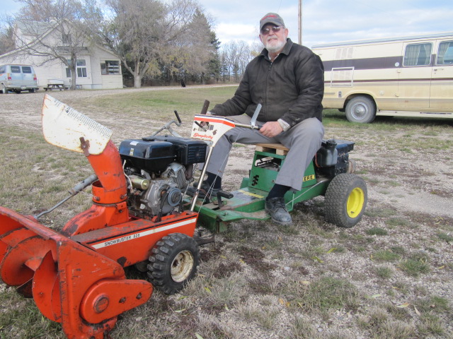

I was able to get this project far enough along to beat mother nature. I have the "Hot Rod Snowblower Ride-on" functional at last and although we've had an inch of snow in the last weeks, it didn't stay. There are details to finish it up but they are minor in nature and can wait for "inspiration", as in a bright idea that will be the perfect fit for for the need. Some photos:
The first photo is meant to show the bracket I welded up to serve as the hitch point on the blower. It consists of a short piece of 2"x1/4" square tubing slit lengthwise. The inside diameter just accommodates the outside diameter of the DOM tubing the drive axle of the blower runs in. The bracket clamped down firmly on the DOM tubing and the tongue shown in the second photo is pinned to it. I may have to lengthen that tongue a little because the pusher seems a bit too close. Easily done if needed. The third photo shows the belt and pulley with out the guard. With the mods I did the guard will need to be modified as well since right now it won't fit! For now, I'm sitting on a plywood seat. I have the material for a cushion; just haven't taken the time to build it yet. The fourth photo is of me with no snow to blow. Yet...

I like it .Can you find two gears that are about the same speed ? Now a cab ?
   / Convert walk behind snow-thrower into a "ride on"?
#28
Yes, the slow gear on the blower (it has a two speed tranny) will work well with the first gear of the R92. On dry ground the blower can easily pull the whole machine with out help. On snow I expect it would mostly spin. As for the cab, well, that may be a project for next summer.
