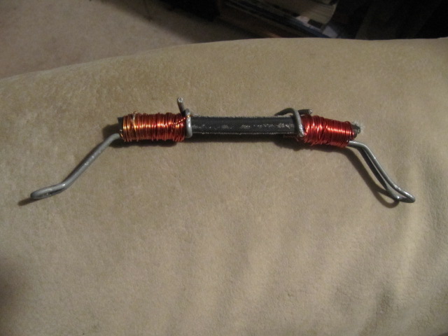

I've had some time to think about how to provide more traction. The steel rings you mention have me thinking maybe I could use cable or light chain on each side of the tire and take some used up pieces of "V" belt long enough to drape across the tire tread and fix the ends onto the cable or chain. If chain, tying into the links would also keep the spacing even and prevent bunching up of the crossovers. Thoughts?
OK, I did a little experimenting in the shop today and here is a prototype of what I have in mind. This was time consuming but I'm guessing once I have made a few they will come faster. Some of you will recognize the bent pieces of wire from telephone and telegraph pole days. When they were replaced by underground cables, land owners were allowed to roll up the old stuff if they wanted it. My Dad rolled up miles of the stuff and I have most of it. Comes in handy for projects like this one. The finer wire is copper, I have lots of that as well - salvaged from fiberglass whip antennae. Truckers use them for their CB radios but they keep whacking them against low branches and in ice storms they get all whippy and soon break. That's when I get 'em and "re-purpose" 'em!
The design I will eventually settle on will undergo some modifications but the basic are there. Thoughts?
