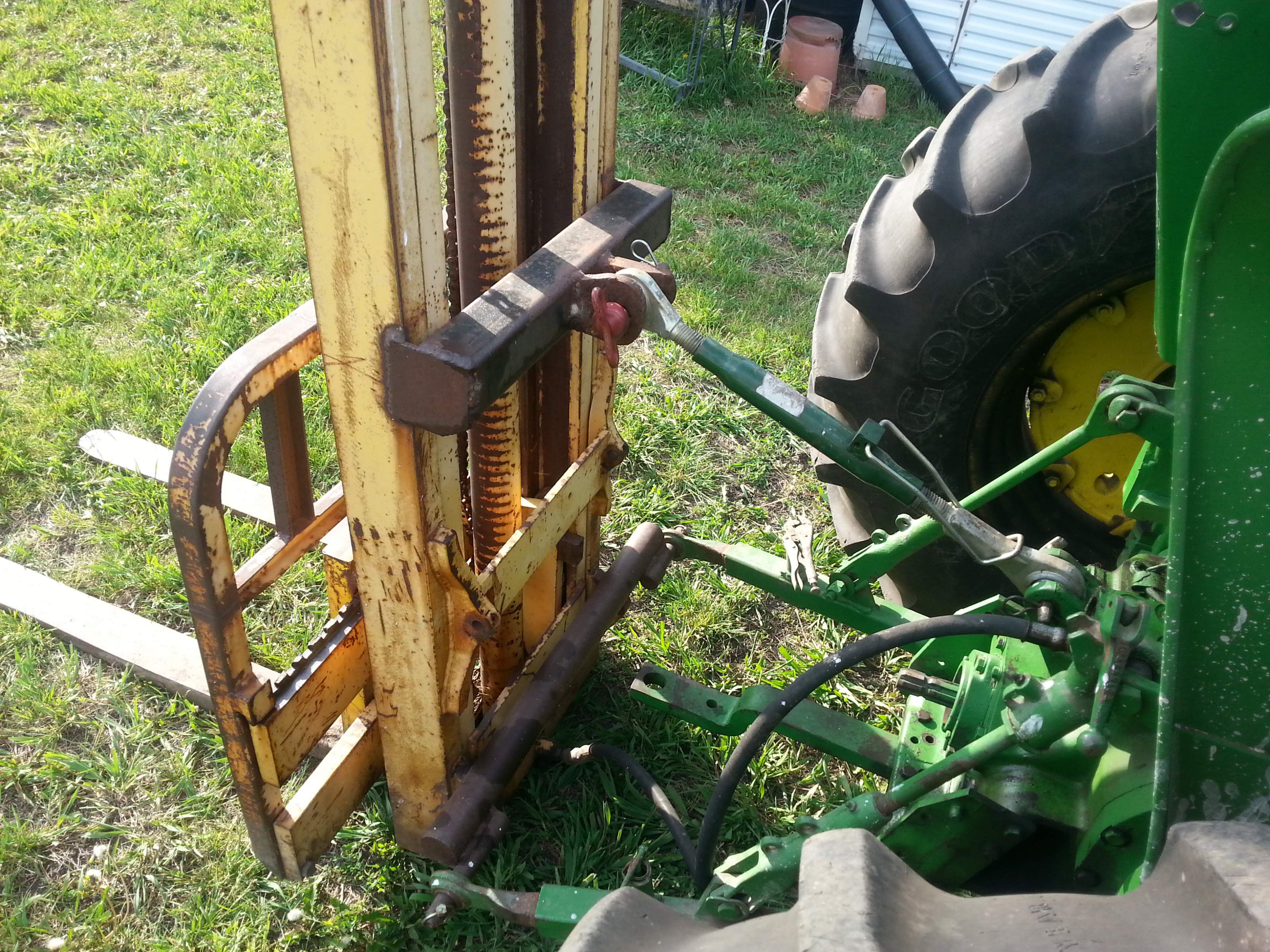

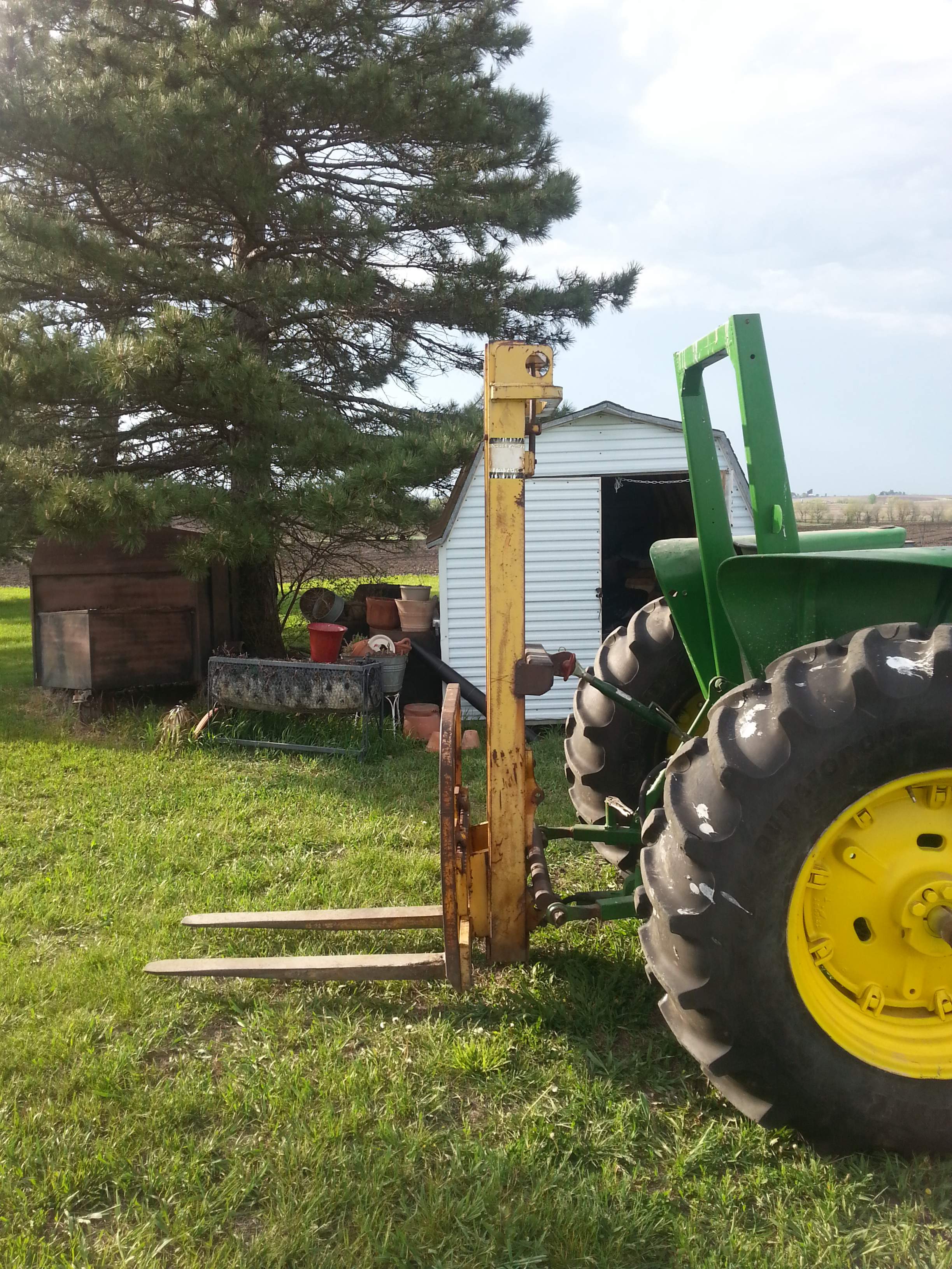

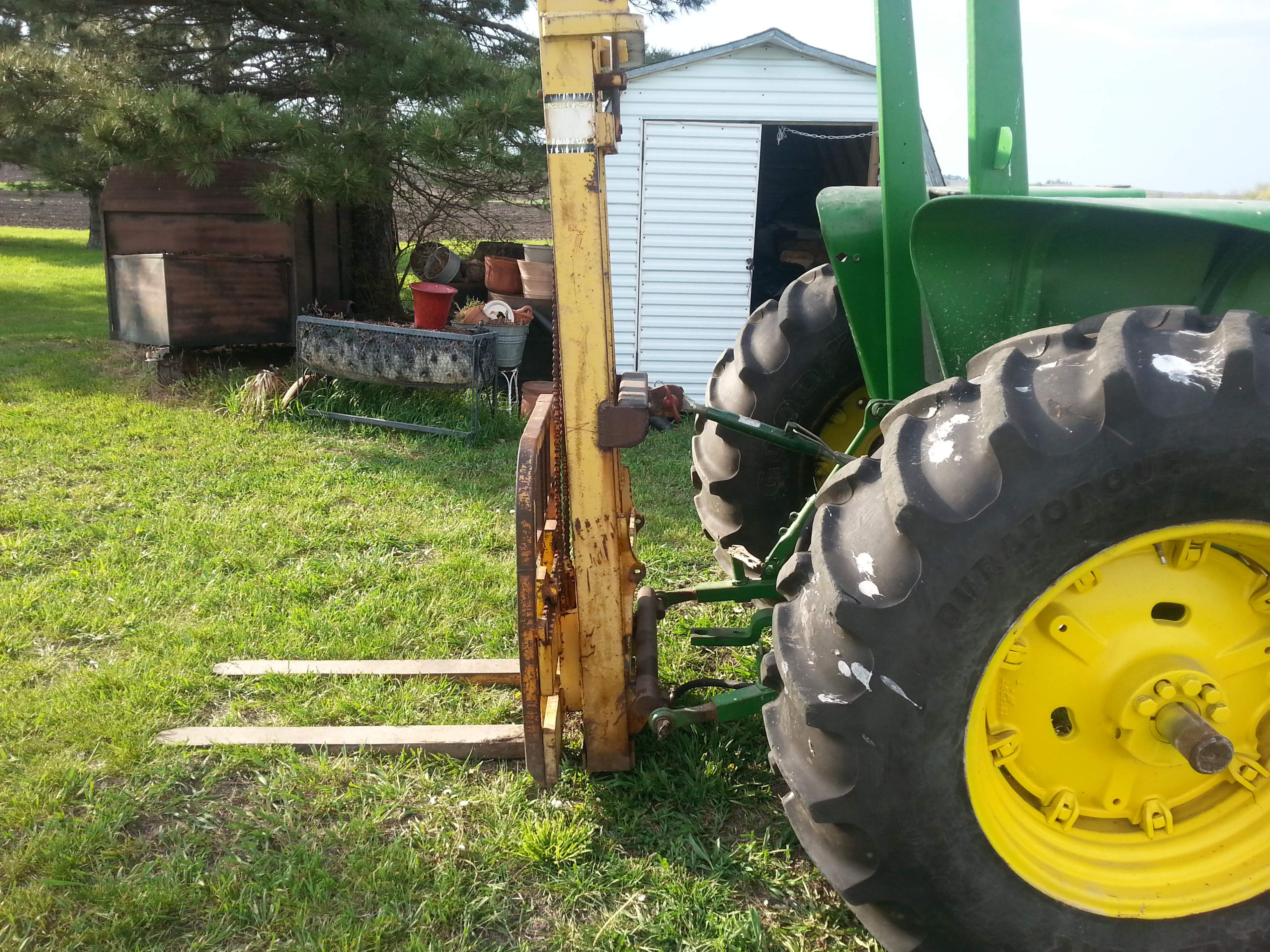

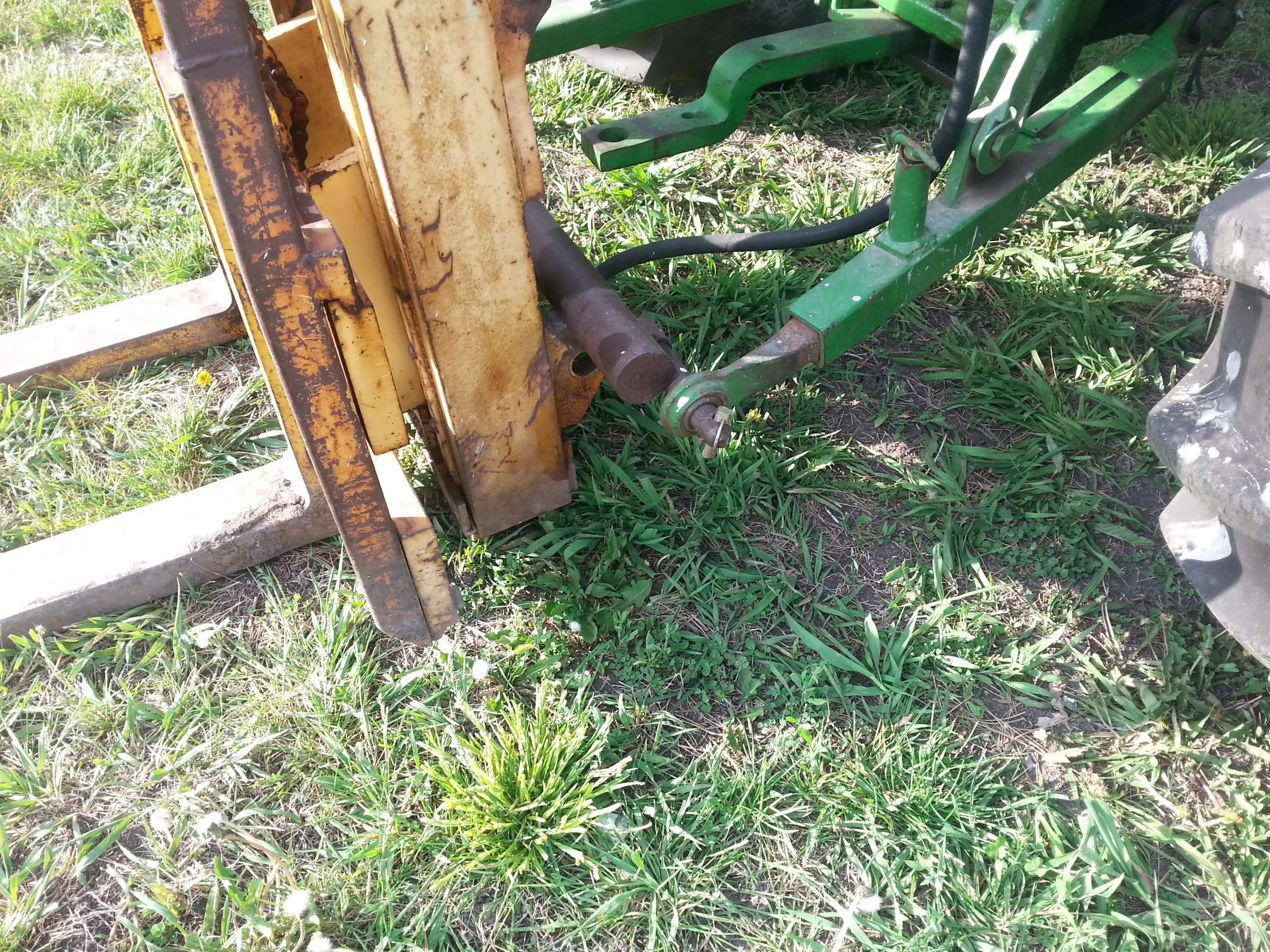

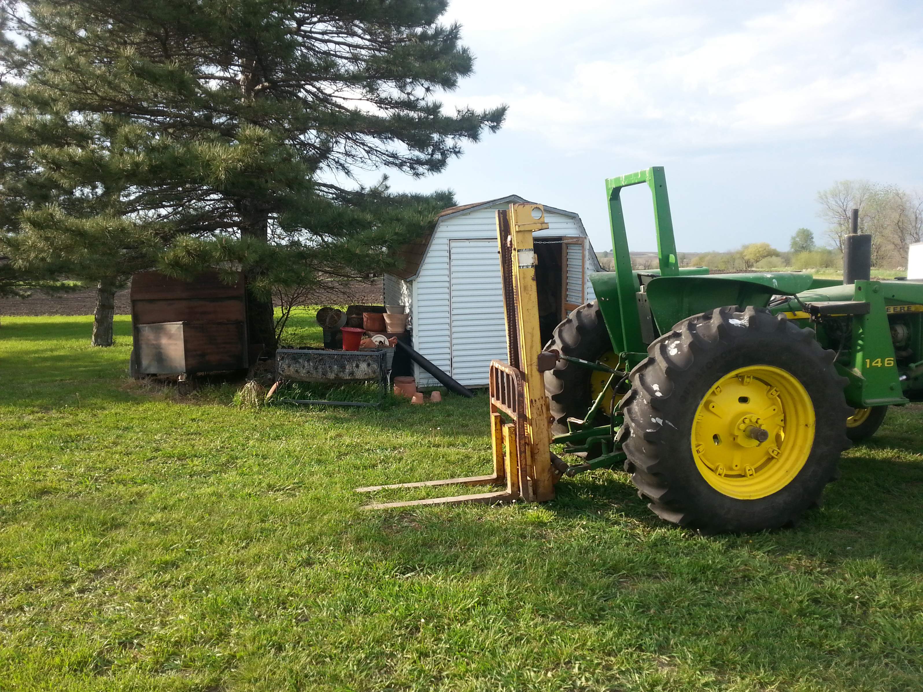

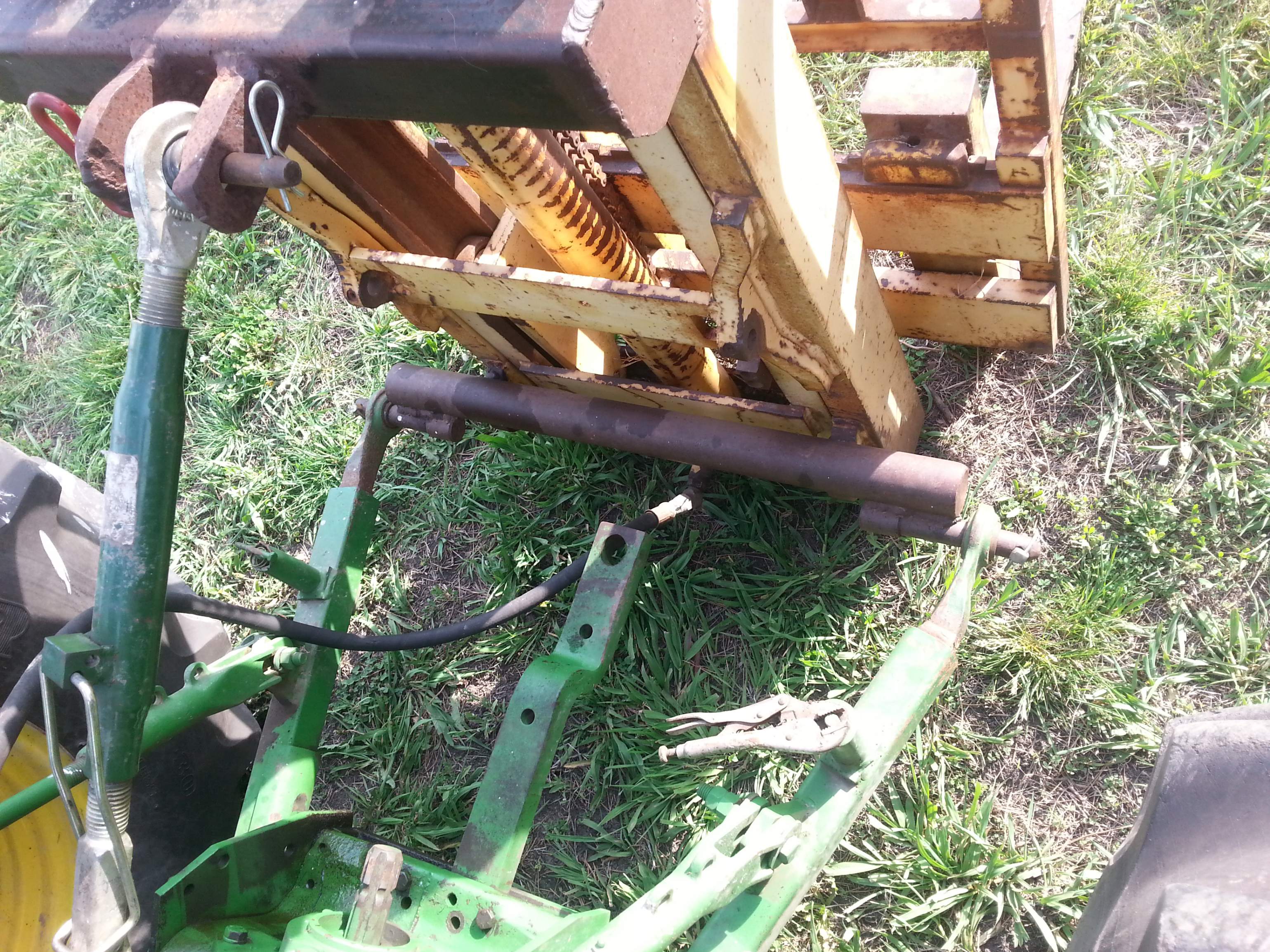

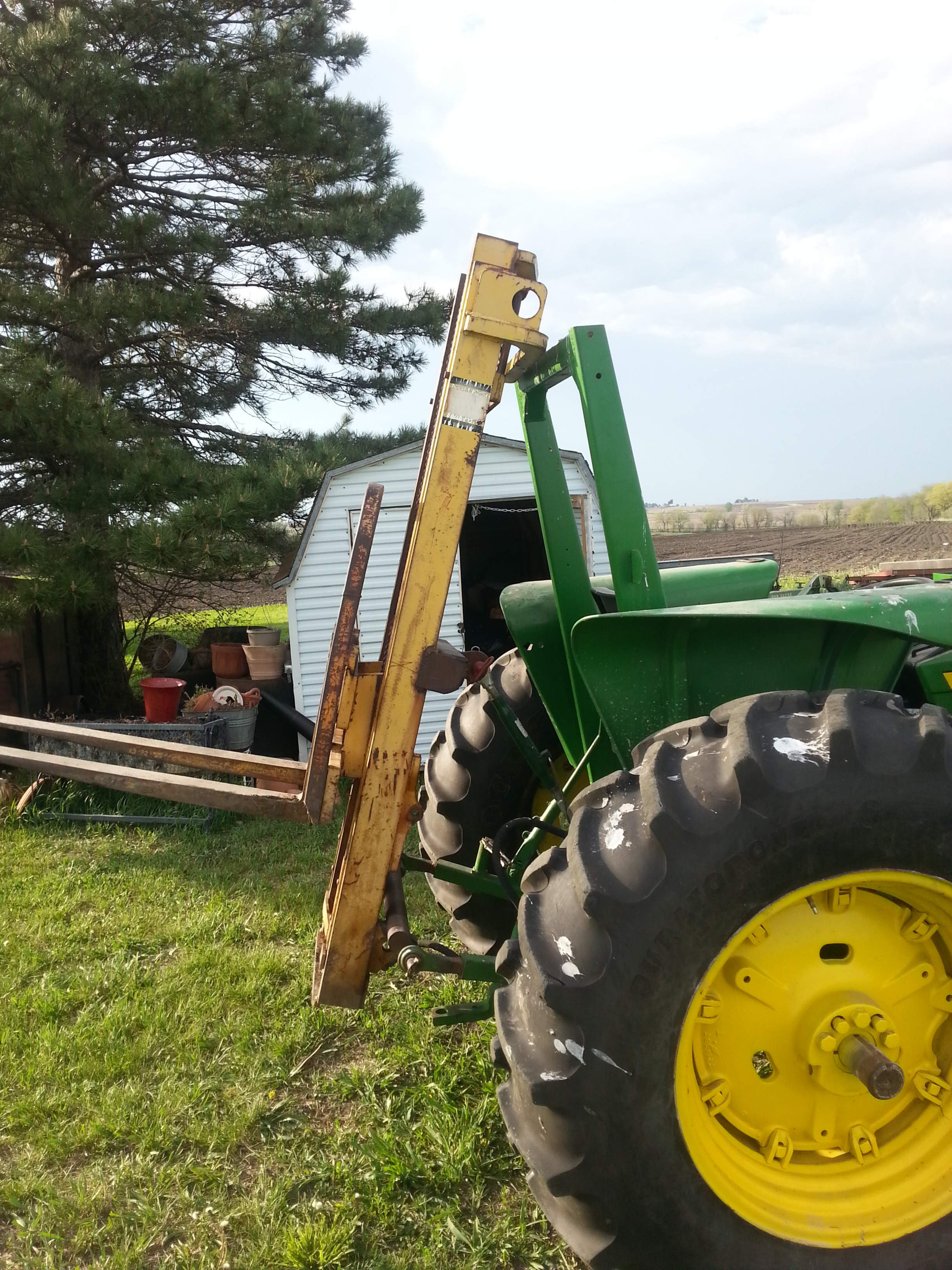

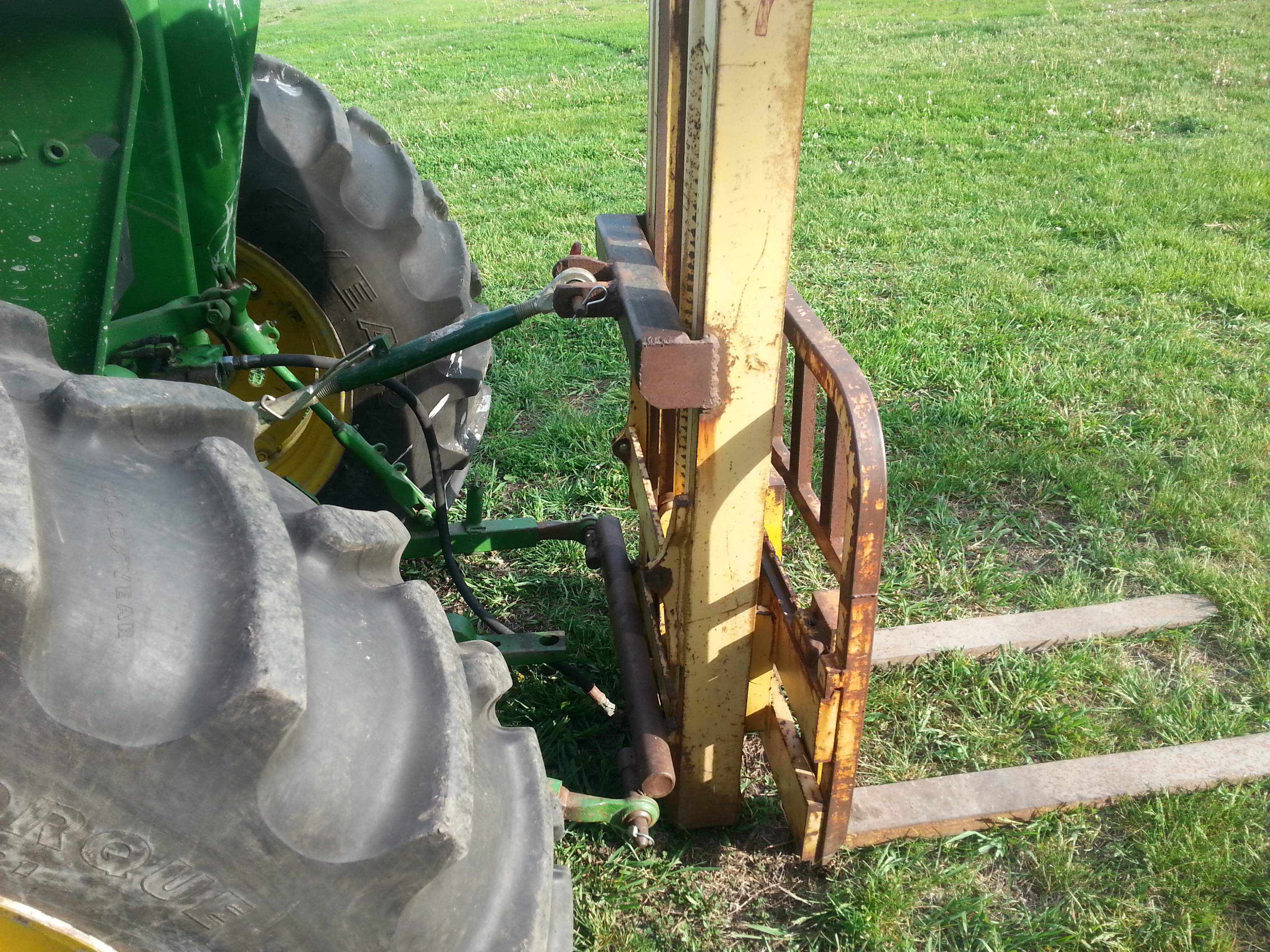

Better late than never on the pictures, I guess. I'll be using this lift to hopefully move (safely and successfully) a 1000lb gun safe within the next month.
