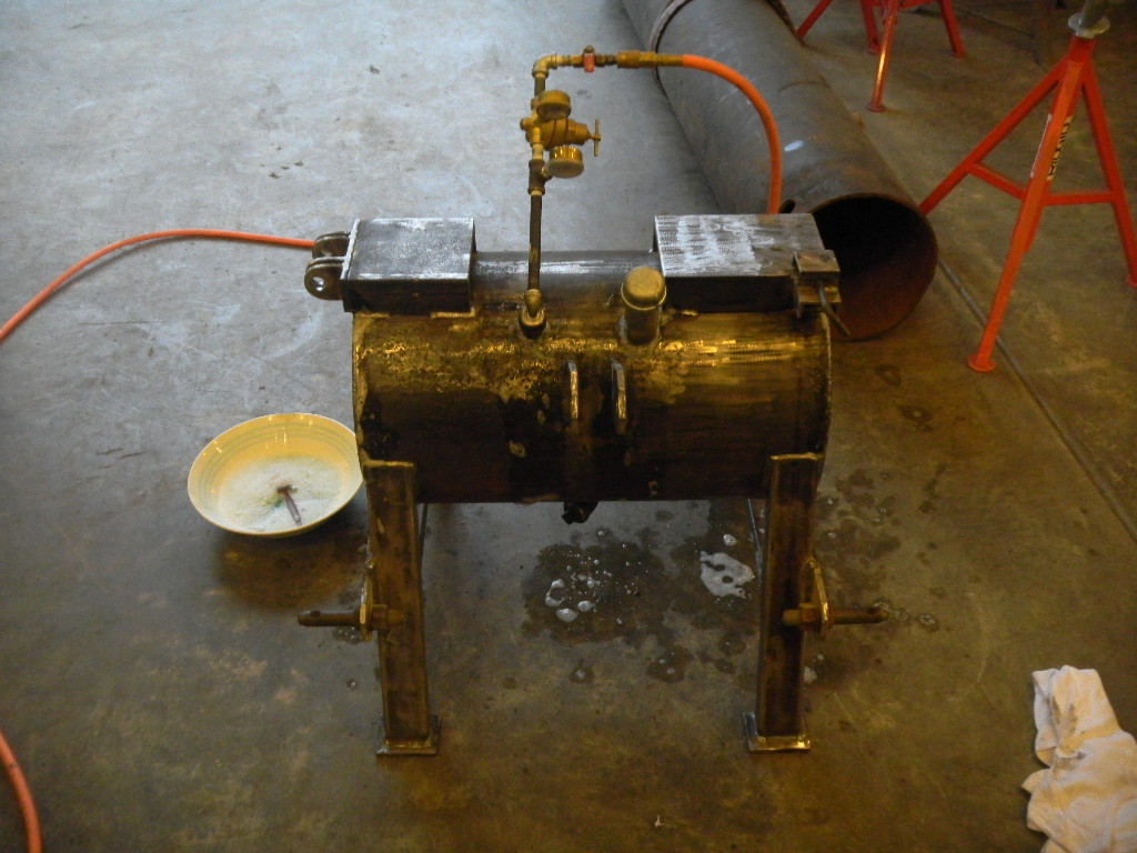

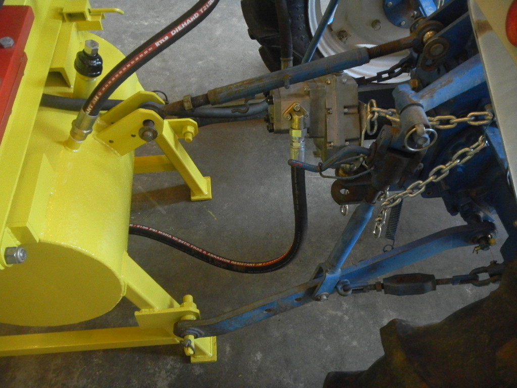

Why not buy a PTO pump, and build a hydraulic oil reservoir?
   / Convert "Walkie forklift" to 3-point attachment (Lifts 11 feet high) #24
That would be a good solution.... downsides are having to hook up a pump to the PTO and running hoses to the tractor each time you wanted to use it VS just hooking up two hoses. And it ads to the cost of the project significantly.
Plus side is you don't kill your tractor. :)
