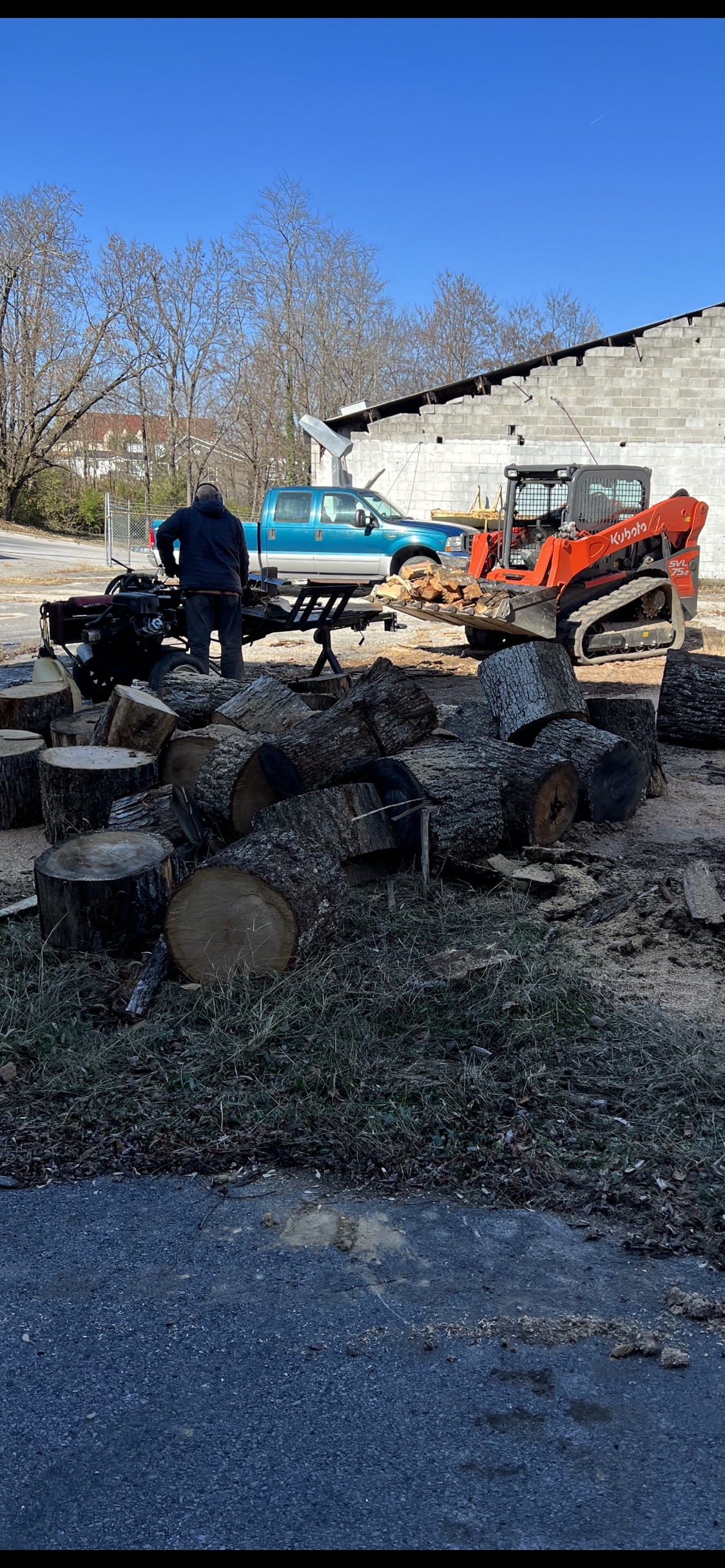

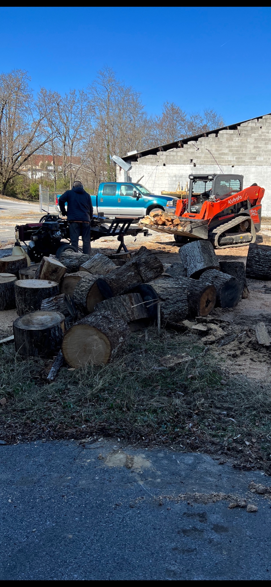

Another point I just thought of- If the splitter is tractor mounted it would be hard to be lazy and pick up big pieces to put on the splitter, or to collect the split wood in the bucket to move to the stack/pile.
   / Convert wood splitter to pto power #13
I like to use my skid steer to move wood while the wood splitter does it’s thing. I also move logs to saw them while a helper splits wood. Having the wood splitter powered off the only tractor you have would really slow down the operation.
IF, you work smarter instead of harder and cut over a wagon, trailer or even a table,
you don't need a tractor picking up rounds while you are splitting!
It's just so much easier/faster and saves picking rounds up off the ground to split.
SR

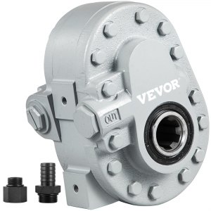

This would do it with flow to spare.
Harbor Freight 6.5 HP motor is half the price....
   / Convert wood splitter to pto power #19
....and double the noise...
We had a sawmill made of an old fodder beet cutter, our neighbour had it running off the threshing pulley on his first tractor. We welded a car hub with rubber tire against the belt and bolted a PTO stub between wheel nuts and rim.
With the tractor in ground speed PTO and the range lever in neutral, this gave about 800rpm on the pto at 1200 engine RPM. The saw itself was the only thing noisy, not an engine.
