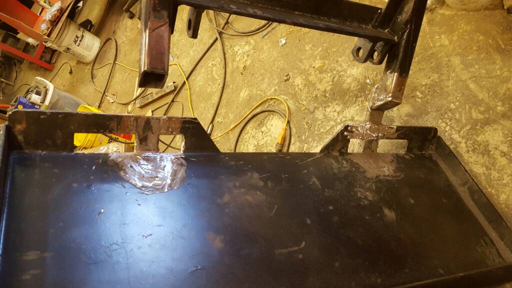

Ditto, your braces are going to interfere with the QA plate., you are going to have to cut them off and move them unless there are reliefs in the tractors mounting hardware?

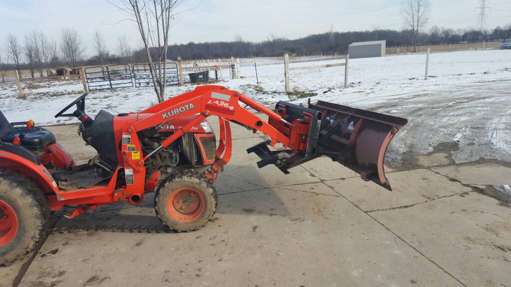

Well, you guys who said there would be interference were right. Although the plow set up work ok on my soninlaw's LS, it didn't fit the ssqa I put on my Kubota. The fel arms are spaced more narrowly on my Kubota B2620, so there is interference with mine. I'm going to modify the plow set up. Probably put a junk of 2" by 1/2" flat steel bar about 8" long on the bottom of the plate and then weld it to the 2" tube and cut out a section of the tube.
I'll post back when I get it reworked.

Working on it. Cut the 2x2 tube back. Welded in a 2" x 5/8" bar under the the plate and bridged to the 2x2. Got one done. I'll weld up the other side tomorrow.
It was a royal pain tho cut that darn tube off. uploadfromtaptalk1452031145650.jpg

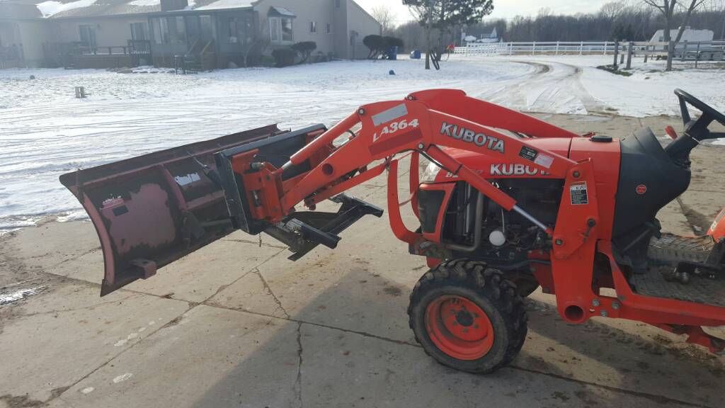

Ok. I got the other side done and hooked it up to my new quick attach on my Kubota B2620.
I have to paint the revised area but I'm going to declare victory on this.
