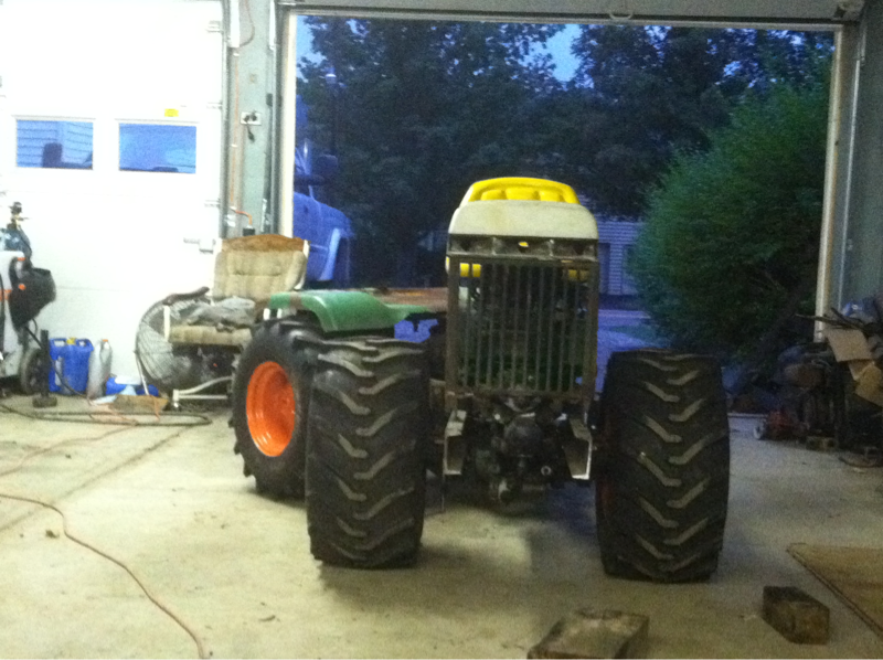

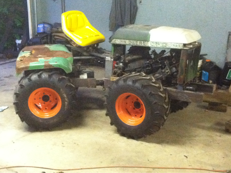

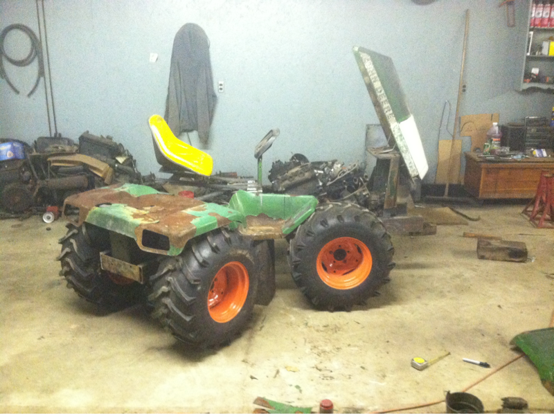

Yea i like a lil challange. I dont know if u can see it but in the backround in one of them pics is a 4wd articulating tractor i built a complete custom frame for and used jd 318 transaxles. Hyd steering. It aint done yet. But im always building something, or repairing farm equipment, or farming if i aint at work.
Now that's cool!:thumbsup: Not sure what you can do with it... put a loader on it maybe?

I cant take all the credit for that lil articulating deere, i found pics from one on the net a guy made and i jus built from his pics make up my measurements as i went. I was planning on putting a 3cylinder diesel in with a small turbo i have but had to put that engine in my 330 deere garden tractor cause it blowed up, and i dnt like push mowing lol. Im jus goin put a 3 point and maybe lil blade on it and play with it i got big farm tractors and a 450 dozer and kubota trackhoe to do real wrk
