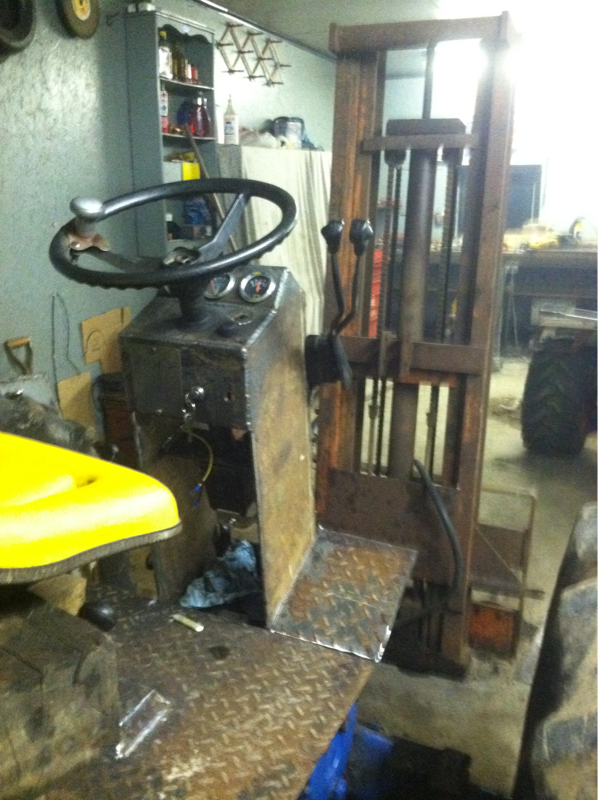

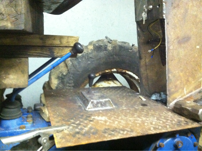

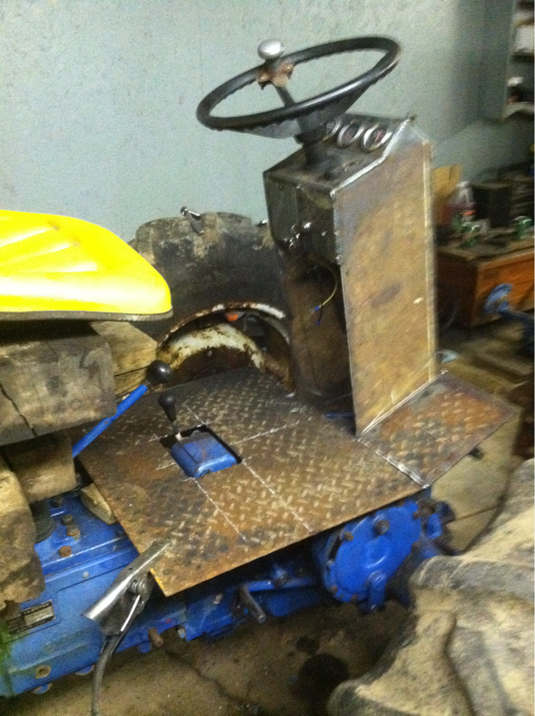

#68
   / Converting a ford 1700 into forklift
#69
Well guys been busy with xmas and working on another tractor for a guy. But had some time tonight to mess around. I got the seat mounted up. I took quick route and made it simple and solid. Its non adjustable. I made it to fit me comfortable im bout 6' or tad under that. The seat is jus a little thing but i think it will work. I wasnt to concerned with suspension, dont plan riding it all day real fast.
