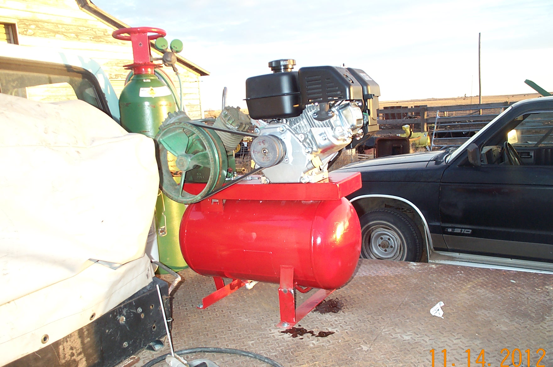

I would like to convert this compressor to gas powered! I have a Briggs 5hp side shaft engine. The compressor is a Curtis and says to run at 350 rpm as a min. And is a 35 gallon tank. What all would I need to do this and is it worth the effort? I have no money in tank or motor, so I don't mind spending a little to make it work! Thanks! And any info will be greatly appreciated!

First you need to have a mount that will accept the gas engine. You will need to do the math to determine the hp needed and what size sheaves to drive the compressor at the optimum rpm while the engine runs at its optimum rpm.
The sheave on the compressor should stay the same and the engine sheave should be sized to match the needed rpms.

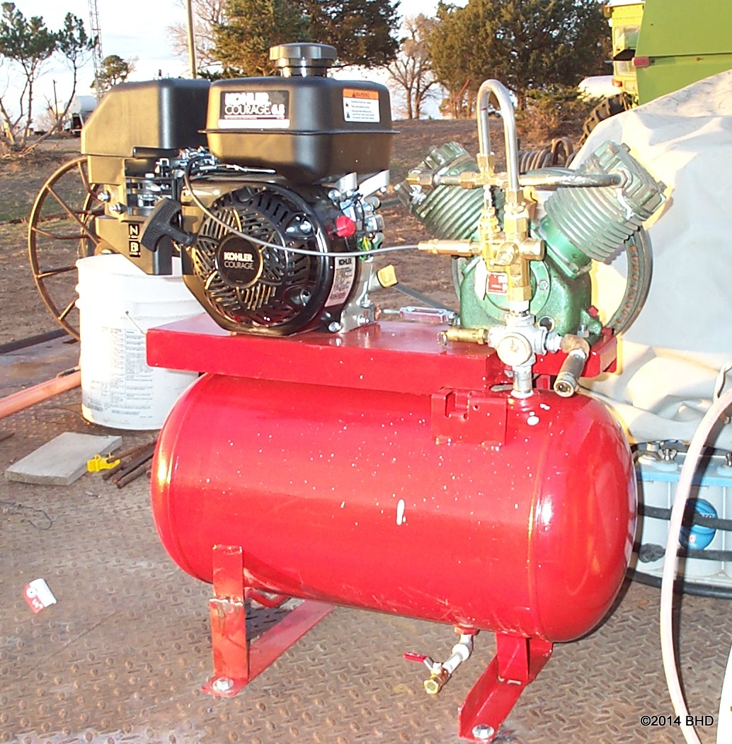

here is the compressor I set up, had one compressor that the tank rotted out, and one that the pump went to pieces, to this is what I come up with, after this picture was taken I added a centrifugal clutch that I could grease, it helps the engine start easer, and I also added the throttle on it so it idles down when up to pressure,

but the unloader valve just dumps the air instead of feeding it to the tank, and with the centrifugal clutch and the throttle control the pump stops or nearly stops when filled,

Here is a KISS method for the unloader problem.
It works because I did it with a rig that I set up that was electric.
I placed a check valve between the compressor and the cut off switch.
That way the tank is always under pressure even with no pressure back to the compressor.
Next I caused a slow leak between the check valve and compressor. It was a very tiny hole, just enough to bleed off the remaining pressure but not large enough to slow down the tank fill.*
