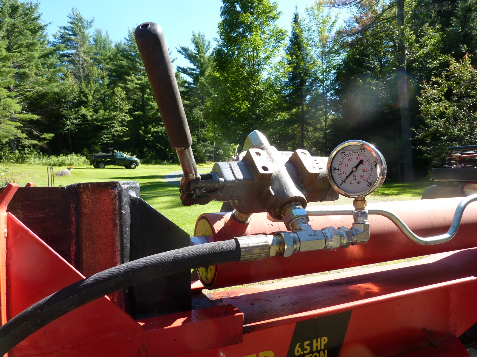

This is interesting to think about. I have the same splitter. The max pressure I get from my motor/pump is 3000 psi. And with the 4" cylinder that makes about 19 tons of splitting force that I actually get. I mounted a pressure gauge so I could watch out of curiosity how much it really took to split wood. To my shock and amazement most of the time the guage doesn't even register during a split and I hardly ever see the gauge go over 1000 psi while splitting.Thats only about 6 tons on really tough stuff. So my gas motor is loafing most of the time and just barely starting to work on tough stuff.
I agree with LD1 that you will very hard pressed to get away with a 120 VAC electric motor. And like LD1 says the problem with the electric motor is that it will sacrifice itself by drawing to much currant and burn up when the load gets to tough. A gas motor will just stall out.
So how do you protect the electric motor ? You should have a thermal cutout for protection of course. But you don't want it tripping very often. The motor will slowly die from a thousand cuts.
What I would do, for what ever electric motor I chose, would be to get an adjustable pressure relief valve and put it in the hydraulic pump circuit. I would then put an amp meter on the motor. With the ram extended against the stop and the relief valve at its lowest setting I would then start adjusting the bypass pressure upwards. The currant will increase. I would set the relief valve to where the motor is running at max rated currant. That way the motor is really protected. It will not try to do more than it is designed for. The relief valve will start to bypass when the load is at the max the motor can handle.
