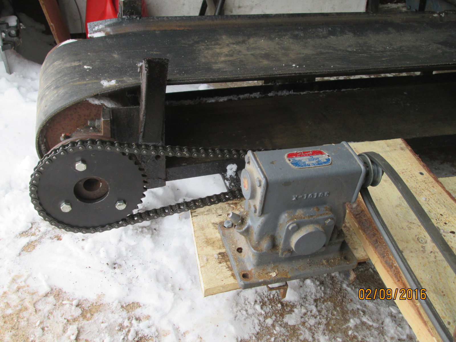

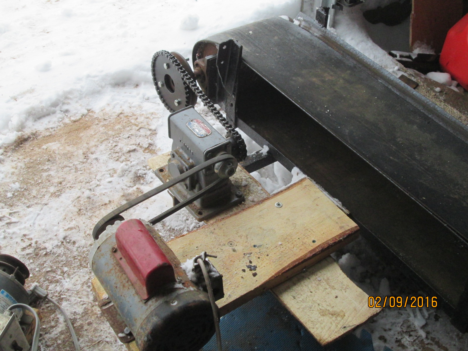

Got a chance to look at my conveyor. 3/4hp@1725rpm electric motor. belt reduction , motor vee pulley=2in dia, gearbox input 3.5in dia vee pulley. Gearbox output is a 18 tooth #40 drive sprocket, conveyor shaft is a 23tooth #40 sprocket. Unfortunatly I wasnt able to get the gear ratio of the gear box as it had no tag and it was locked down so i couldnt turn by hand to do a count. Gear box is a Boston Gear, 300 series. The conveyor is 14ft by 12, pretty close in size to the one you are working with. This conveyor came off a saw mill to off bear slab wood. so it should be about the right speed for firewood, or at least I hope it is because thats what I bought it for.
tried to upload pic of conveyor drive setup, but the forum isnt taking my pic. Might try again after while
Tried a coule more times and it finally loaded

So what I ended with is this set up.
3/4 hp motor 3" pulley belt to a 2 " pulley on the 75:1 ratio reducer . Out the reducer on to a 17 tooth #40 chain to a 40 tooth bolted to the roller. I bolted it as I bought the wrong size weld on hub.
Rpm on the belt is 2rpms for 1 min 10 seconds. Might try it out to see how it works before I start to change the pulley size.
Thanks for all the pointers and ideas.
Changed it up Switched to a 1/4 hp 1725 I swapped the big gear off the roller and the smaller gear off the reducer and still ended up with a 2 rpm belt speed. Then I changed the wiring on the motor to spin CCW so I could get rid of some of the wood Now the motor and reducer are both on one compact board . Just need to get a bucket to cover the motor for outside storage.
