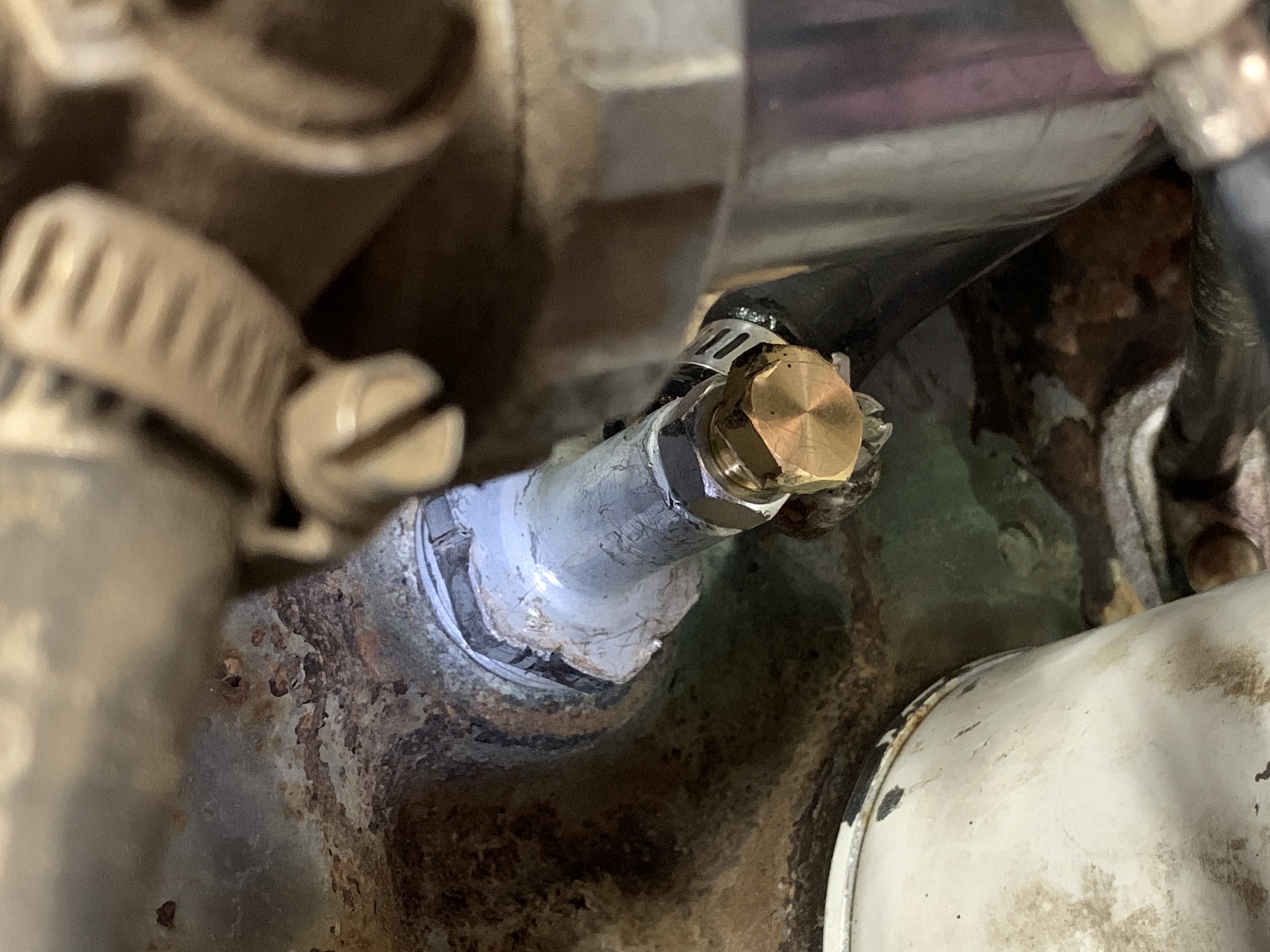

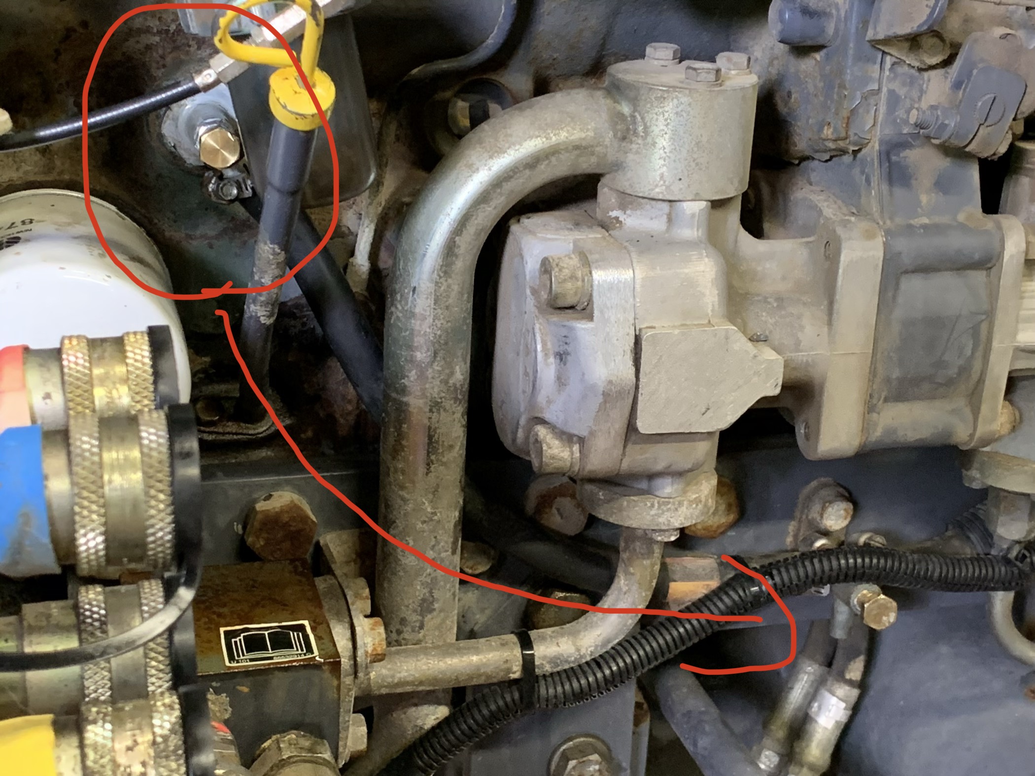

This is what I ended up using to replace mine, got it from the Amazonians
So far so good but I havent really used the tractor yet since the install
The stock setup leaked while just sitting in the garage and this one hasnt yet, time will tell
