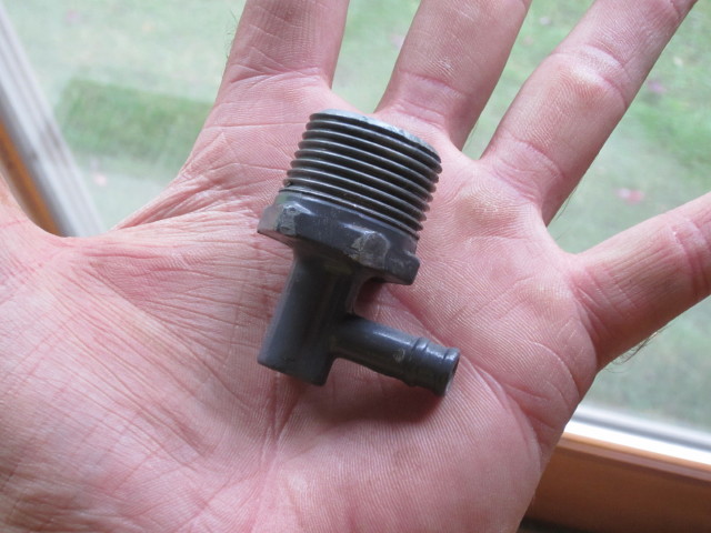

I have a coolant leak on my TC33D. I attached a picture so you can identify where the leak is. It is on the right side of the engine just to the right of my oil filter. I need to know if this plug has threads or is pressed into the engine block? It is in line with the freeze plugs. Can this plug be tighten or should I just use some stop leak?

Based on its shape, hex, I'd guess it has threads. The picture at Messicks shows threads on it. $32.60.
/ Coolant leak question TC33D #3
It is a common problem. The hose connector is made from zinc and will react with iron. I replaced mine when the tractor was nearly new with brass and it has yet to leak after these years. Pictures will follow very soon.
/ Coolant leak question TC33D #4
Here is what it looks like and the tool to get it out with. I milled a slot into a heavy impact socket to get it out in one piece. You can just cut the bib part off and use a 1-1/16 deep 6 point socket too.

/ Coolant leak question TC33D #11
Hi there everyone, I know this is an older thread however I'm hoping some of you gents are still here.
I just changed the valve with a new New Holland one. The one that was on my tractor looks different, it has a open close valve on it (as did the one I took off). I'm wondering if anyone else has seen one like I was sent?
My problem is that the new one is leaking from the threads. I talked to a buddy that used to be a New Holland mechanic and he told me it's a drain and I should close it unless draining... that doesn't seem right as it appears that this line feeds into the drain open close valve. I want to make sure that if i close it i'm not restricting the flow of coolant.

Replaced the plug a few weeks ago and leak has stopped but still concerned. The plug was eat up pretty badly and the threads in the block were corroded and eat up. The new one didn't want to install and I couldn't even get the old one to screw back in. Spent quite a bit of time with a couple tools working on the threads and finally got the new one started but it only went a couple rounds before really, really tightening up.

OEM replacement. Problem was that not only had corrosion eaten away at the old part, it had eaten away at the threads in the block where the leak was.

Way back when my TC33D was near new I replaced the OEM zinc fitting and installed a brass unit I made. Zinc and iron don't get along very well.

This is what I ended up using to replace mine, got it from the Amazonians
So far so good but I havent really used the tractor yet since the install
The stock setup leaked while just sitting in the garage and this one hasnt yet, time will tell
