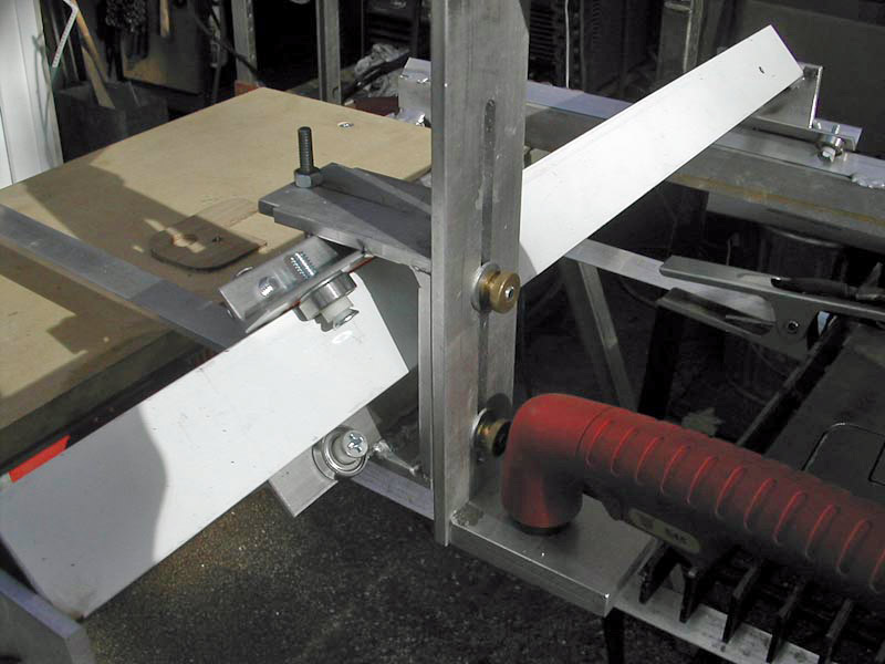

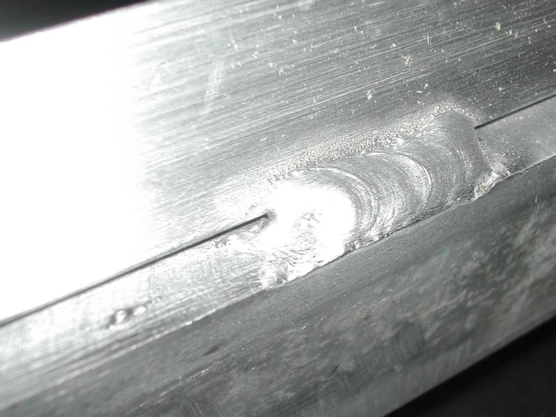

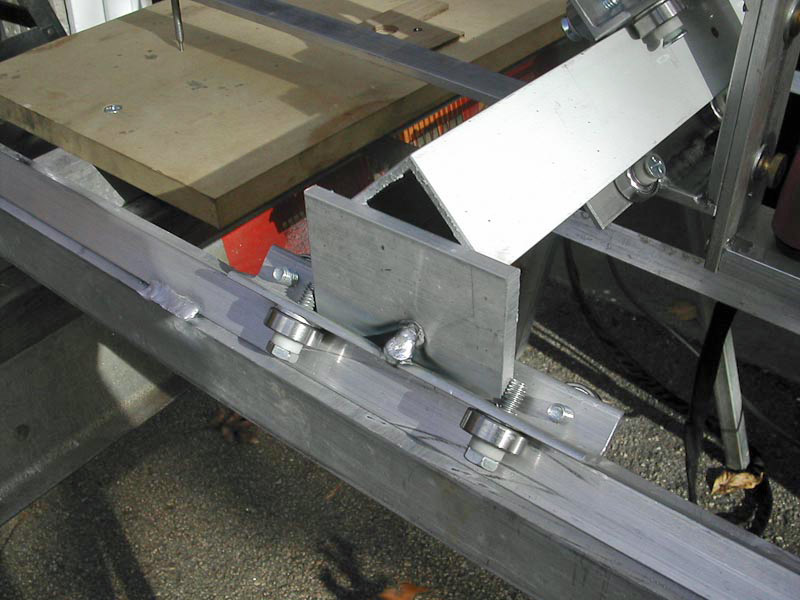

This is what I made . I just make a template out of plywood and the syltus follows the shape and the parts come out very clean. It is great for smaller parts and multiple pieces.
Did you make the X Y table/holder thing? Do you have plans?
   / Copying Table? #12
I made the whole thing from scratch. The size was based on what I had for materials so there are no plans. It was my first welding project for the spool gun.
The carriers were made from the bearings I got from in-line skate wheels. Surplus Center has them for 2.99 a pair which is .50 cents for each bearing.
