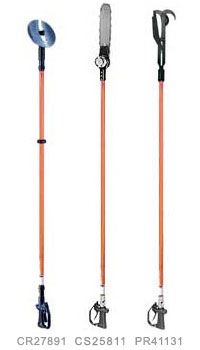

Sounds like you are approaching the benefits of the circular blade on a pole saw, like these hydraulic saws. That's all I see the power line trimming crews use from the bucket.
I wonder why there aren't readily available electric or gas versions.
