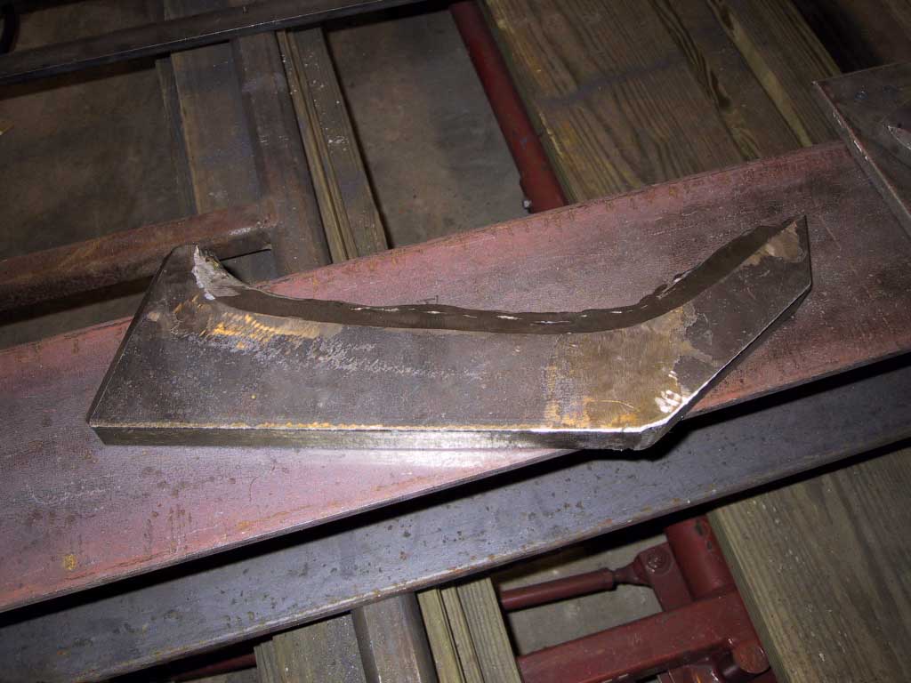

   / Cordless welder??? #36
</font><font color="blue" class="small">( Forgive my ignorance, but isn't a MIG welder more of a sheetmetal and thin metals type of welder? Will it put a strong weld on something that a tractor has busted or hold together a metal building?
)</font>
Depends on who's doing the welding I guess ..... I've joined 1" steel plate for the backhoe ripper tooth I built (image attached) using my MIG which is only rated 1/4" single pass MIG and 1/2" with flux-core using multi-pass.
I've used it for the past week or so on some rather larger tree roots and it hasn't broke in half yet (knock on wood) /forums/images/graemlins/grin.gif It definitely has been under some serious stress.

rswyan, I looked at your building the ripper post and realized that you welded the end together and then ground it smooth, that is amazing. What MIG do you have?
   / Cordless welder??? #38
Don,
Thanks. It's a Lincoln PowerMIG 215.
