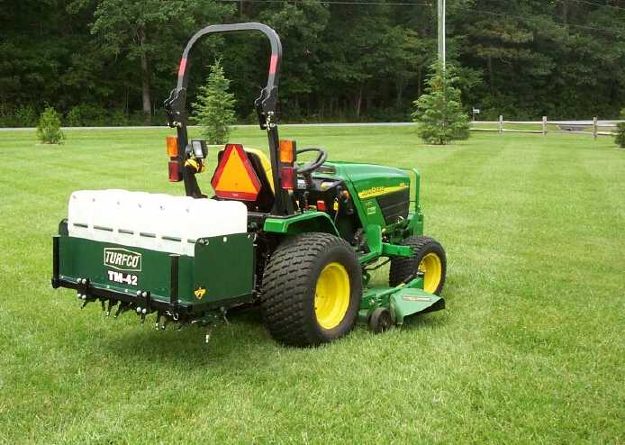

Slippy: I have owned a Turfco TM42 for almost 3 years. The spoon wheels are in pairs and can turn at independent speeds in very slight turns, but you need to lift for turnarounds. I aerate 12-15 acres of turf in my neighborhood every year with it. Here's a pic of it behind my 4110. I love every feature of the rig--repalceable tines, adjustable weight by liquid fill, greasable bronze bearings--all pro stuff. The frame is 2" square tubing. You get used to lifting and turning and with a tractor with quick hydraulics you get a good rhythm going. This unit takes big, deep cores in one of the tightest patterns in this price range. Good luck

As for turning restrictions its really not a big deal. You will most likely damage you lawn from your front wheels first before you tear it with the aerator. Gradual turns are not a problem, really sharp turns can be from two different means.
